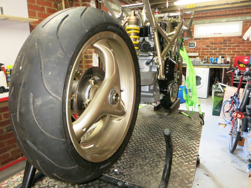

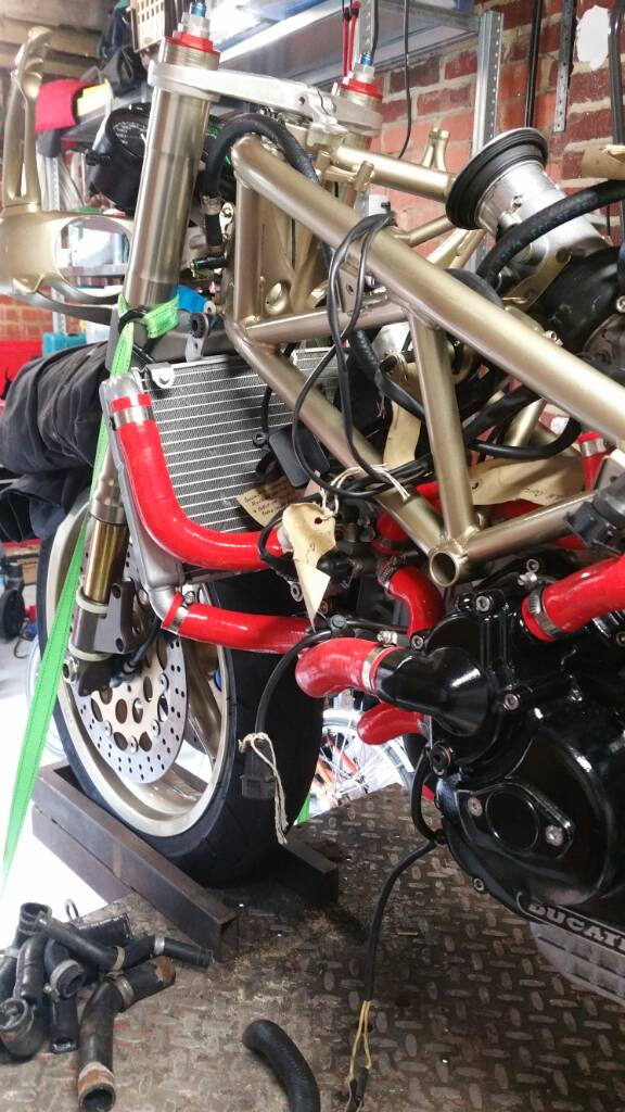

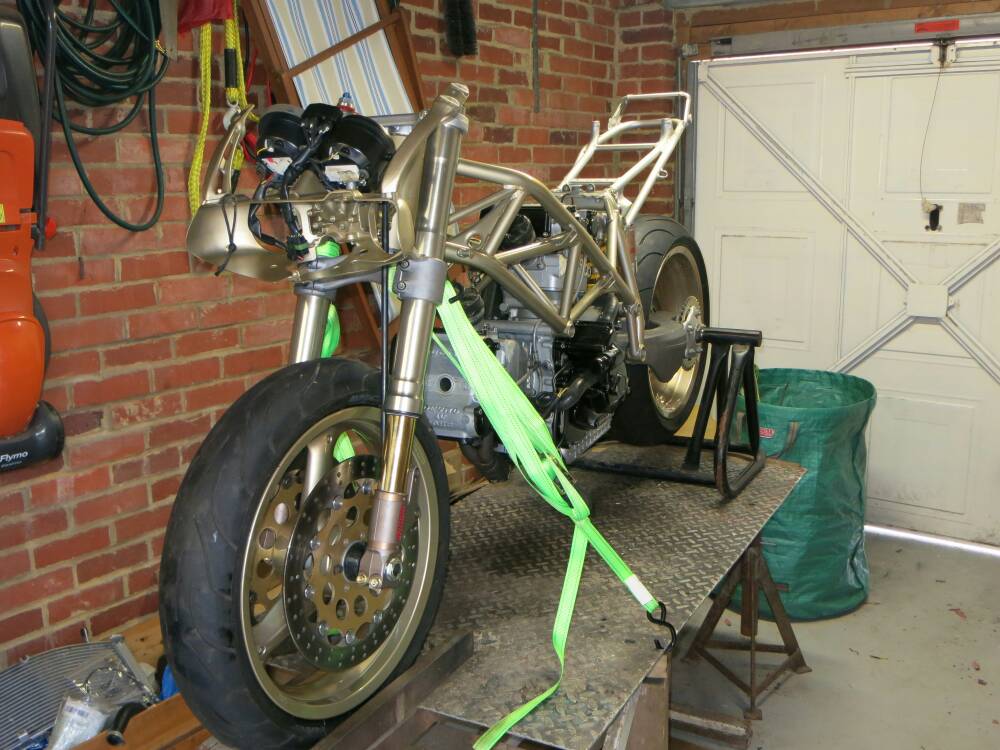

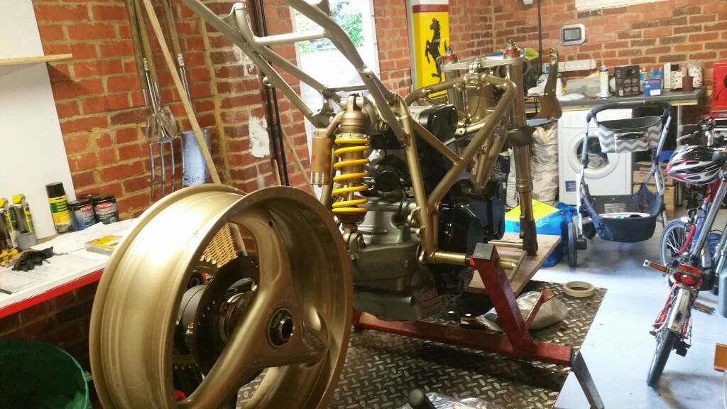

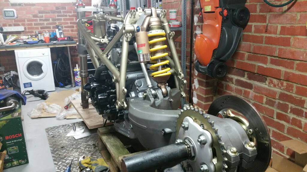

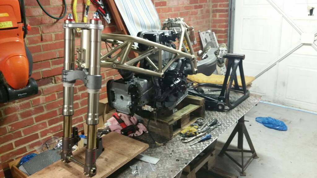

  11. So,
    As promised, a little update.
    The wheels have now been painted and powder coated by Primo Alloys in Guildford.
    The paint was purchased from RS paints.
    The job by Primo was fantastic and I would have no issue recommending them to anyone.
    Wheels bearings (SKF) then pressed in and my new Ducati tyre valves attached.
    My dad and I then set about attaching the front wheel which after much messing around was ultimately done with the help of an Abba Stand and front lift. Awesome bit of kit and made the job a breeze.
    So both wheels attached. Looking a lot more like a bike! Very exciting.

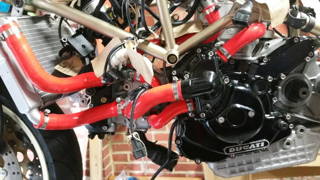

    The coolant hoses were a bit grubby so I bought some silicon replacements. Now I know that these won't be seen but I know they are there and they are significantly stiffer than the 17 year old ones I replaced. New (ish) stainless jubilees finished it off nicely.
    Next job is the wiring, which from the nearside at least doesn't look too daunting. The offside from photos looks a bit more of a rat's nest but think I'll be OK as long as I'm methodical.
    Should be able to make a little more progress this weekend.
    Here are a couple of photos.
    It continues.
