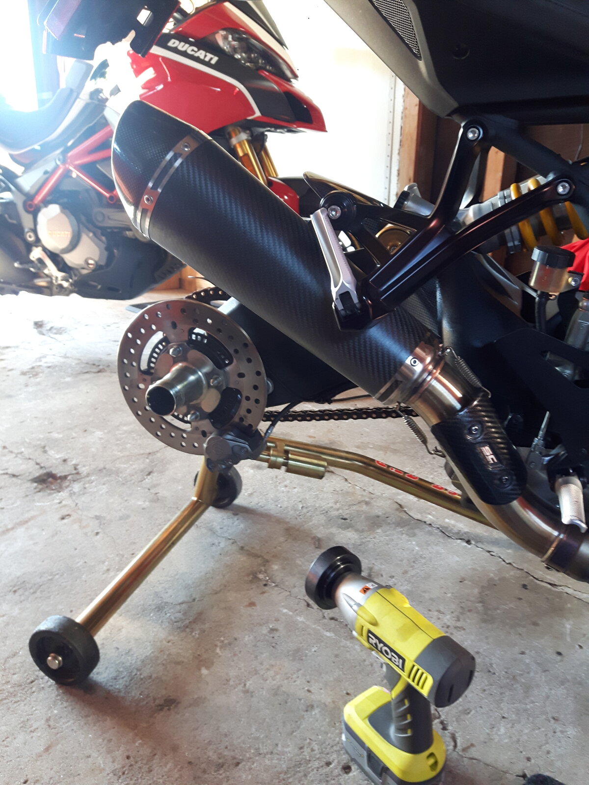

  3. Tools...... what size socket is required for the front sprocket retaining nut? (I've got an impact gun)
    Can anyone post a link for a decent tool required for the back sprocket? (Steel better than aluminum?)
  4. I have used this tool on my Monster when I took the rear and front wheel off.
    https://www.machinemart.co.uk/p/laser-6356-55mm30mm-wheel-impact-socket-ducati/
    if the impact gun does not shift the rear nut. Then some “Plus Gas” and a little heat helped me (heat gun not flame). The nut washer can seize a little with a little corrosion especially if it has not off before. A little grease on reassembly is your friend.
  5. That looks the job!
    Fits under the seat in case of emergency ;)
    Cheers

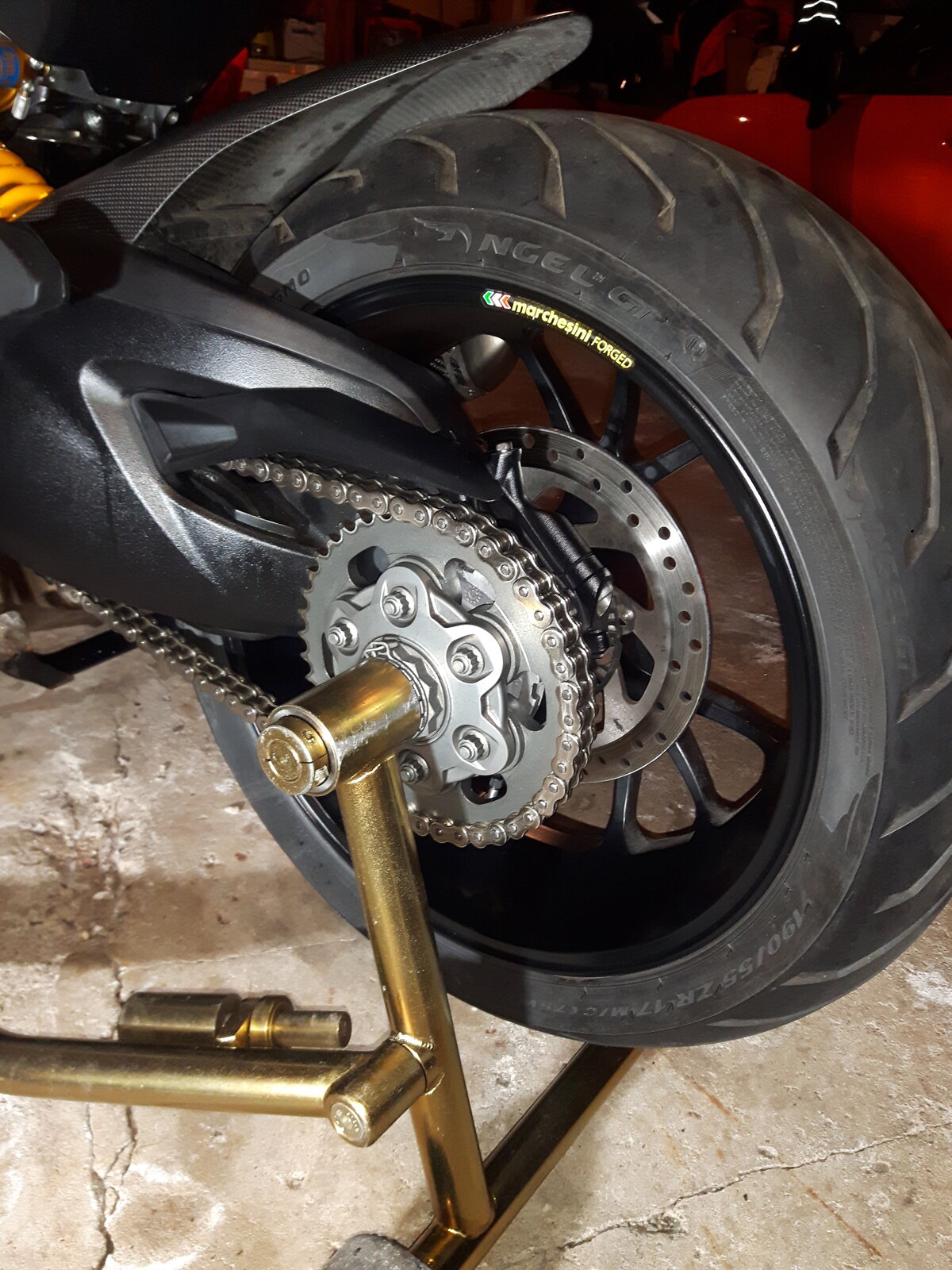

  7. Hi Pcn1, sorry for the late, post but thanks for the useful info. I’m looking to do the same on my 2020 1260s in red, was wondering what the gold chain looks like on the bike? Any chance you could post a pic please? It seems that there’s very little choice apart from gold chains. Cheers.

  10. I wont be doing the job until spring. I'm not worried about the gold color, its not too bling in the flesh :upyeah:
  11. Ah sorry yes, I just read your earlier post where you mentioned that. My current chain is gold and I don’t think it looks bad at all.

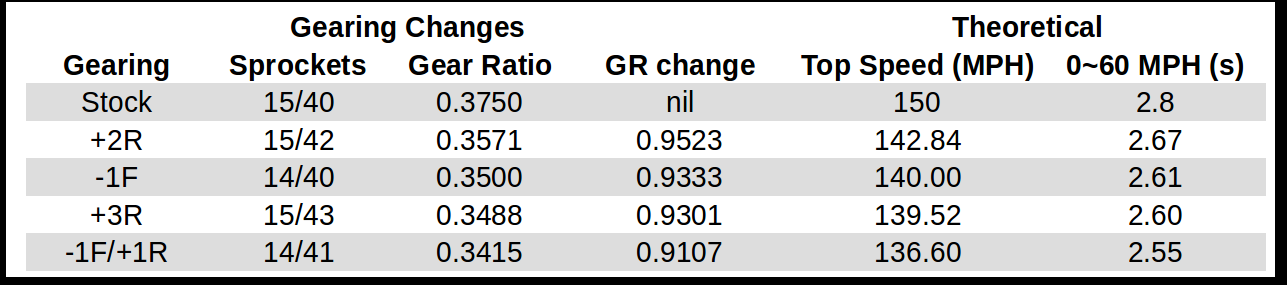

  13. I have produced this table to illustrate the impact on gear change effect.
    I used a 150mph top speed as a baseline although the bike may run a few mph faster so please don't tear-apart the messenger. Moreover, the theoretical top speed changes are simply mathematical.
    In real life, a small increase in leverage such as 15/42 would not reduce your top speed as the bike's stock gearing will not reach redline in top gear. Your top speed will likely remain unchanged albeit at a higher RPM and more in the power-band.
    The (0~60 mph*) math methodology could be off as well as there's a limit to the improvement increased leverage would produce.

  14. Wow that is really interesting and very useful, thank you so much. I’ve managed to track down an Esjot 42t rear sprocket and a nice looking DID Steel front/ black inner chain so think I’m going that route.

  17. Yes, the Gearing Commander is great but the top speed is mathematical and thus unrealistic because the Multi and many other bikes cannot reach Red-Line in top gear. By that token, my spreadsheet's top speed is also mathematical and too conservative but a 150 mph stock baseline is closer to real life.
    What's important to remember is that the increase in RPM resulting from the gearing change move the engine's RPM upward into its power-band conserving most of the stock gearing's top speed.
    All this to say that a +2R gearing change for example won't reduce your top speed by much if at all.
    You can more or less test this yourself by comparing the top speed achieved in 6th gear compared to what you can achieve in 5th gear.
