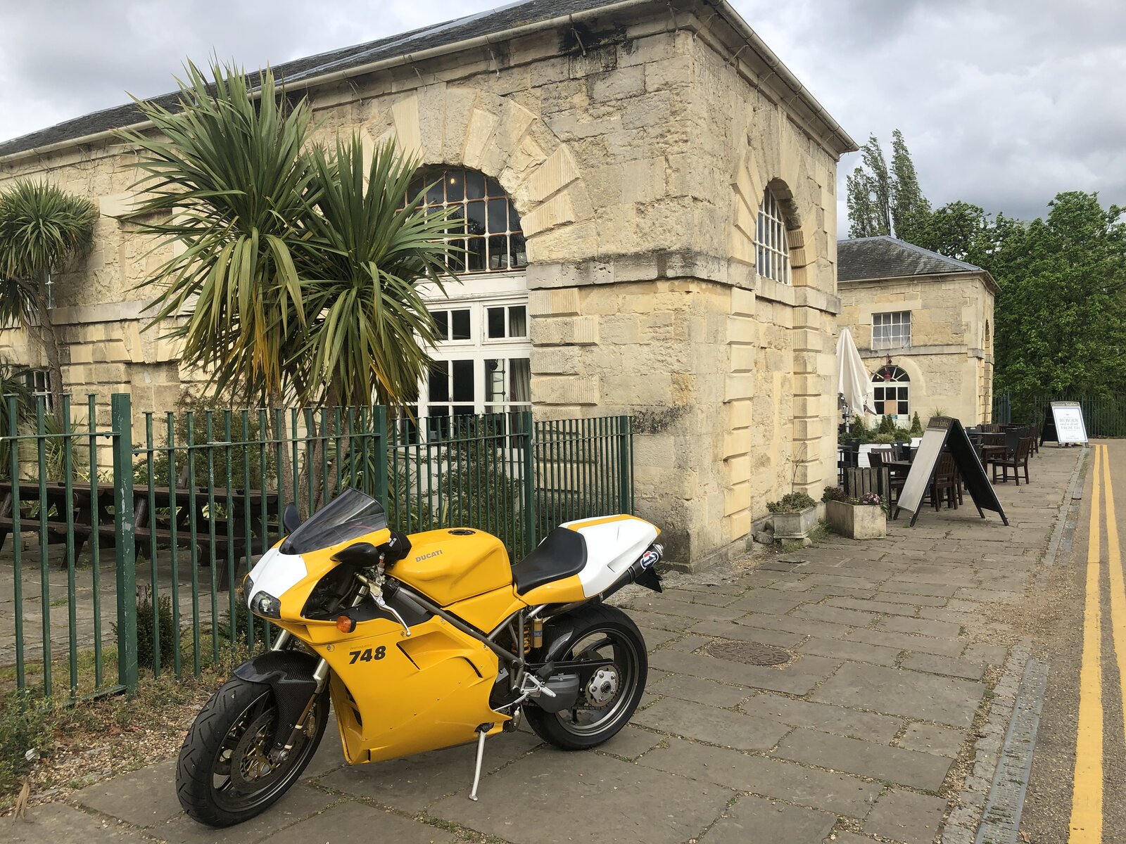

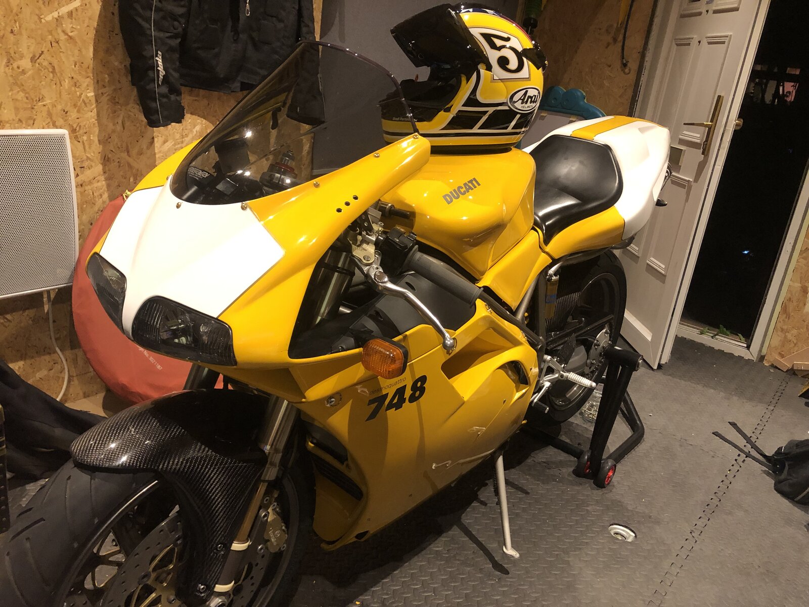

  8. So, just to update - it’s all back up and running and on the road! :)
    The bike had a full on rebuild with all bearings, rings, crank journals, valves etc replaced, rods xrayed and shot peened, new clutch plates, new fluids and it’s like riding a new bike! So tight and responsive!
    I took it out for a ride a couple of nights ago and got home to a small amount of oil in the bottom of the fairing. On inspection, I found the upper part of the thread on the engine casing had a crappy thread on the oil pressure switch. Seems there’s only 7mm of thread on the pressure switch, but the part Ducati have has 12mm thread. One of many issues found with the bike since the strip down, but now resolved.
    Massive thanks to Andy @final_edition for his help and putting me in touch with Mike at BBS Motorcycles. Mike comes very highly recommended and treats your bike like his own.

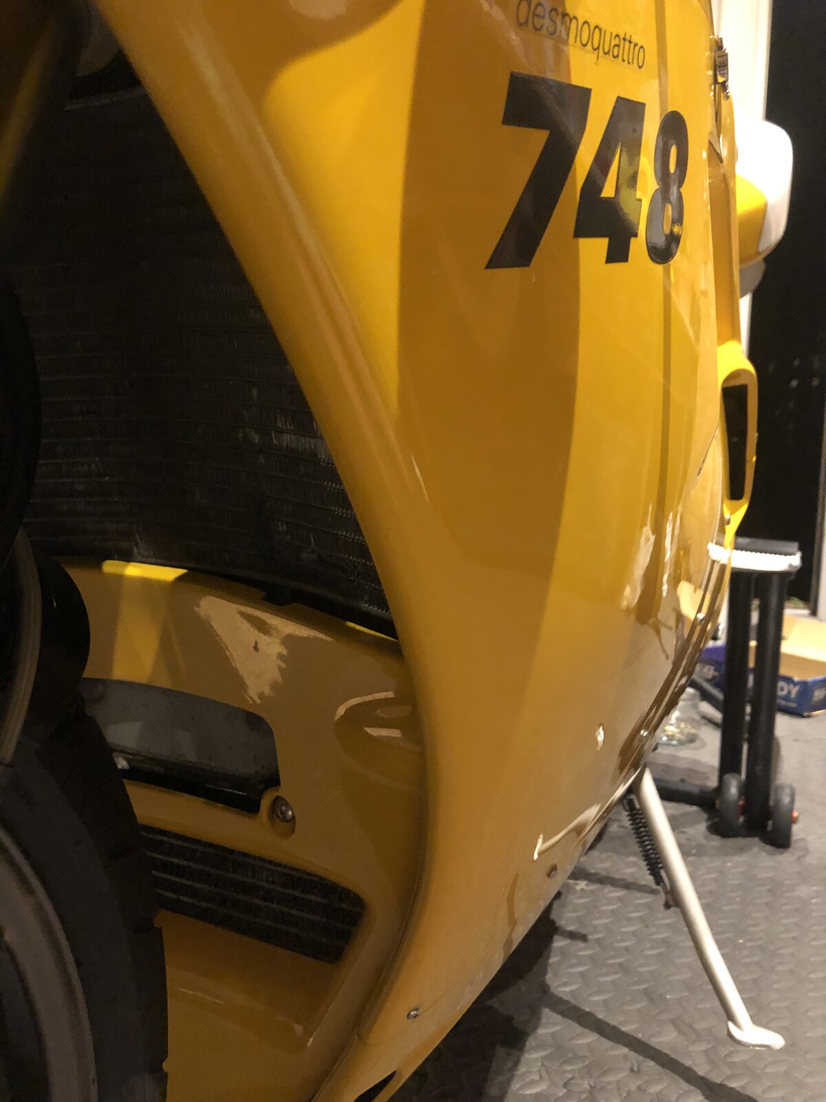

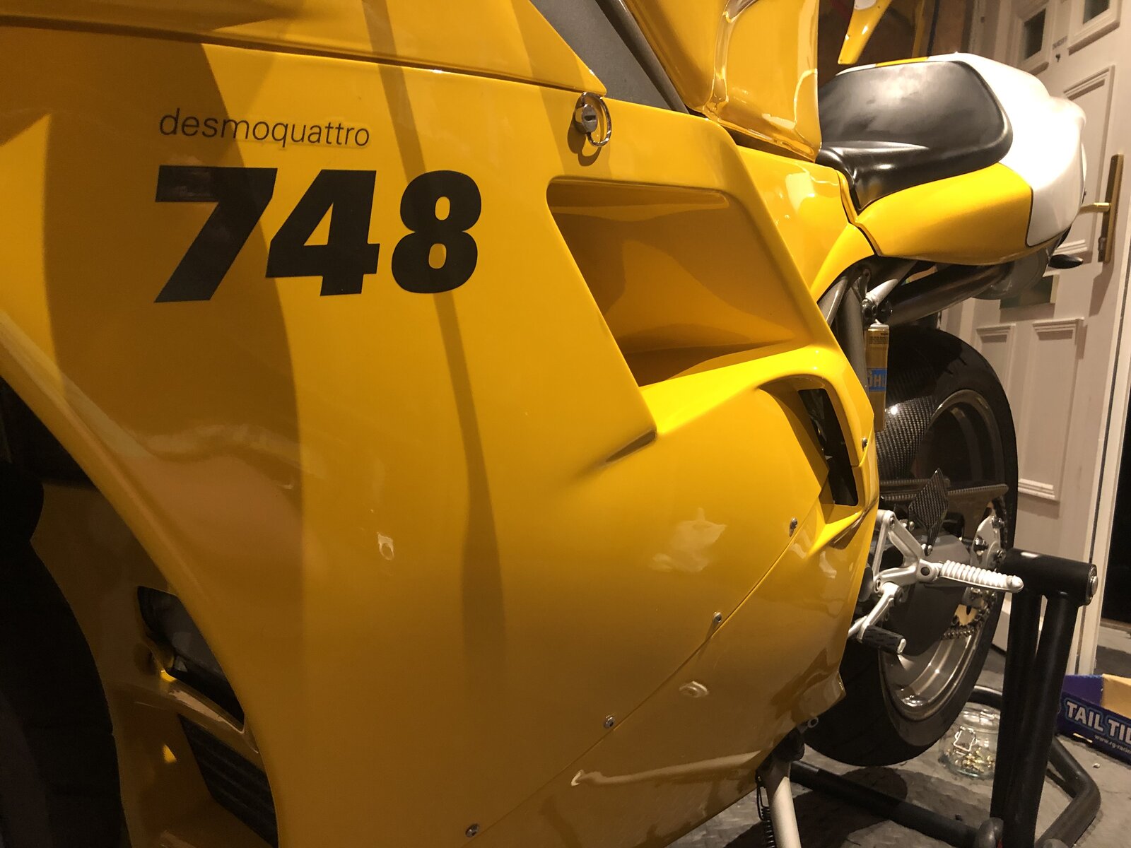

    Cheers Paul! I’m going to get it painted over winter to bring it back to life, as it’s got a couple of dinks in the tank and couple of small chips in the paint. But this summer is time to enjoy it :)
