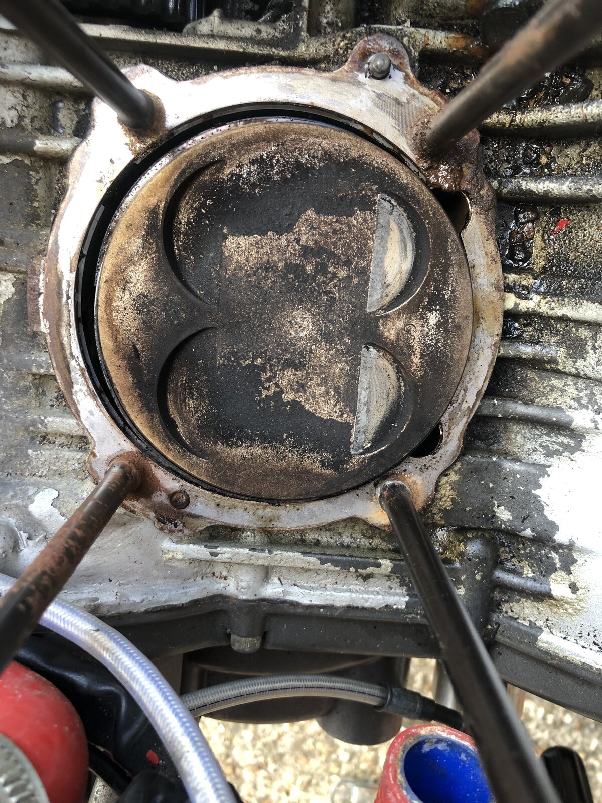

  9. Hi all, sorry i'm not replying to every post, been a bit busy the past couple of days. So I have a really stupid confession. The reason the compression tester wasn't working is because there was no compression in the vertical cylinder. I tried the horizontal tonight and theres compression but only around 75psi. Duh.
    Took the timing covers off fully and all belts line up including crank. Also took the rocker covers off and all seems ok (can't see too well though to be honest). Father in law has suggested a leak down test which we'll do the weekend with his compressor as he noticed the vertical cylinder seems to blow back through the throttle body when cranking. Anyway, I'll continue to read the suggestions and post updates just in case anyone else has this problem in the future.

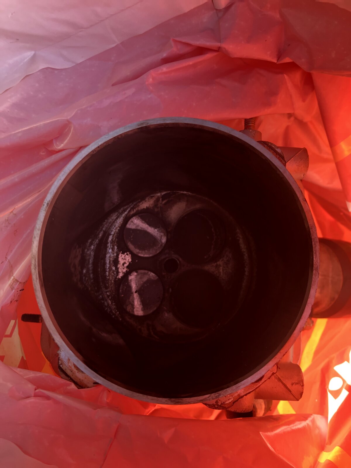

  11. 2D06C528-89F6-4D5D-93AD-E4293F7D99C9.jpeg ED08C9DB-E7AC-4584-BB12-BA0FC1A261D4.jpeg Drumroll please... the issue was...the idiot riding it by the looks of it :(
    Bent exhaust valves, i don't remember missing any gears but the evidence seems to point that way.
    Not the best but thought i'd post an update in case anyone else had the same problem.
    Time for me to get pricing parts up...

  14. I'm trying to figure out how it managed to bend the valves on both cylinders simultaneously. A desmo engine won't allow valve/piston contact by over revving and it's extremely unlikely that both belts would jump teeth at the same time. Perhaps they weren't timed correctly in the first place?

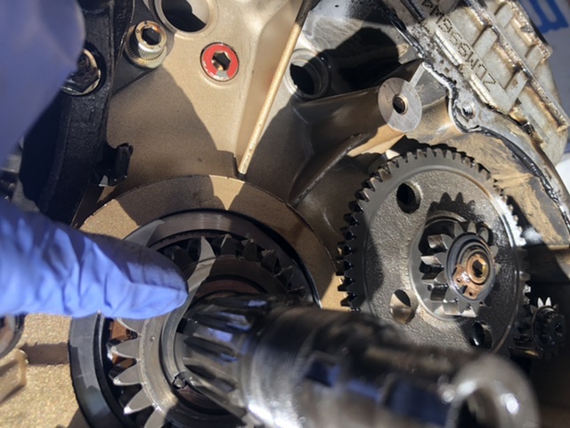

  17. Ok so time for another update. Have replaced the valves and still the timing seemed ok but we noticed the TDC markings weren't TDC - the piston had another inch or so of travel. Worked out that something between the timing shaft and the crank shaft had gone, woodruff key maybe? Pulled of the engine cover, removed flywheel and stator (which had a loose nut) and yep, woodruff key on the crank shaft had broken. Not ideal but finally found out what had gone wrong, happy days!! Then... realised the woodruff key has taken a chunk out of the crankshaft :sob:
  18. New crank then??
