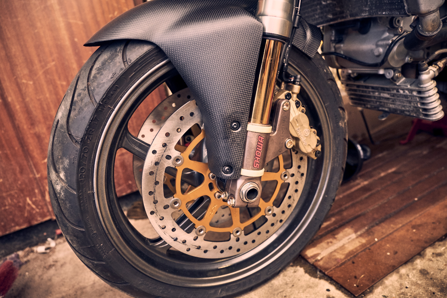

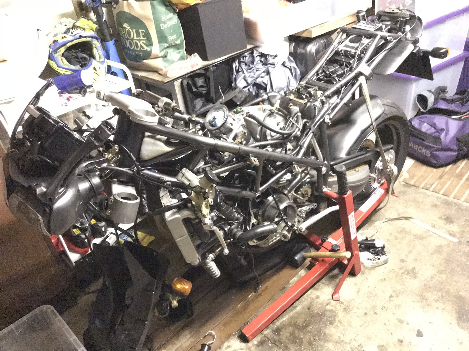

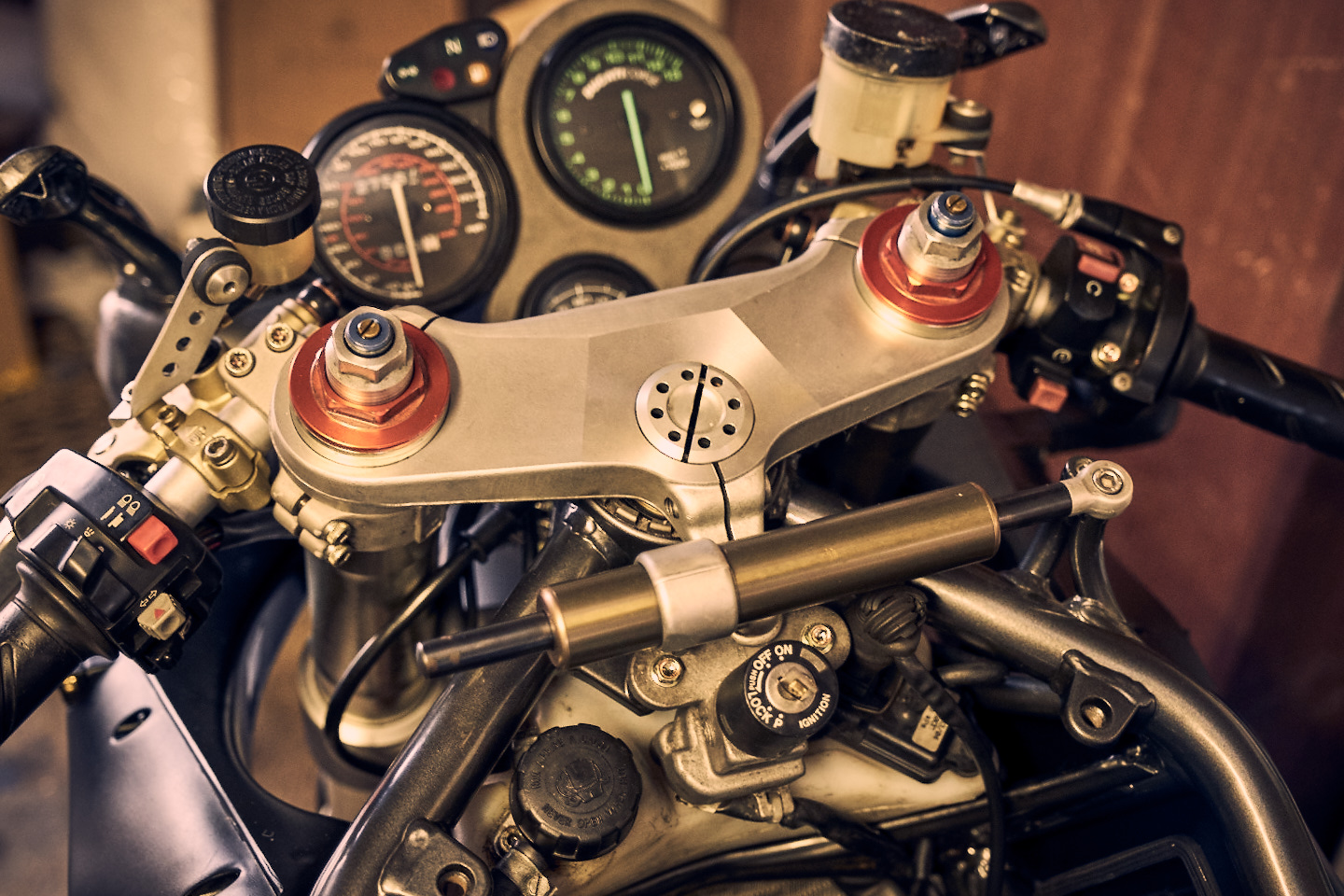

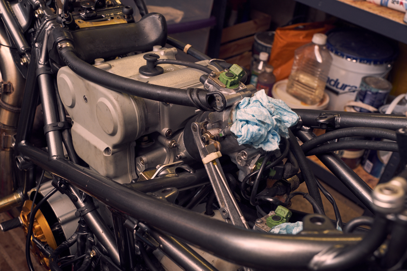

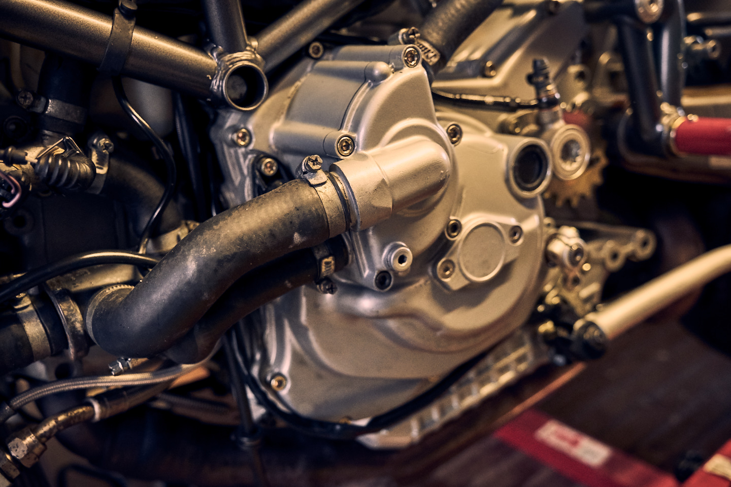

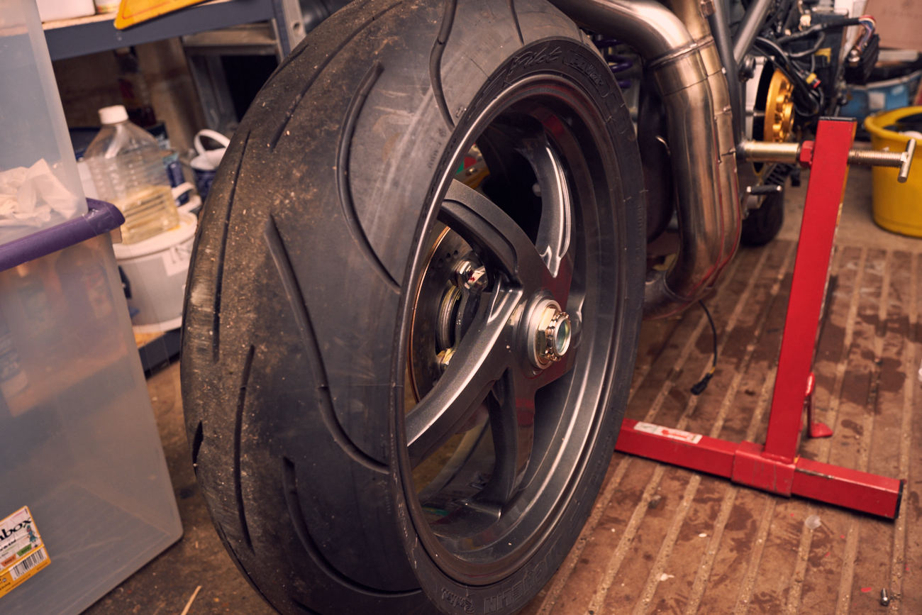

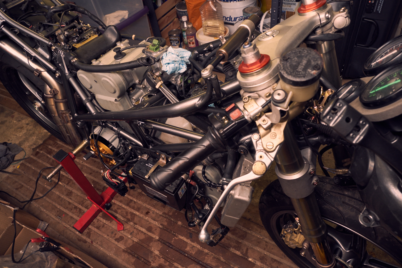

  1. Had the camera out anyway... so here's a couple of pics of the work in progress, but nearing the end.
  2. No samco hoses?
  3. I'm getting through a very extensive/expensive "must-have" list. The Samco hoses are, sadly, on the "nice-to-have" list.

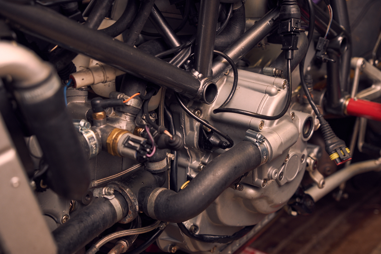

  5. Not much more I can do on the bike now (said no one ever). Tank, fairings and rear shock are with their respective specialists. I've assembled everything that looks essential. I have the requisite handful of bolts leftover (well many were replaced with newbies). So until I get the last parts back from the doctor the bike is, I sincerely hope, as ready as it can be. With some luck I'll be assembling the final pieces of the bike next weekend. DSCF2030 1.jpg DSCF2033 1.jpg DSCF2034 1.jpg DSCF2035 1.jpg DSCF2045.jpg

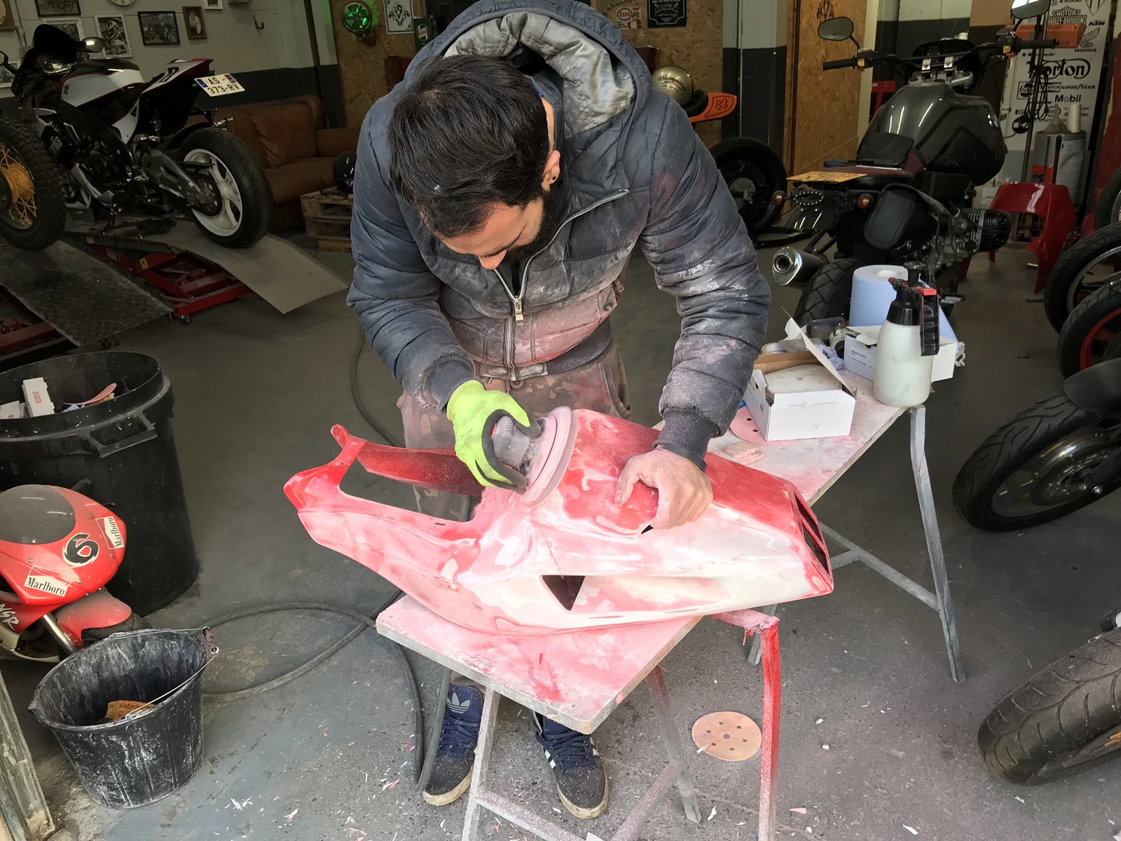

    Then there’s the paint and repairs. Wow, the quality of work I found on the monoposto seat from whoever painted the number boards on. Well let’s just say removing the paint and clear coat was achieved with a spatula.

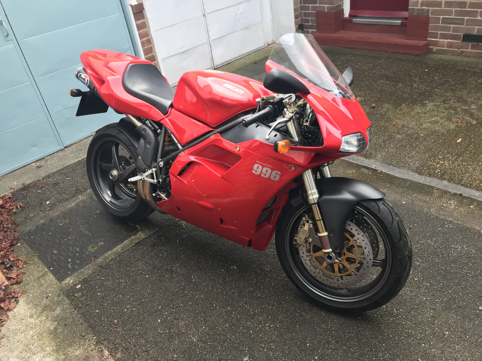

  16. Here she is. All dressed for her first MOT since 2011 and having completed (99.9%) the big rebuild.
    Short ride to the MOT station and she feels awesome. Running 15 x 39 gearing and a newly built and tuned engine and I swear it is miles stronger than it was before.
    Not gutsy enough to crack open the throttle yet, certainly not on these greasy roads. But I look forward to that day.
    There will be loads of photos coming soon.
