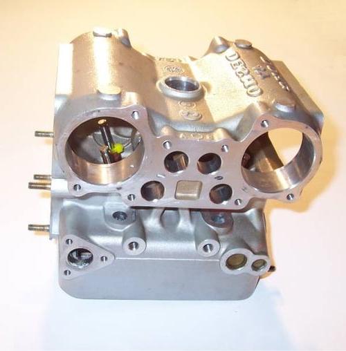

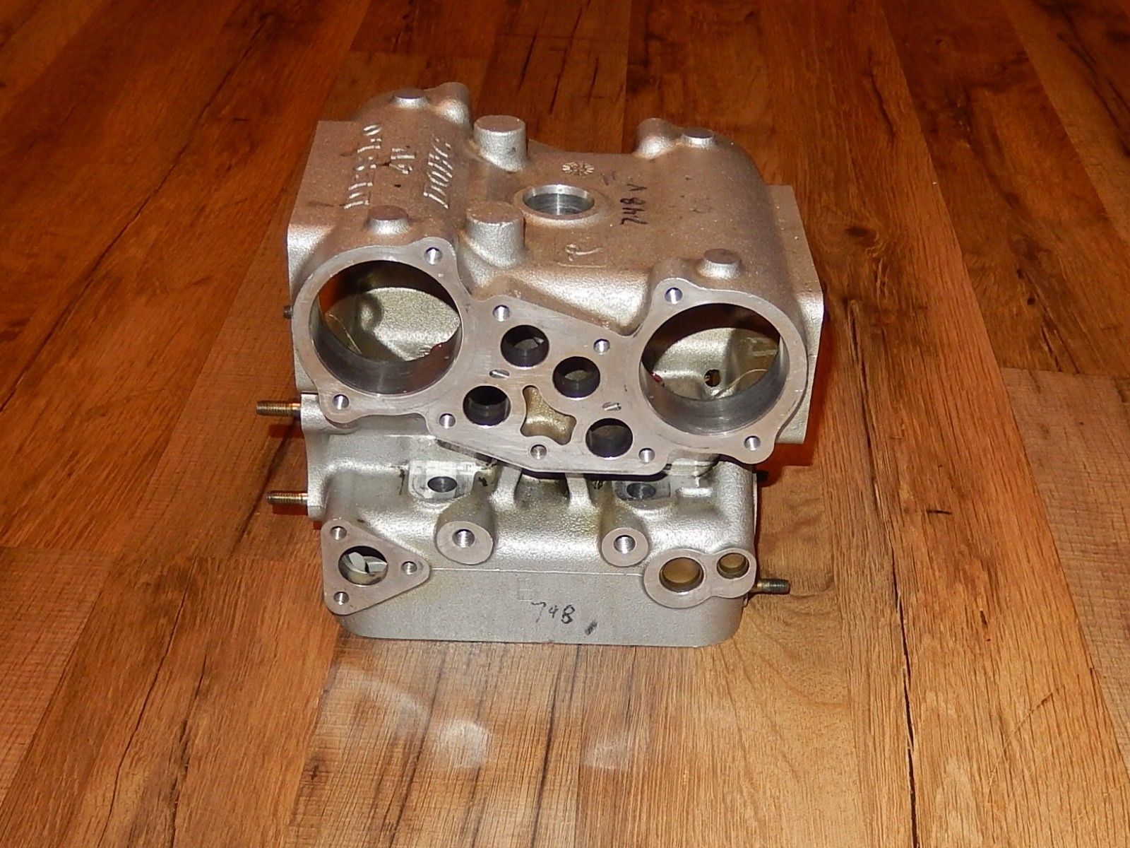

  4. 2002 748E - TBST4 belts? so long as it is a 2002 MY and not a late registered earlier model.
  5. There is evidently some cross over on 2002 748E models so not necessarily the case.
    5 bolt side covers are TBST4 belts.
    All older models with 4 bolt are TB996 belts... apart from 748R which use TB748R belts.
  6. Yes, 5 bolt models were the last to be produced - I bought one in 2002, just fitted belts a couple of weeks ago and as far as I am aware they were designated as E models as opposed to Biposto although I have seen older models referred to as being E.
    As you say, surefire way is to check the rocker pin covers for number of securing bolts.
  7. It might have been Nelly who mentioned 2002 E models used both types of head - clearing the shelves perhaps!
  8. Who knows, we're talking about Ducati here.
  9. What's the difference, teeth profile, length or width?
  10. Length
  11. Cant he measure his?
  12. Much quicker and easier to just check the rocker pin covers. See Exi's photos post #86
  13. I’ll count the number of teeth on the belts
  14. Look at the pictures Exige has put up earlier and count the fixing bolts on the plate between the cams.
  15. Mine as the 5 holes and 93 on the belts
  16. TBST4 then, plenty of stock here :)
