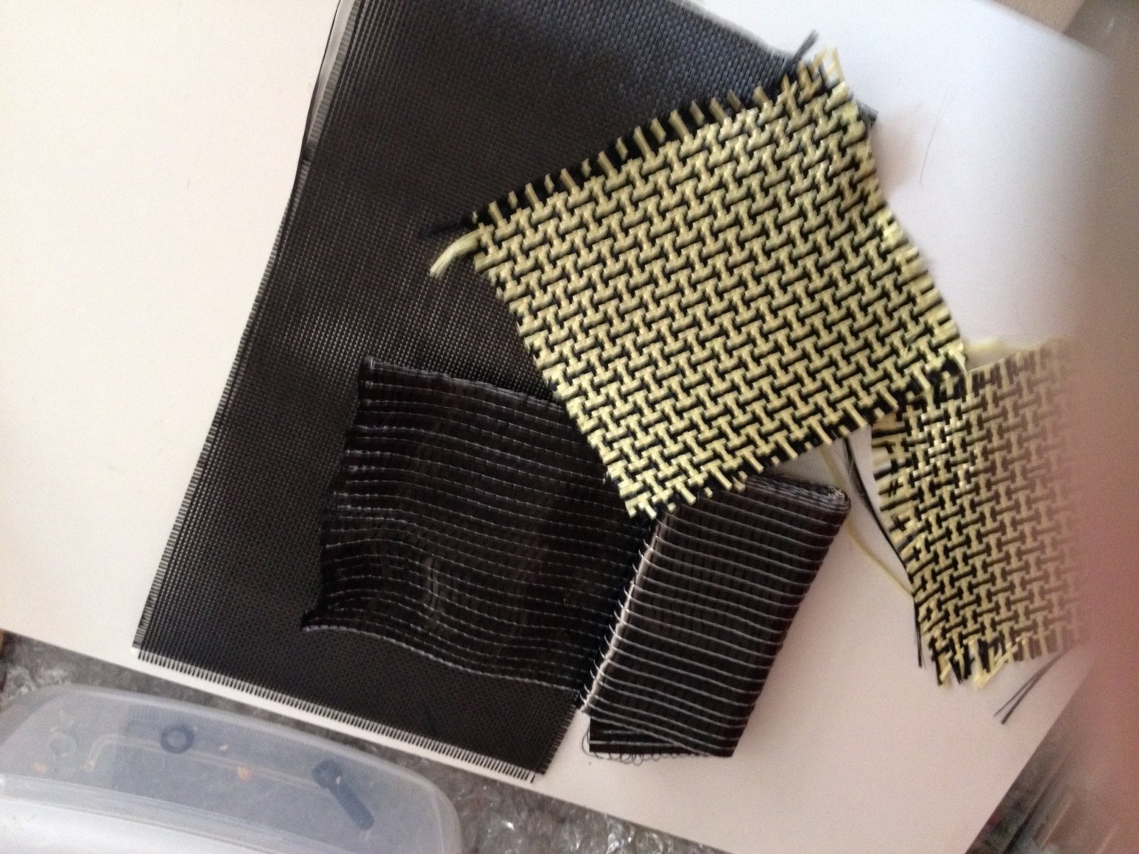

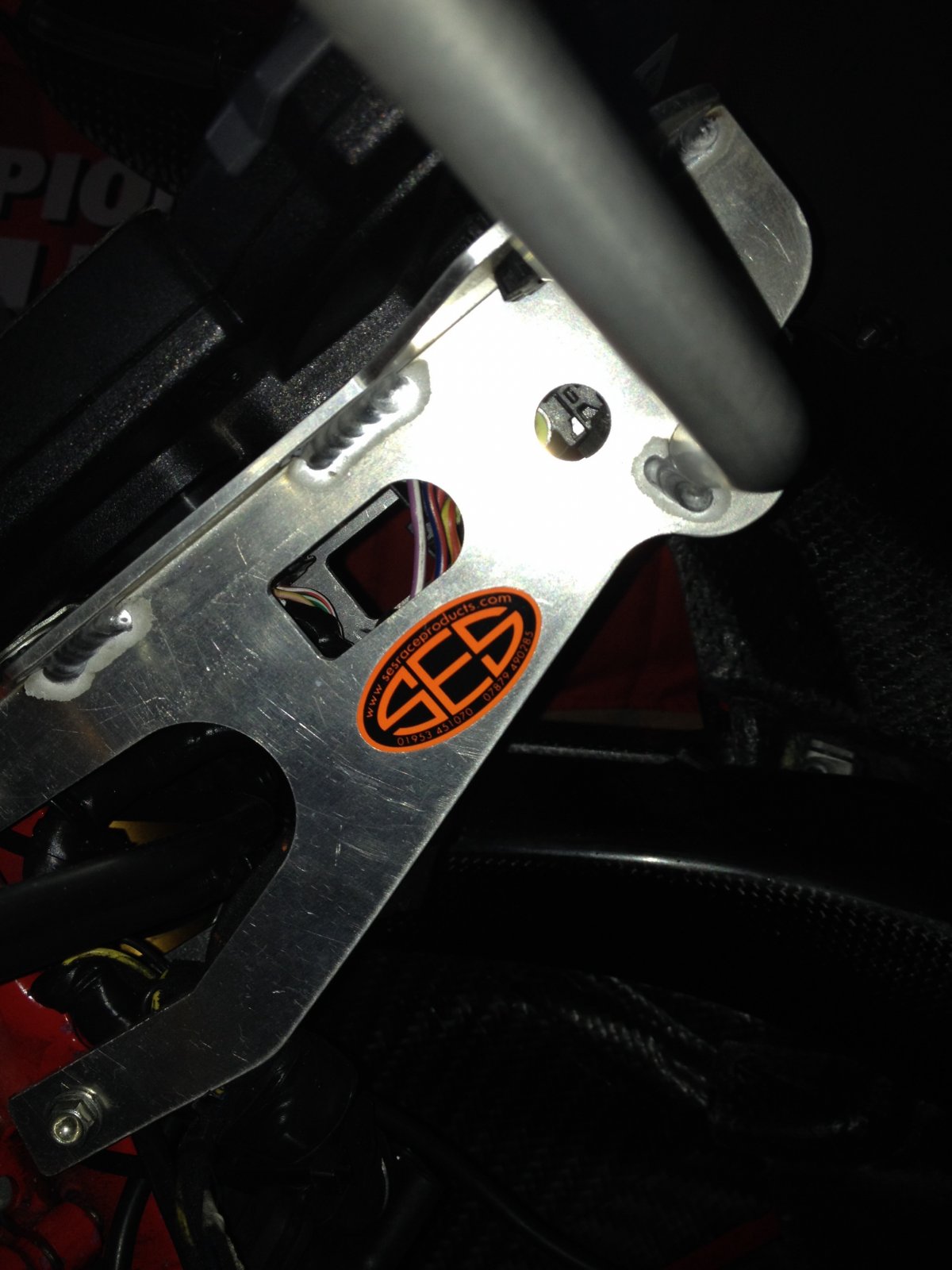

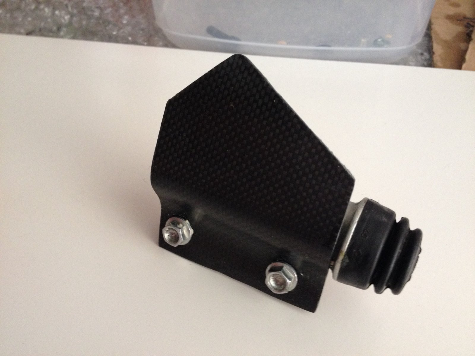

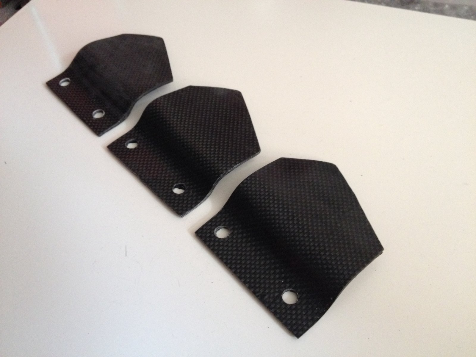

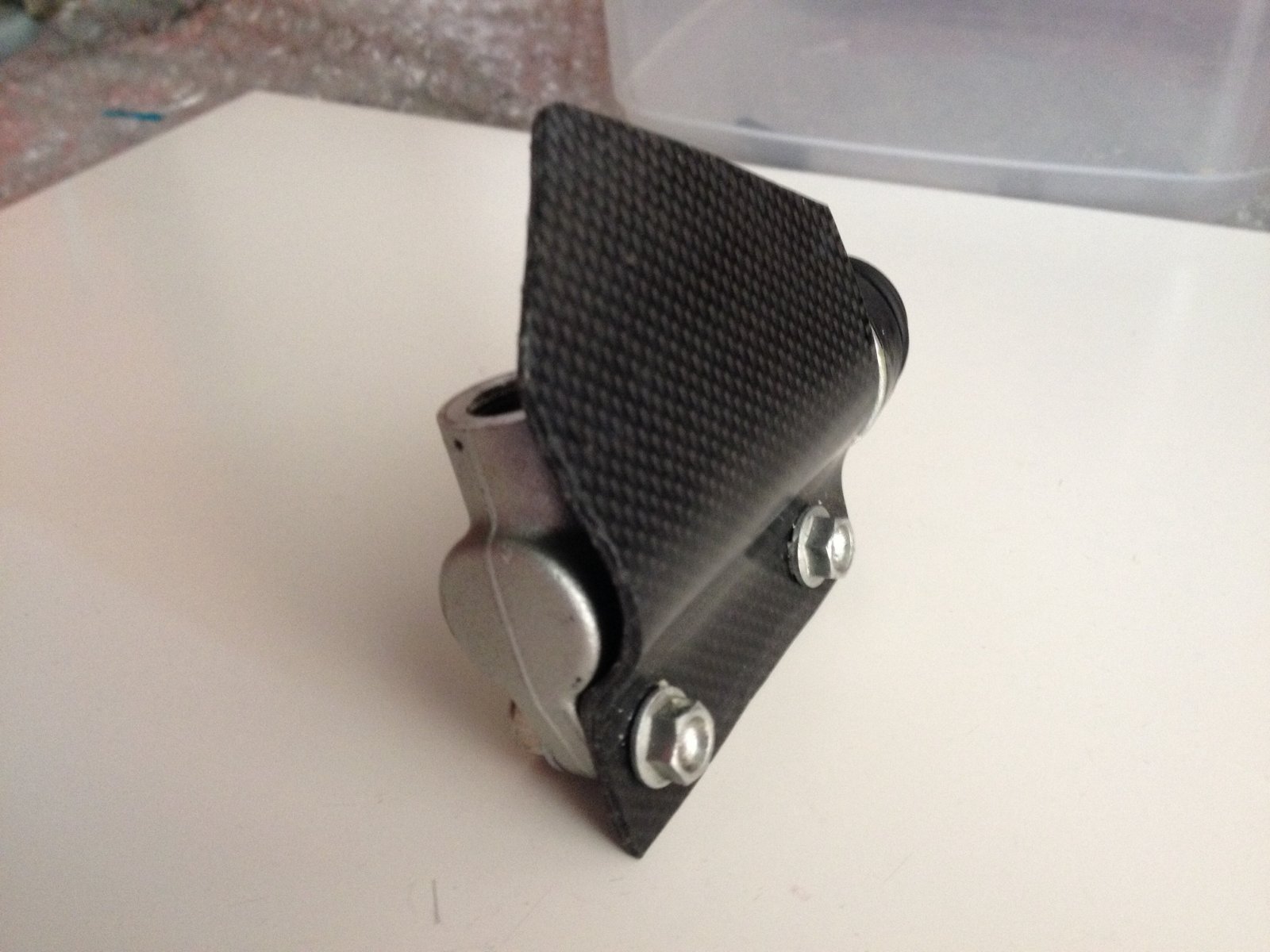

  4. Here is some pictures of the aluminium race brace, not much to see though as its so small. I do actually make a carbon rear brake cylinder protector. These are a plain weave finish and made with unidirectional carbon cloth and Kevlar core. same finish as Ducati Corse carbon parts but a lot stronger. Will post pictures of them in next few days. Just give me a shout whenever you do the rs seat unit

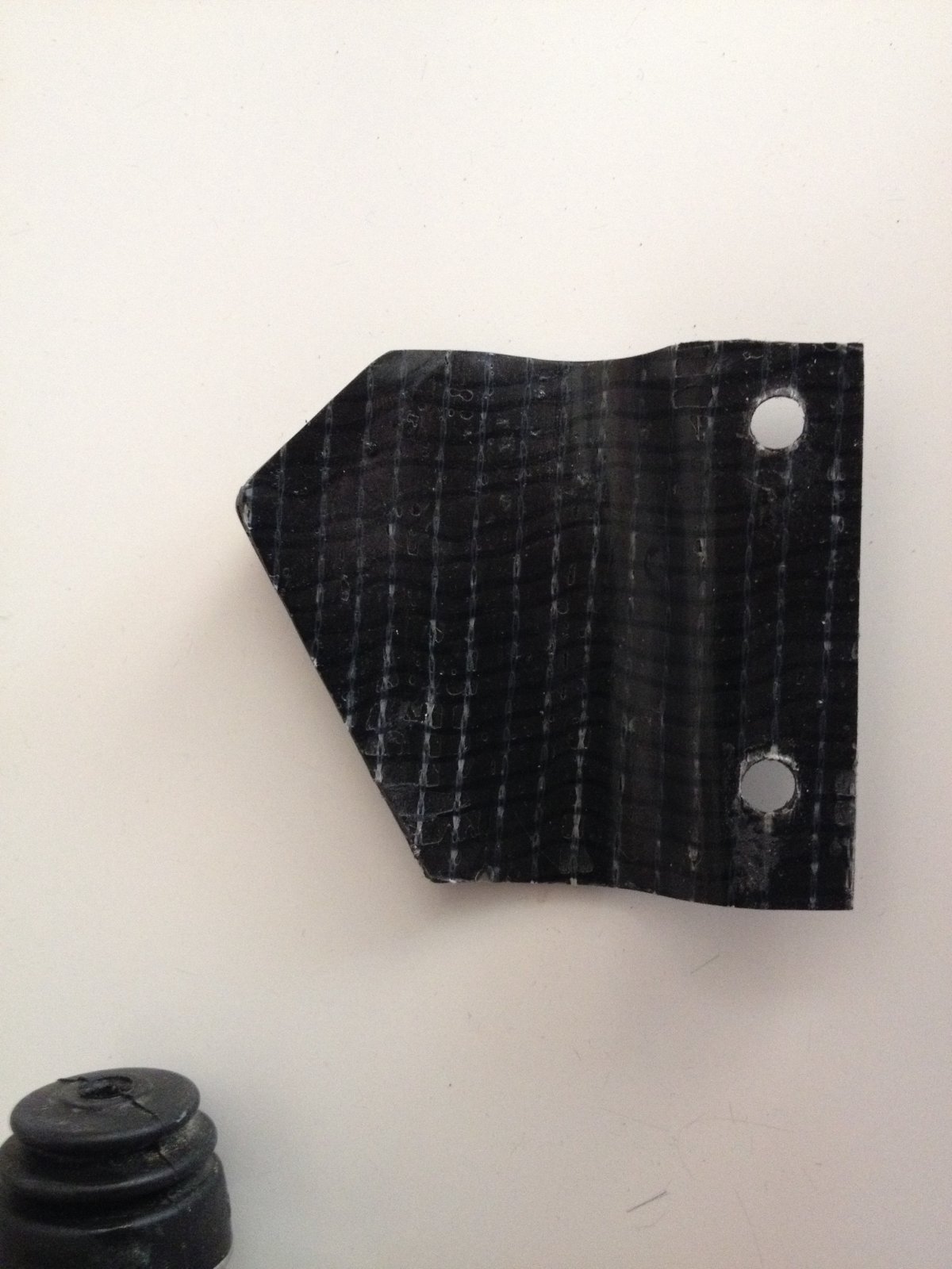

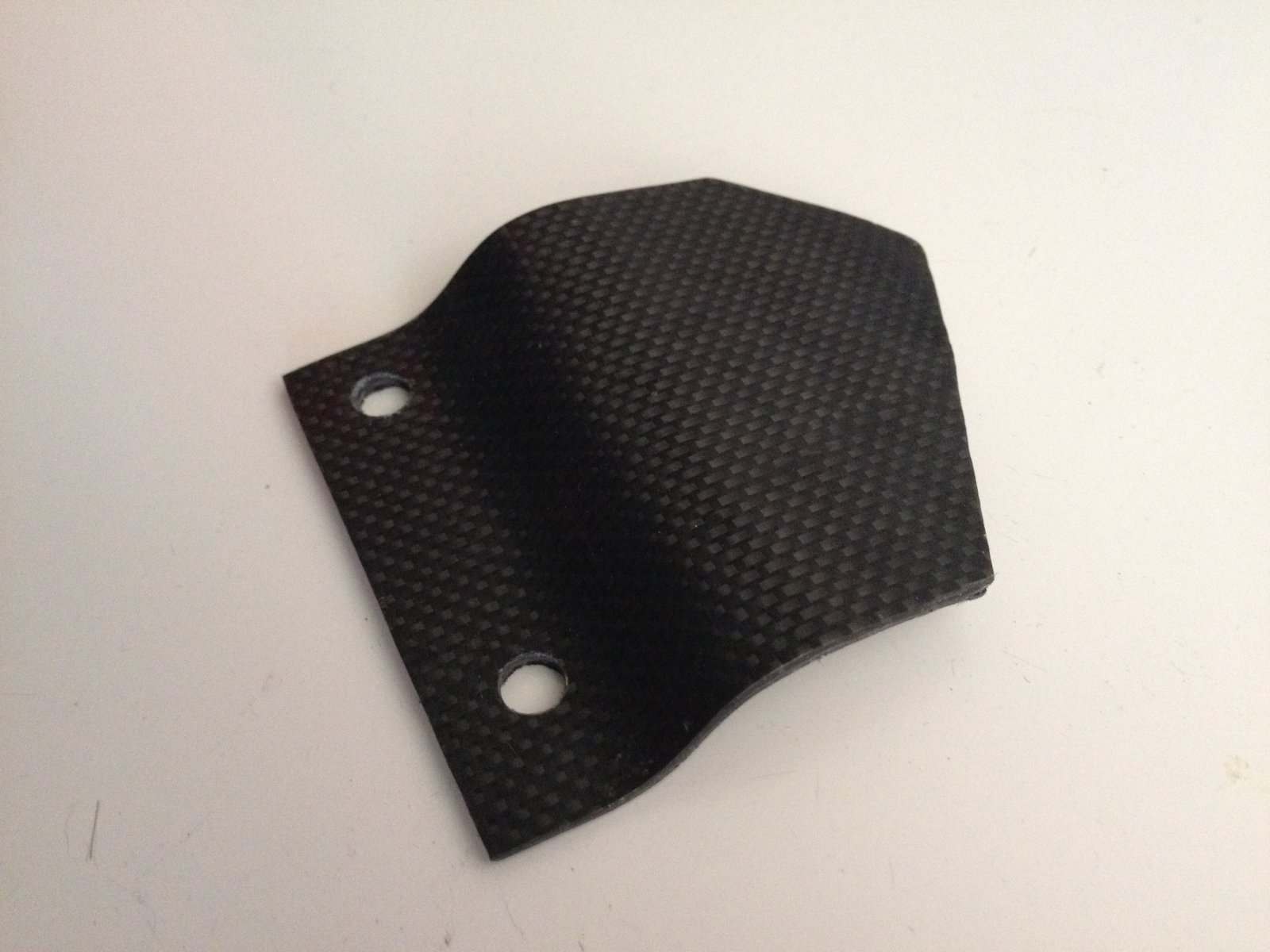

  5. Here are the carbon protectors. I use the same plain weave as what carbon dream, who make all Ducati carbon.
    You can see the 200g unidirectional cloth and Kevlar, of which I use six, which makes the core. Also these are designed in a certain contour to alleviate stress cracks both vertical and lateral.
    I get a few orders from club racers as these are hard as nails, most people think carbon is made from plain or twill weave. Carbon structure strength is from the unidirectional cloth at alternate angles. Plain or twill is simply the asthetic finish.
    I've yet to see any carbon made from unidirectional cloth with a Kevlar core from anybody. It's always layers of plain or twill where the fibres are prone to straightening out under stress or even worse a fibreglass lay up using a black pigment in the resin and finished with a carbon top layer. Also there is no such thing as flexi resin, it's a cover for the above. I work as a structural engineer a lot of the times with composites.
    These are compressed, not wet lay or vacuum bagging, to drive out excess resin as resin is needed to keep fibres in place only, it's the fibres which add strength. Resin does not add strength. The more resin and laquer used, the less mechanical strength it will become. I won't go and bore you anymore!
    They come out as a Matt semi gloss finish and can be wax buffed to shine in 5 mins. Any wax is ok to use as these are UV and chemical resistant. Also wax is an excellent protector from fluids.
    Designed to be practical first, but look good too.
    Quite expensive to produce as I use aerospace materials and I only make when I have time, but only £10.00 more than the cheap Chinese carbon junk on the market by so called "motorcycle carbon companies" I'm still finalising them to some extent.

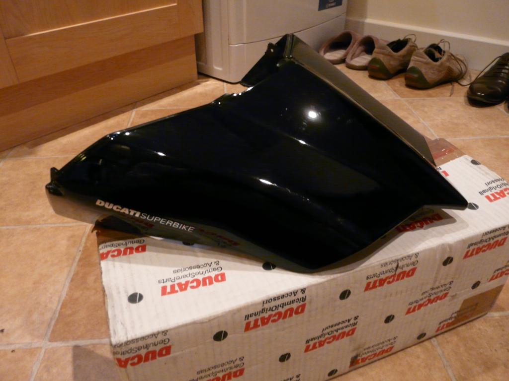

  10. Was there ever an oem carbon exhaust cover . The part that is bolted to the seat unit not the rap around exhaust cover. My 06 had a plastic seat unit ,which is now cabon , but I havent seen the part that bolts to the seat unit in carbon.
    Mono seat cowl . At least I now know what its called .
    #90 ducati2242, Apr 3, 2015
  11. My Fila R bought off the original owner came with a Termi sized Carbon Exhaust Cover and a Standard opening Carbon Exhaust Cover: it was said to come totally standard with everything that was with it from new. But having not been the original purchaser I can't be totally sure. No reason to doubt the guy though...
  12. Yeah I got the same with my R but thats not the part im asking about . Its the bit that covers that part im asking about. The cowl so ive been informed.
  13. Both my 2003 R and 2003 R Fila have Carbon ones yes.
