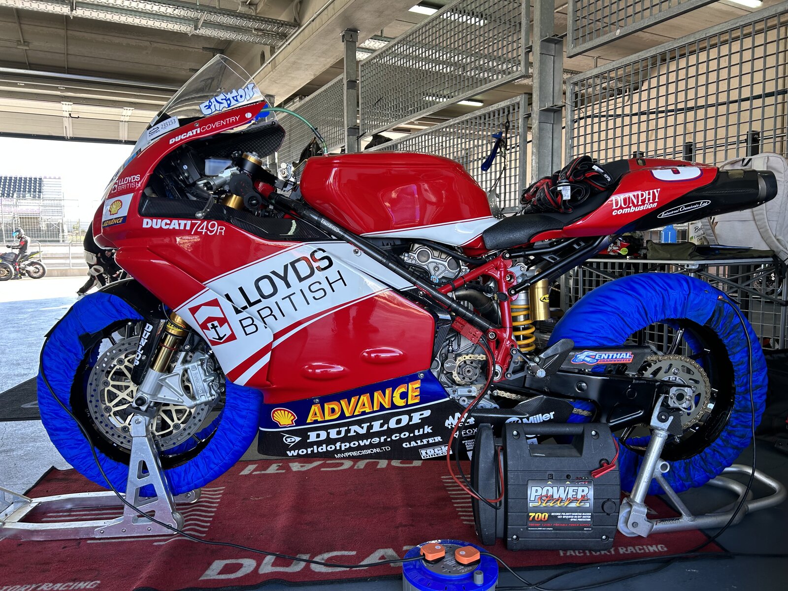

  2. Here she is at Aragon this week.
    Fitted Dunlop 213s and can honestly say I have never ridden a finer handling bike. Cracked a PB 2:16 (was 2:17 on my 1199R o_O).
    Had to put her back in the van after an engine stutter at 8500 developed, limiting my back straight speed to 160 mph.
    More clicks of preload and a turn or two of compression make this incredibly light and nimble bike a joy to ride.
    I will try and get some video up here with the soundtrack.

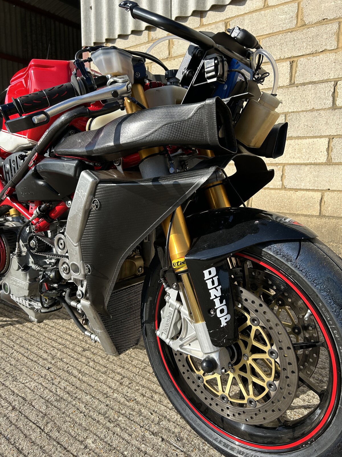

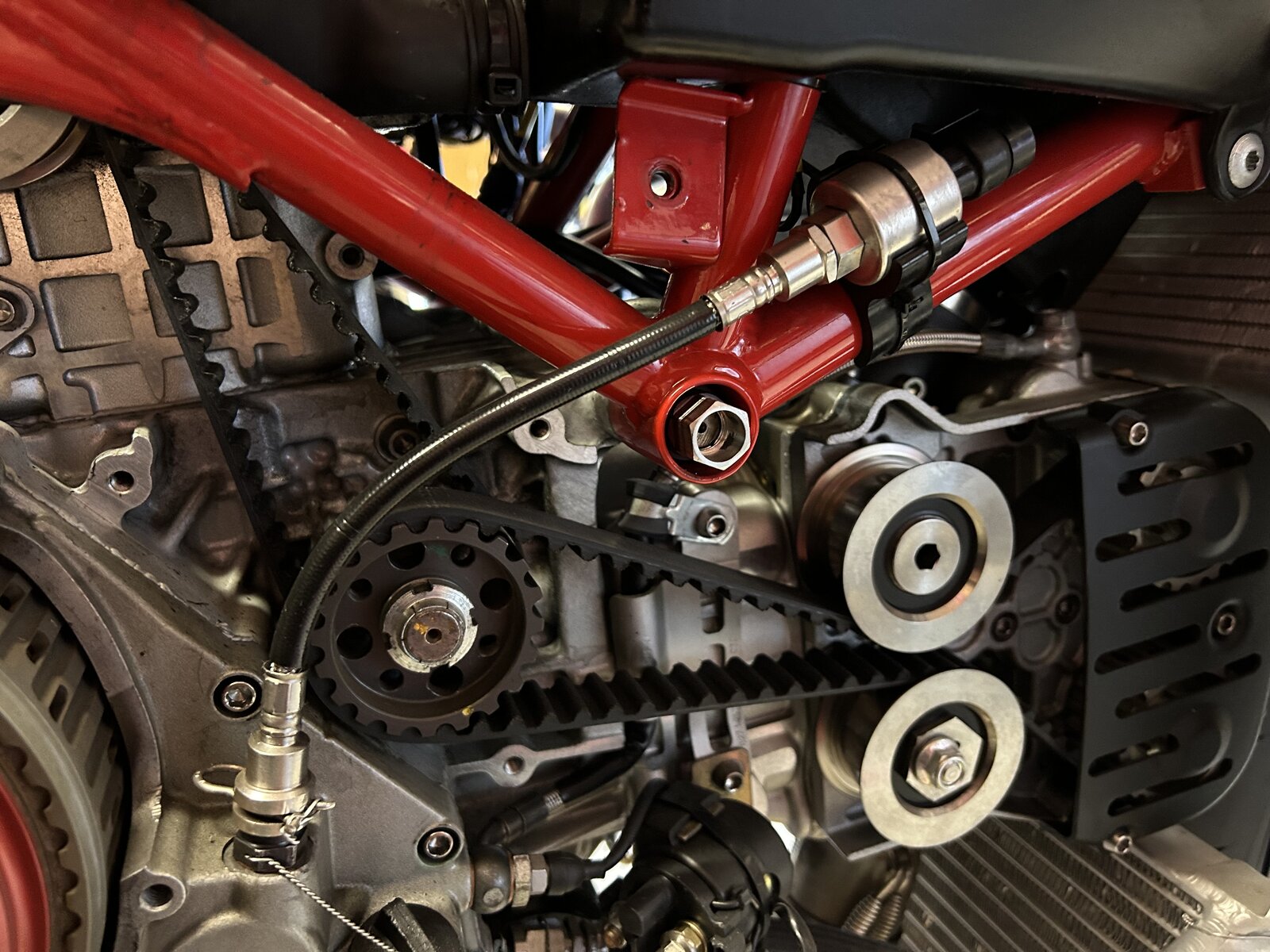

  5. Out of interest what is this? Is it a sort of manual pump to get oil up to the top of the engine before starting it?

  8. Oil pressure sensor for the data logger. No longer connected it would appear.
    Lovely bike.
