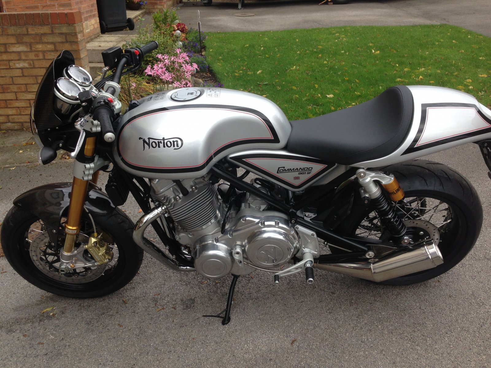

    Ive gone all retro and just bought this to have a play around on....
  18. Very nice Mark
