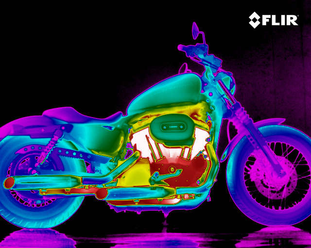

  10. @finm using an infra red camera I can see temperature as colour.
    As you can see I think I've found the problem.
    The Mutley has special paint that disguised this "hardly able to" as a Ducati.
    And as we all know they are the most effective machine to turn petrol energy into noise and heat without the byproduct of Bhp.
    • Nuke Post Nuke Post x 1
  11. yip, a salesman tried to sell me one of those.
    fin, he say ram it. fingers are great, they have heat sensing receptors and everything, :upyeah:
  12. Seriously though the core isn't hot at tick over, but both headers are at 99, if the core was blocked he'd have blown an engine.
