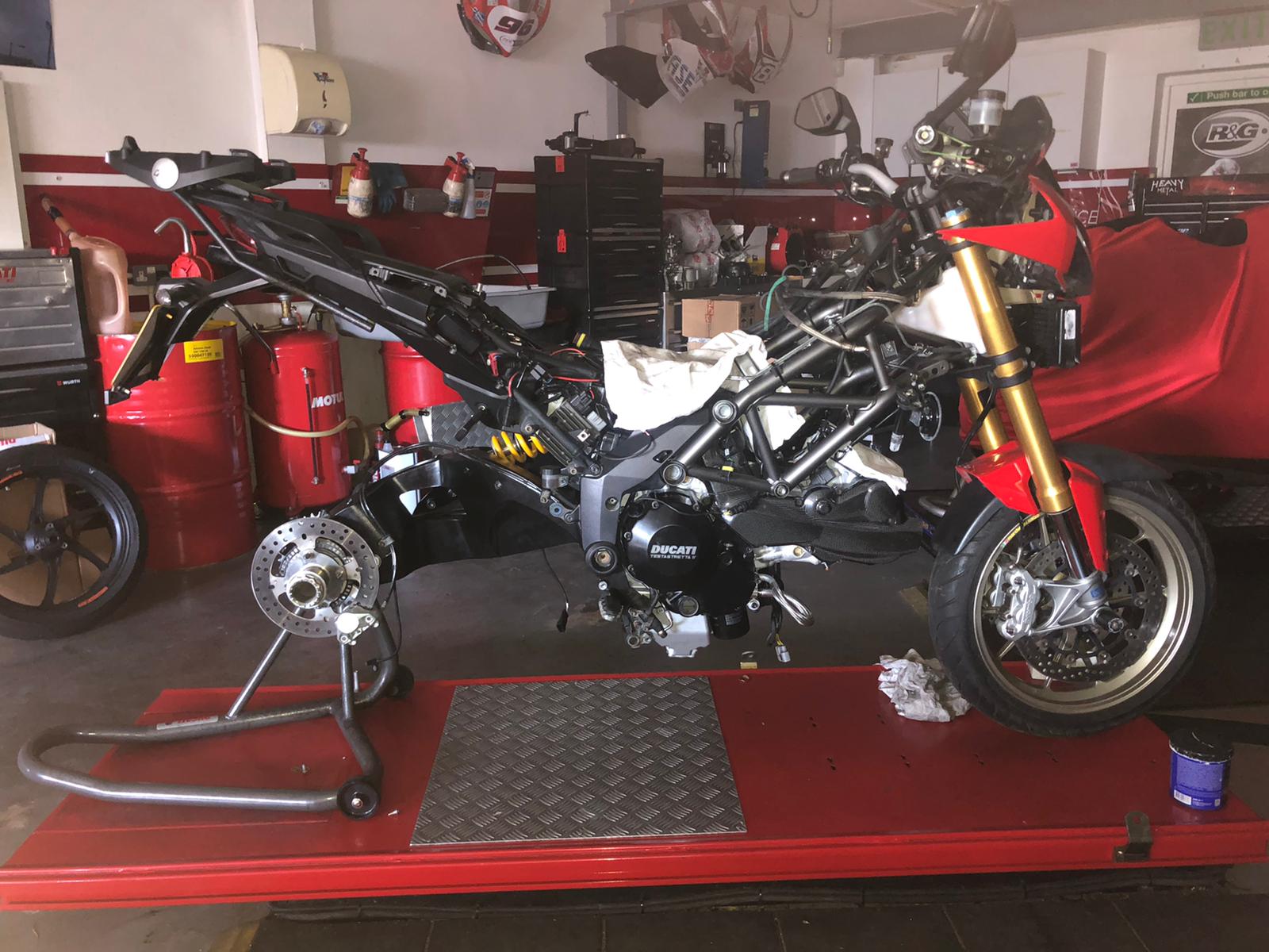

  15. Found this photo I was sent last week.
    Andy
  16. Already looks good. I think you have the right idea - I definitely prefer the pre-DVT engine character, and I kind of wish my bike wasn't Skyhook, because I know it'll be a pain when it inevitably goes wrong. Posh wheel(s) by the looks of it too.
    I think the only thing I'd miss on mine is the colour screen dash. Is that a bit sad?!
  17. Just happened to have a spare set of ultra light 1098R wheels. They make the handling of an already very capable bike into something that is just mental fun. Did a noddy track day in France and was about a second a lap slower than a guy on a V4. As to the dash, not sure I look at it often enough to get any benefit from a colour screen :D Andy
  18. Oh interesting re the wheels. So if I go the rebuild route I should looks at a set of Dymags then! ;-)
  19. Not a fan of carbon or magnesium for the road but a good quality pair of light weight forged aluminium alloys like the OZ Racing, most definitely yes :upyeah: Andy
