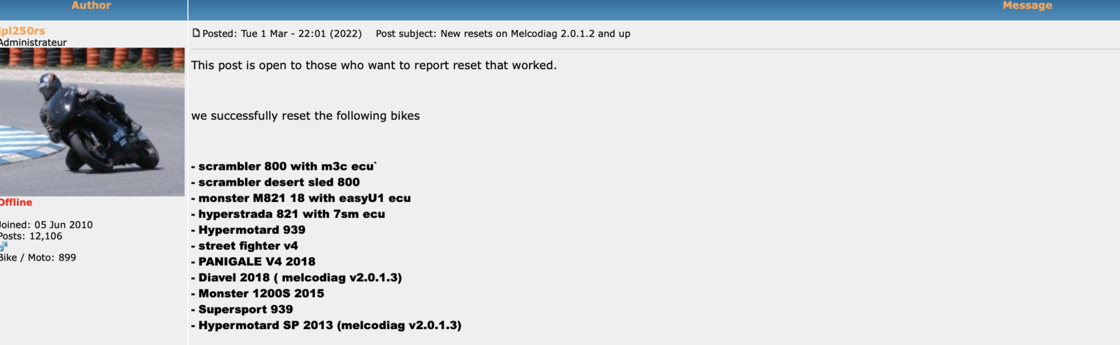

  6. The latest version of Melcodiag works for the 1200 Monster, the Supersport 939/950 and Scramblers with the Siemens ECU and a few other of the more recent bikes. I cleared the service light on my Supersport last week and on my Scrambler a couple of months ago when I got a version in the development stage.
  7. Thanks MJGT that’s the idea I had. The main thing is that I help the DIY community.
    These beautiful machines cost so much to own/service. If I can help those that want to do the work themselves but are limited by the accessibility of the electronics…then I’m happy.
  8. When did you download MelcoDiag? What version is it?
    I tried it a couple of months ago and it said my bike (2018 M1200s) was not compatible.
  9. I downloaded it last week, V 2.0.1.5. It covers Scramblers and Monsters with the M3C ECU with 696, 800 or 1100 engines as well as the Supersport and Monster 1200 (and probably M851) in addition to the Multi and Panigale models. I'd expect it will also work for the Hypermotard 939.
