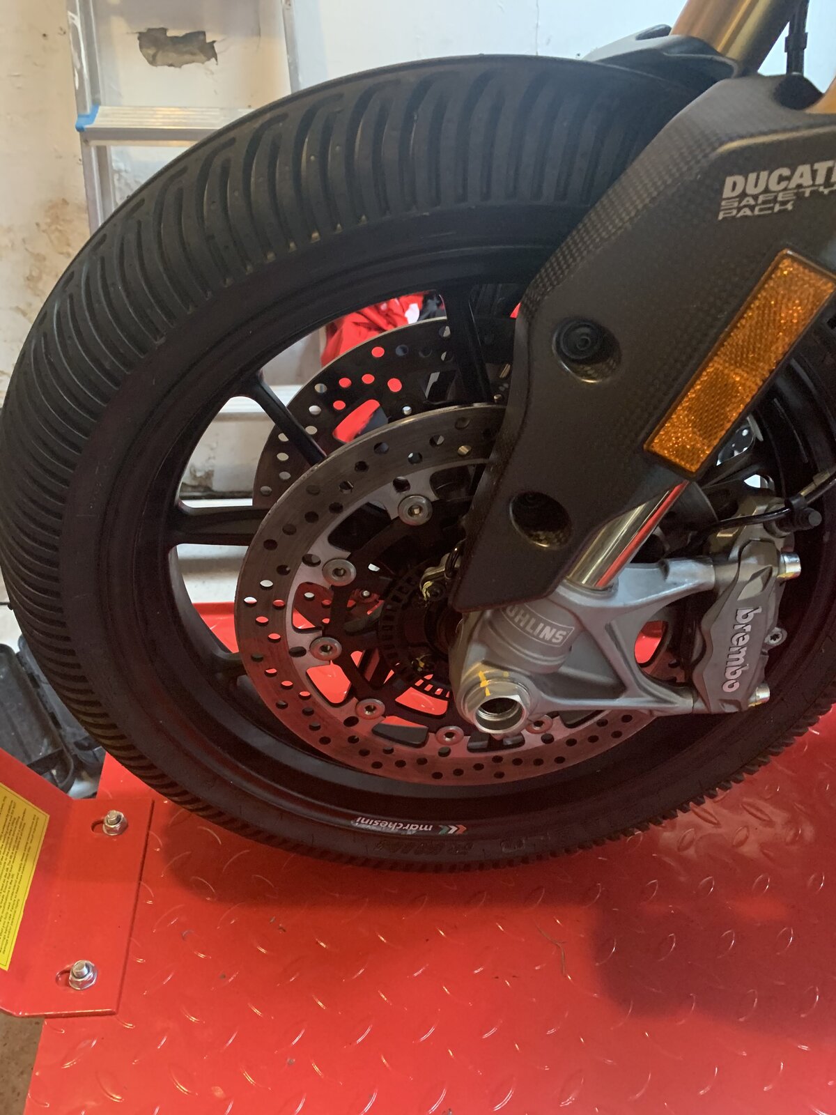

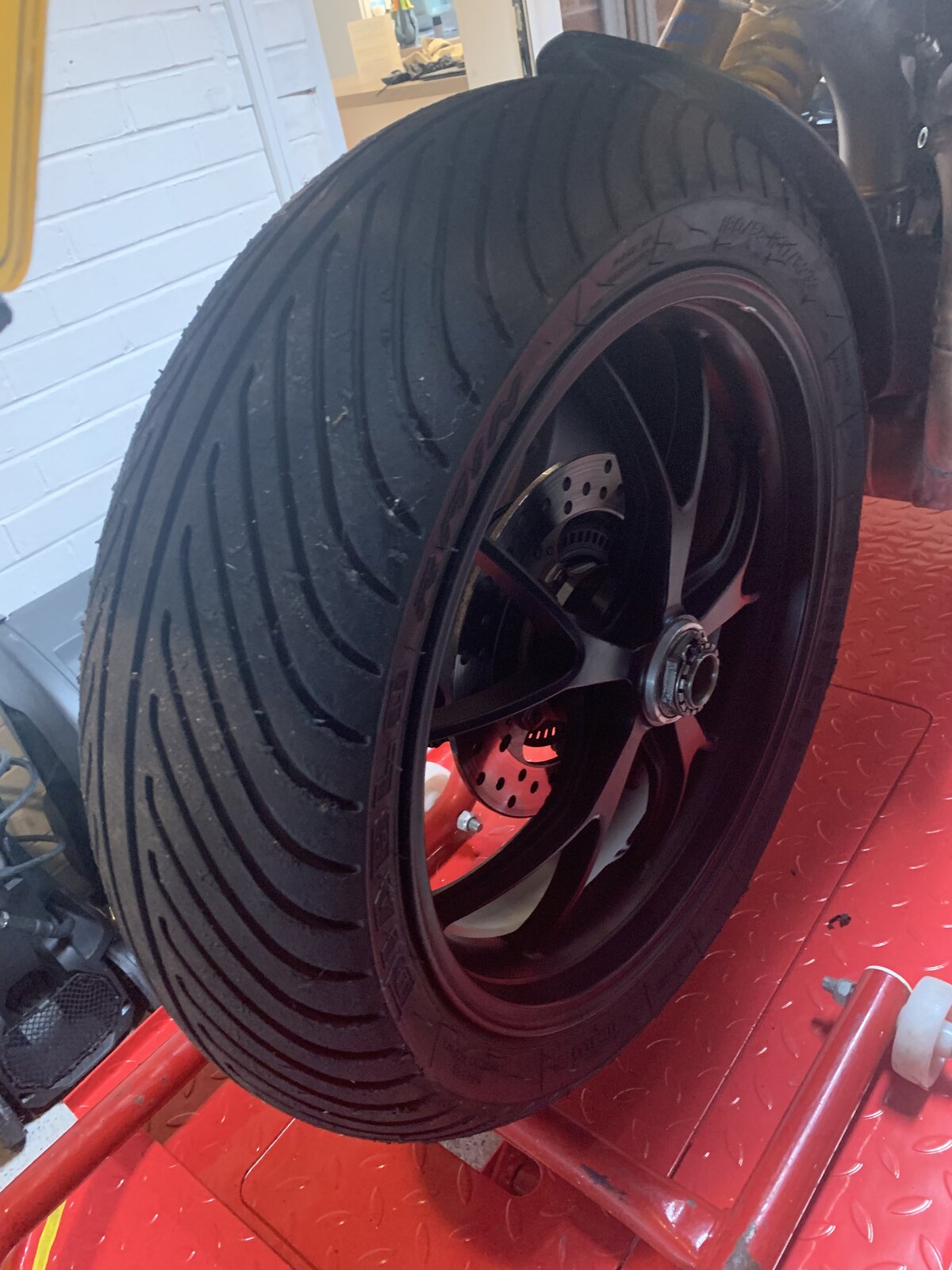

  2. 5104EF58-C7E2-432D-8B1A-EDF08C015CBB.jpeg 3B91BF46-D90F-411C-A5AD-C8352457644F.jpeg Taking the V4 to Silverstone on Weds but thought I’d fit wets to the hyper and take that as well just in case!

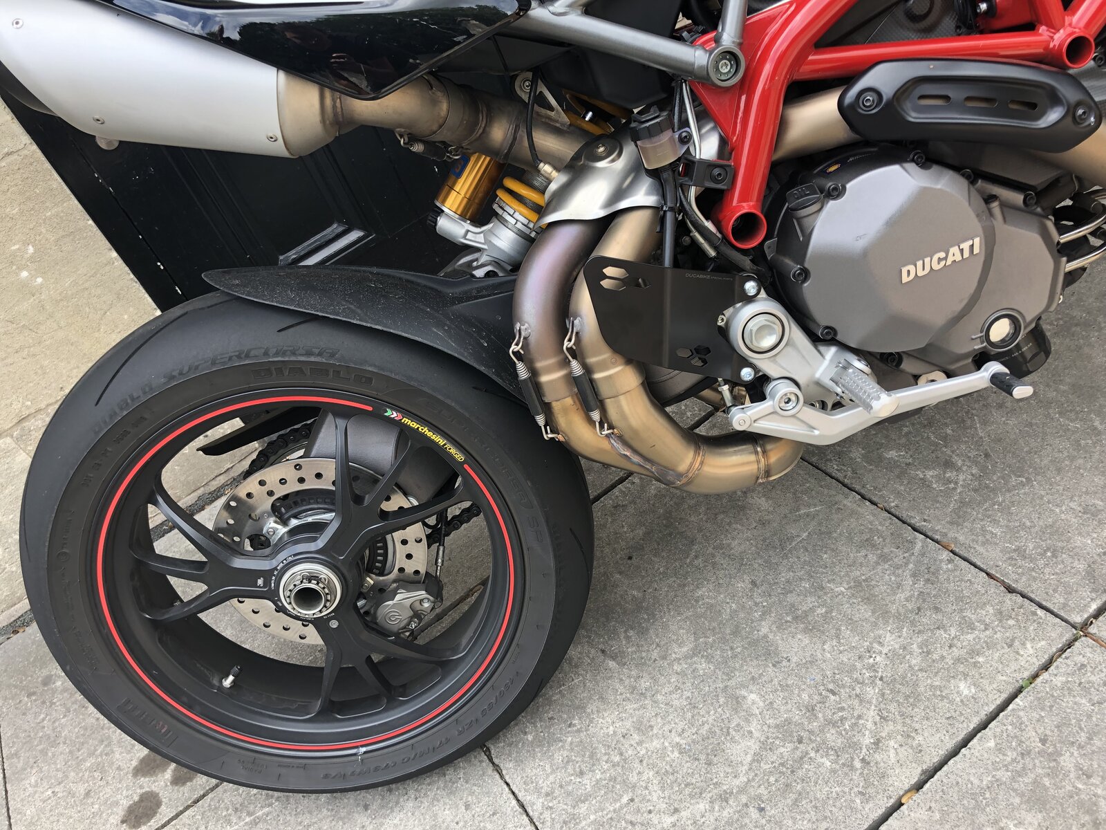

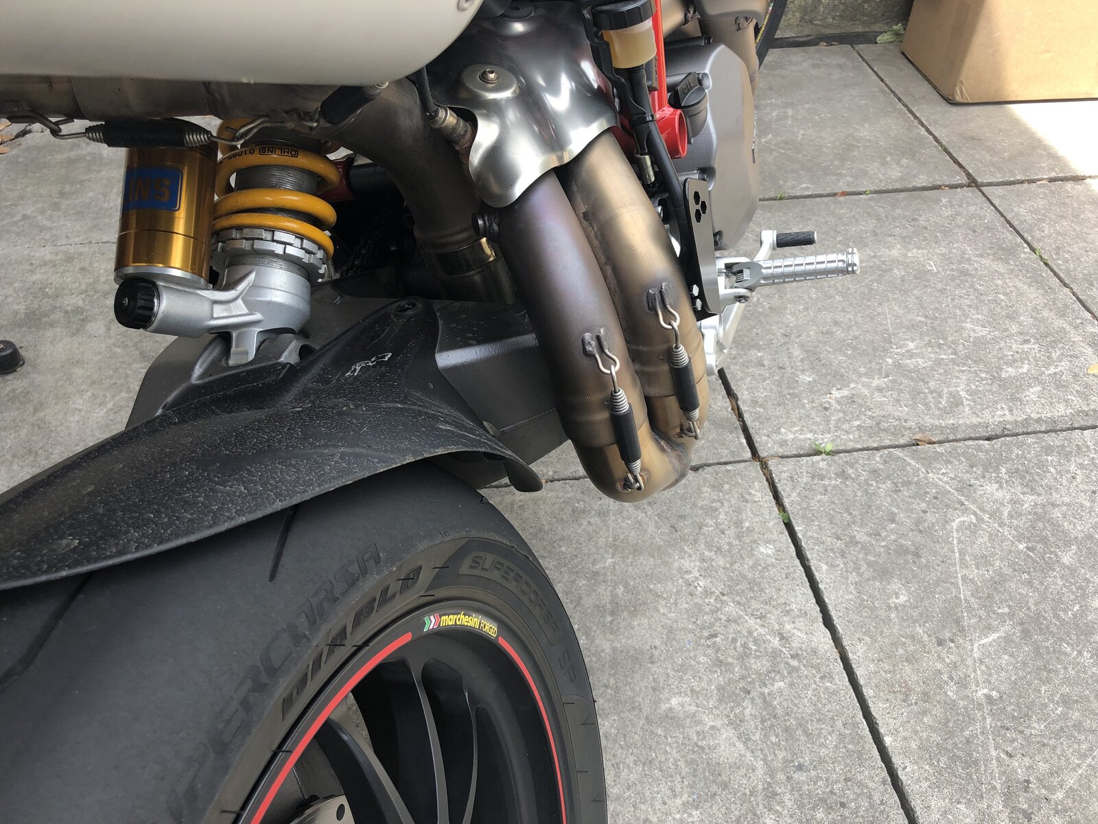

  10. Just got a new 950 and I love it! It had the termi slip ons on it (they were part of the deal) and they are no different then stock noise wise so I am interested in the arrow decat and maybe a booster plug. Any info on installing the booster plug on this bike?
    Also, for those that have done the decat and no other mods, does the decat improve off idle throttle response or make it softer? I think it's a bit soft in stock layout (sport mode) and wouldn't want it to be any worse. In other words did removing the cat and exhaust valve have a positive or negative effect on throttle response....especially off idle?
    #194 C RFan1, Aug 19, 2019
  11. I may have a boosterplug for sale in a few says as ive just ordered the upmap T800. Just deleting the exhaust valve got rid of a stumble the bike had at aprox 3000rpm and then the de-cat just wakes it up. The fueling is ok and i could live with it but it is a fair bit lean and will always suffer from euro 4 regs. Im hoping the upmap will transform the bike like the rexxer flash aparently does. I would of happily lived with the stock fuelling but i just like to fiddle. Check out the upmap T800 it was just released a few days ago
