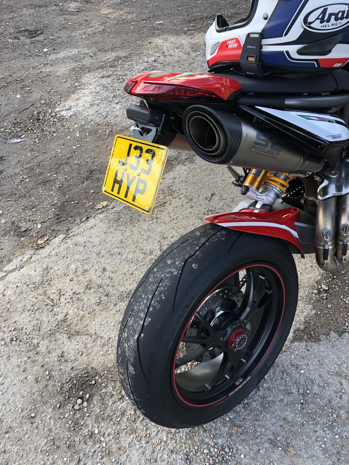

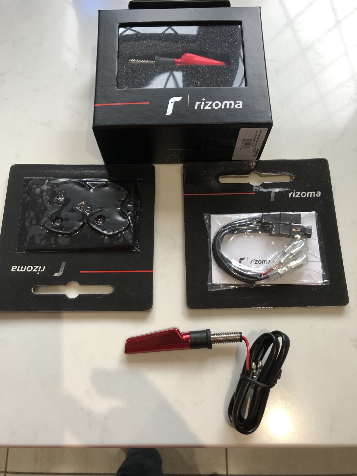

  17. Nearly completed installing/modifying my Tail Tidy, just shortening the wiring loom now and then fitting my Rizoma indicators. HVf9YhqmRMC6wF4b8ws7Og.jpg ZwghSv8ZQDiOfKhw4KkXOA.jpg
  18. @Hatrick That tail tidy looks the bollocks dude.. did you make it yourself or mod one that you bought?

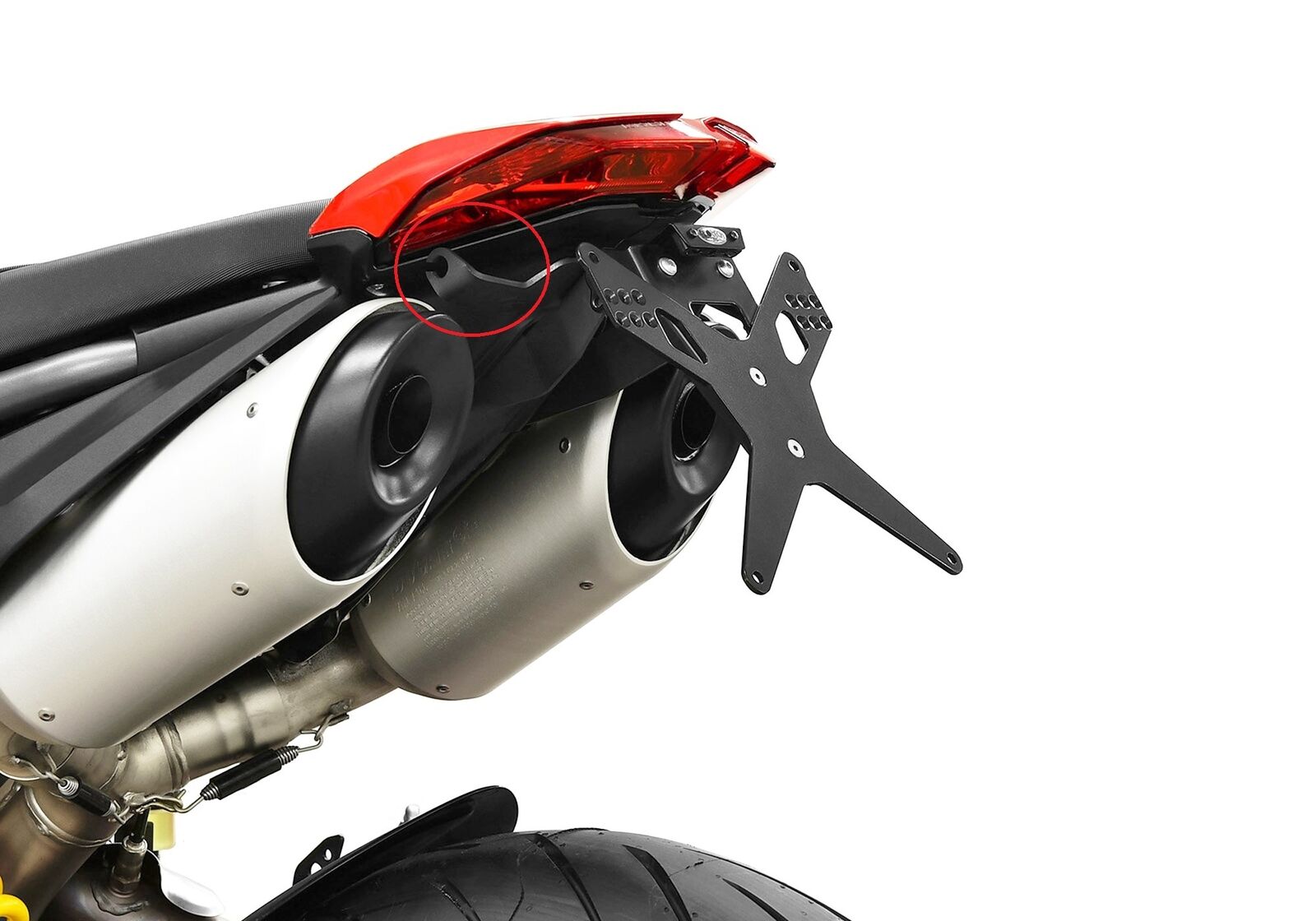

  19. Thanks - yea, I'm really pleased with the end result. Will put up some more pictures when I have fitted the bracket with the indicators. Not happy with any of the tail tidy's out there - they all hide the exhausts, so decided to buy this one and do some modifications. I removed the top two parts of the 'cross' (the bits with the 12 counter sunk holes)and mounted the number plate on just the lower half, this meant the plate would be below the exhausts. The supplied indicator bracket is supposed to go at the top, above the exhausts but doesn't fit so this is being mounted 2/3's of the way down the number plate - pictures to follow. The supplied number plate light didn't mount properly either so found a new old stock one on ebay from an older Hypermotard, think it should be ok once wired in. I'm in the process of shortening the stock tail loom as there isn't room for it all as its so much closer/shorter. So a fair bit of drilling, cutting, filing and counter sinking but I think I'm almost there! s-l1600.jpg

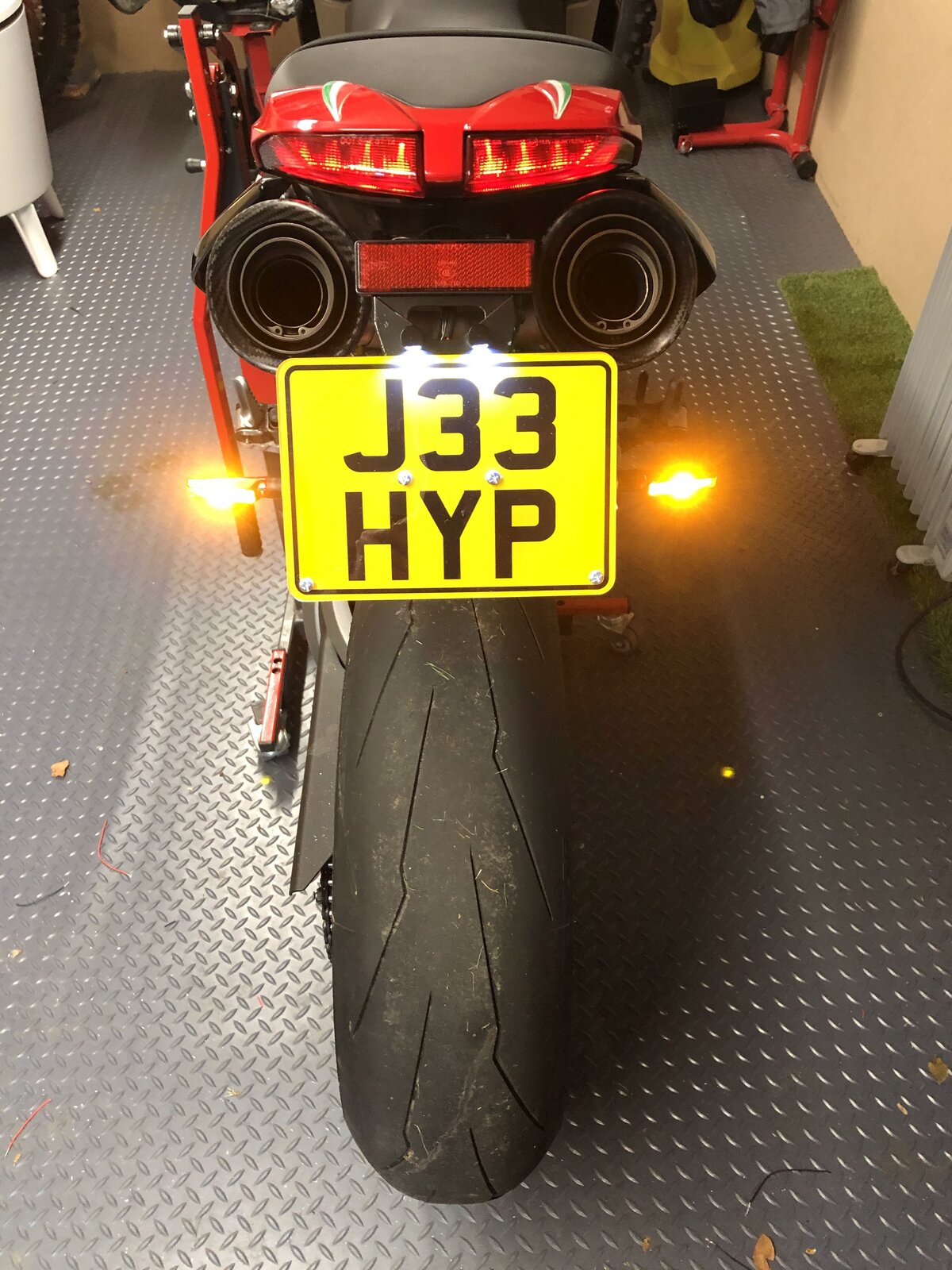

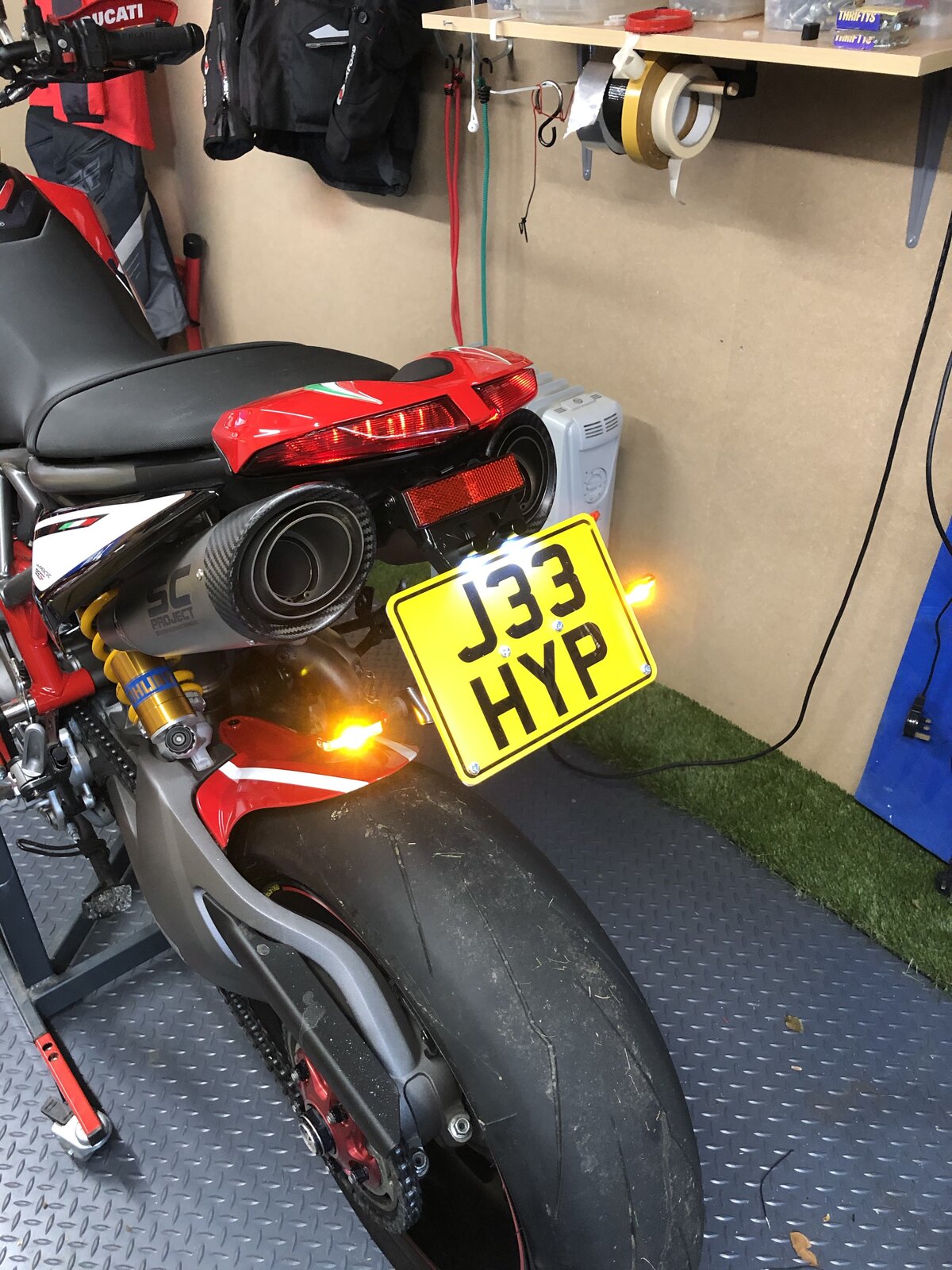

  20. Finished my tail tidy today - very pleased with the result. Number plate below the exhausts although I did fit a sheet of Aluminium behind the number plate - just in case of heat. Rizoma indicators superb, very bright. Decided to change the number plate light for two round LED lights - much better. %YJ65+xcT8aV6%1tCcSffg.jpg JfgNbKTdTCas0pQXanRvQw.jpg
