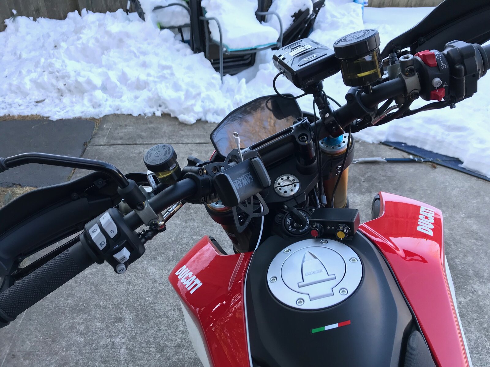

  4. 3 ft. should be plenty. It is 24 inches in a straight line port to handlebars. Add a foot for some slack .
  5. Thank you, at least now they added the usb port.
  6. Picture of a standard iphone 3 ft cord installed. Works fine. Power to USB port is on USB cord.jpg only when key is on.
  7. Thank you. I think if I run it along the frame I may need at least 4 feet. I want to hide the cable along the frame behind the side panel so that it is well hidden.

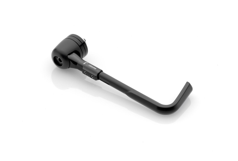

  10. The handguards on the 2019 Hyper are just cosmetic. They are flimsy plastic and scream wanna be. A Shame they are not a robust functional piece.
    This is a mod that must be done.
    The Rizoma Proguards look like a great idea. Bar end adapter is also needed.
    https://www.revzilla.com/motorcycle/rizoma-proguard-system-street-edition

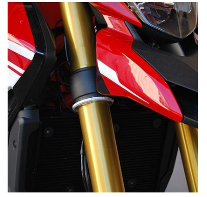

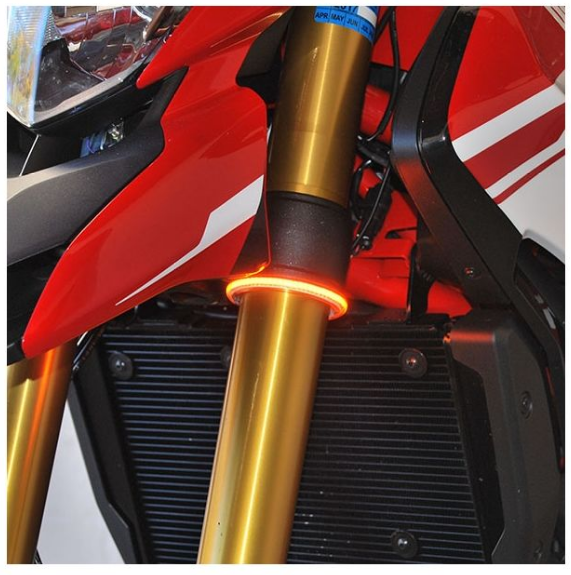

    I like the look of new rage cycles 360 degree fork mounted LED signals. They are a bit ugly when unlit:
    https://www.revzilla.com/motorcycle/new-rage-cycles-rage-360-turn-signals?rrec=true

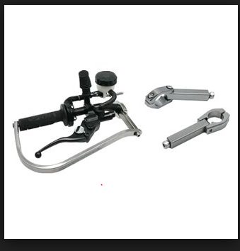

    Another option for a functional handguard with LED:
    https://soloracer.com/zetahandguard.html $143.95 for full metal handguard, proper protectors with integrated LED signals. Very dual sport in looks, and offer lay down protection that Rizoma may not.
    https://soloracer.com/zetaproguards.html These are the pro version. You will need long brackets to clear the control levers.
    https://www.motorcycleid.com/zeta/armor-handguard-replacement-clamp-mpn-ze71-1613.html
    https://www.langston-motorsports.co...rs-for-armor-hand-guards-with-orange-flashers
    https://www.langston-motorsports.co...rmor-bend-hand-guard-with-clamps-complete-kit
    Some additional product videos.
    https://www.youtube.com/watch?time_continue=2&v=mTGhua8lE-U
    https://www.youtube.com/watch?time_continue=13&v=1XrPMy5pl8I
    I went ahead an ordered a set of Zeta guards with integrated LED signals, long clamps. I will let you guys know if it fits and attach some pictures. rizoma proguard.PNG new rage lit.PNG New Rage unlit led.PNG Hyper with Zeta.PNG Zeta setup.PNG

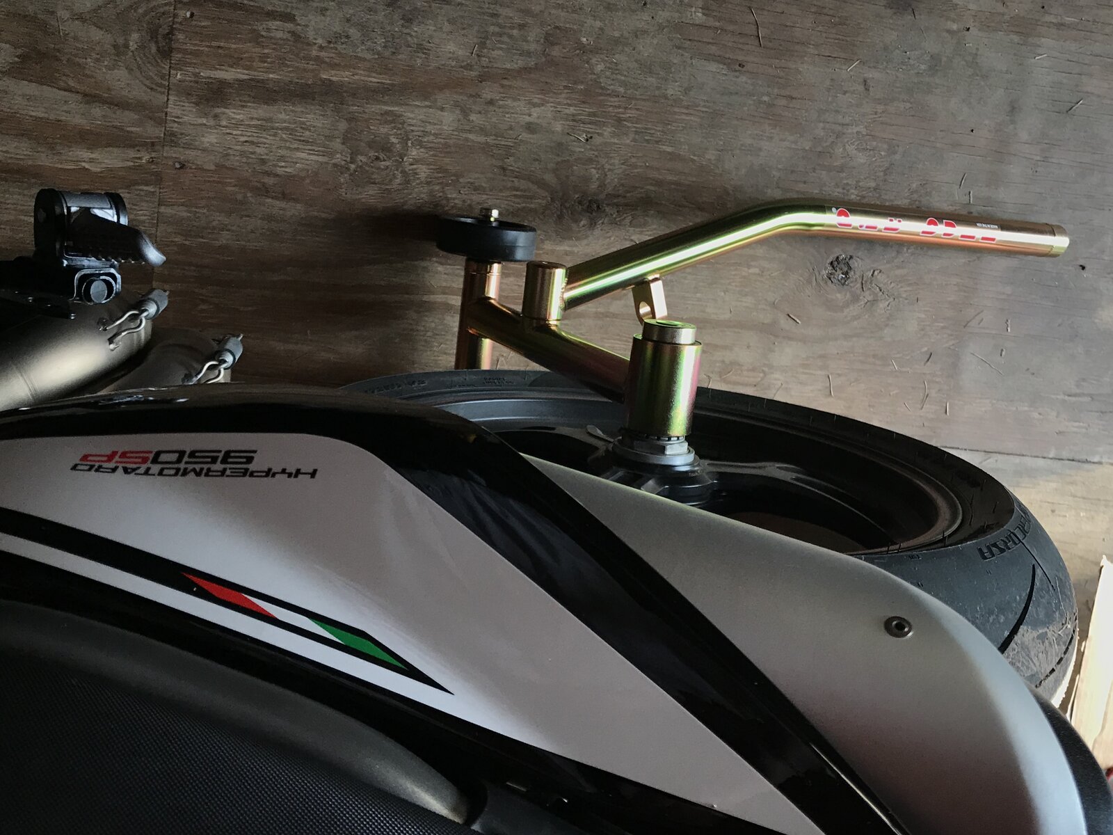

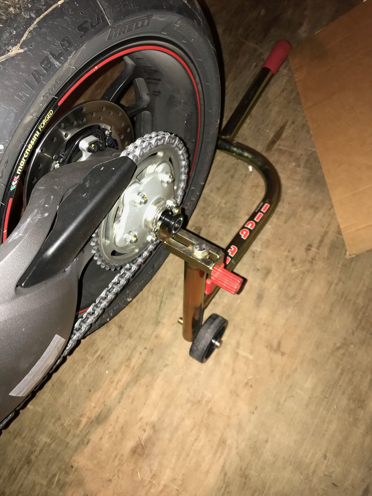

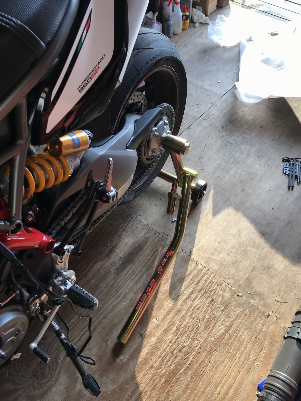

  11. The existing pit bull Hypermotard stand fits on the new Ducati Hypermotard 950SP, both sides. See attached pictures.
    The only issue is that on the drive side, with handle forward, the kickstand is in the way. The kickstand must be lifted up or the pit bull handle will blocked and not move freely to the floor. Once the bike is secure, the kickstand can be lowered if need be, but then must be raised again to lower the bike to the floor. pit bull drive side.jpg Pit Bull non drive side.jpg

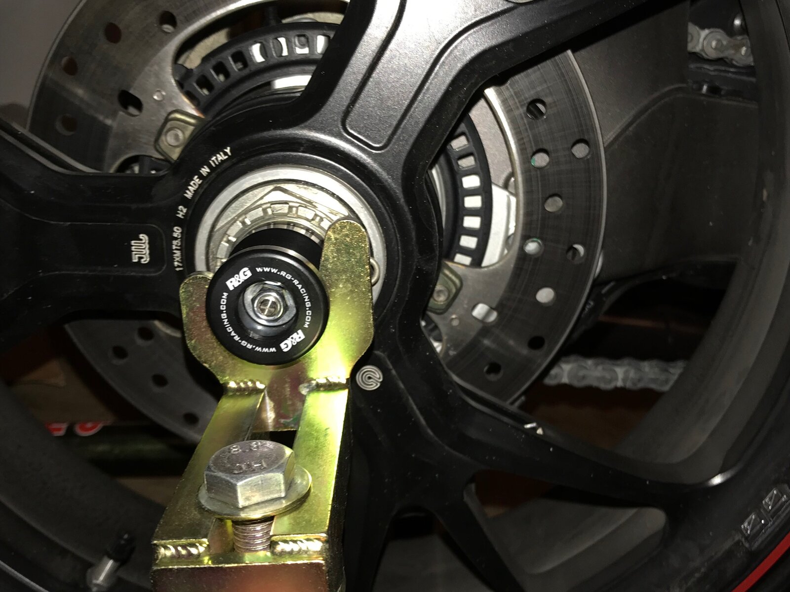

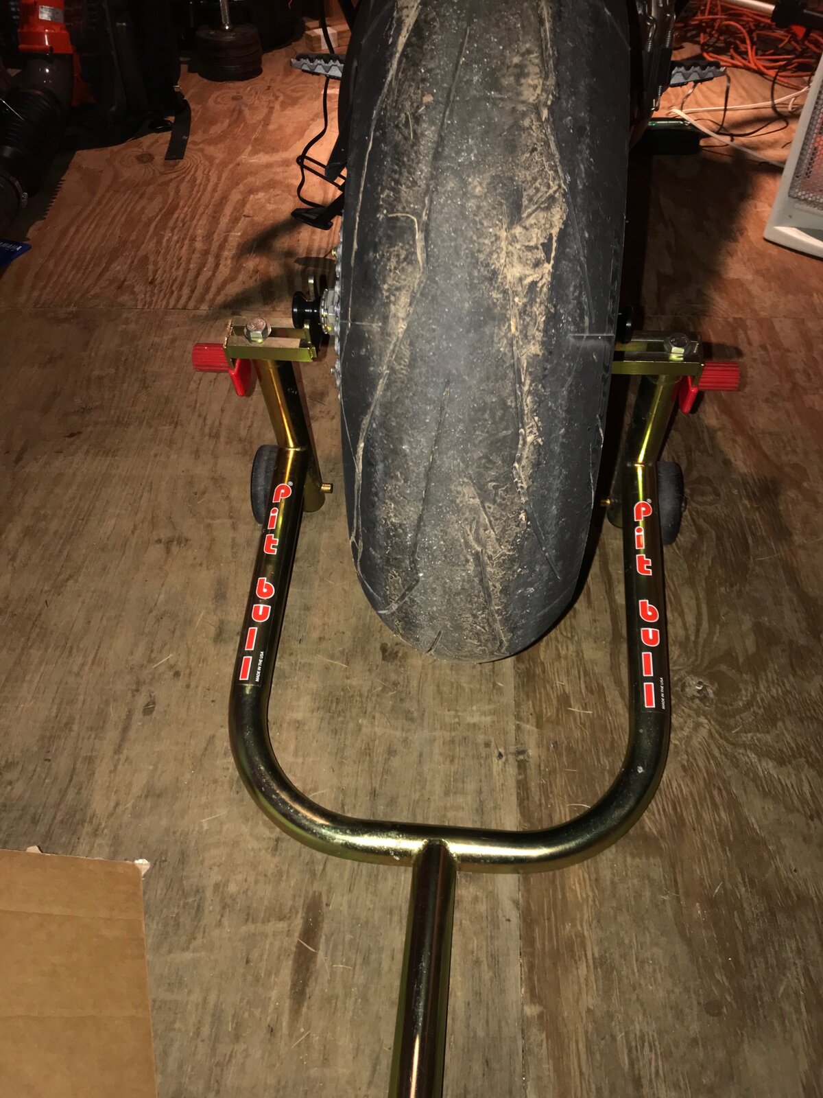

  16. Installed R&G Rear Axle Spindle Sliders (SS0037BK). They also serve to allow for a standard swingarm paddock stand which is more stable than the single sided stand.
    Single sided stand is still needed for tire removal.

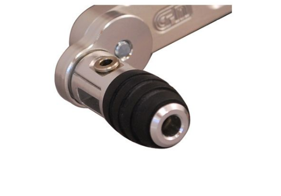

  17. Thinking of putting this piece on a perfectly fine rear foot brake lever, cutting off the existing toe pedal extension, just to have the folding ability in case of a drop, and it allows for easy adjustability of toe position. I find it hard to apply full pressure to the rear brake, it requires to much downward movement of my ankle, this will raise the pedal as well and make it more neutral. I could always just adjust the lever with the existing hardware in place. Not sure what I will do yet.
    https://www.revzilla.com/motorcycle/woodcraft-eccentric-folding-toe-piece?rrec=true Woodcraft eccentric folding tip.PNG
