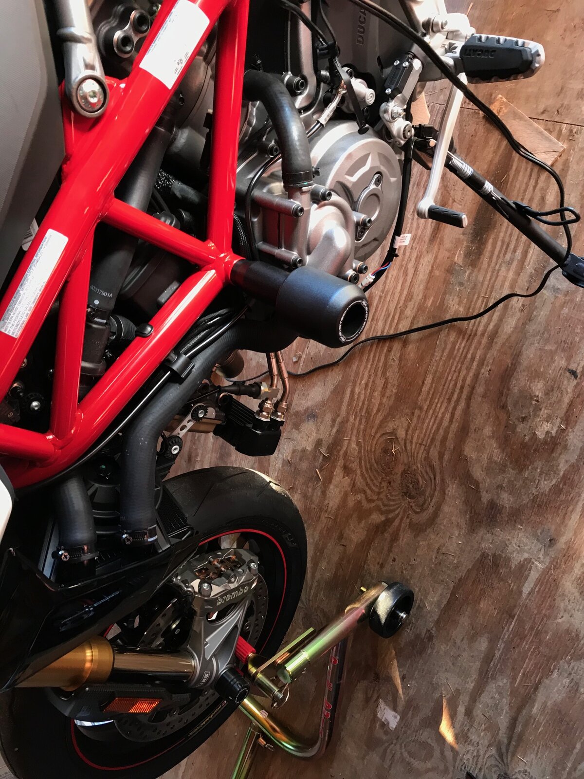

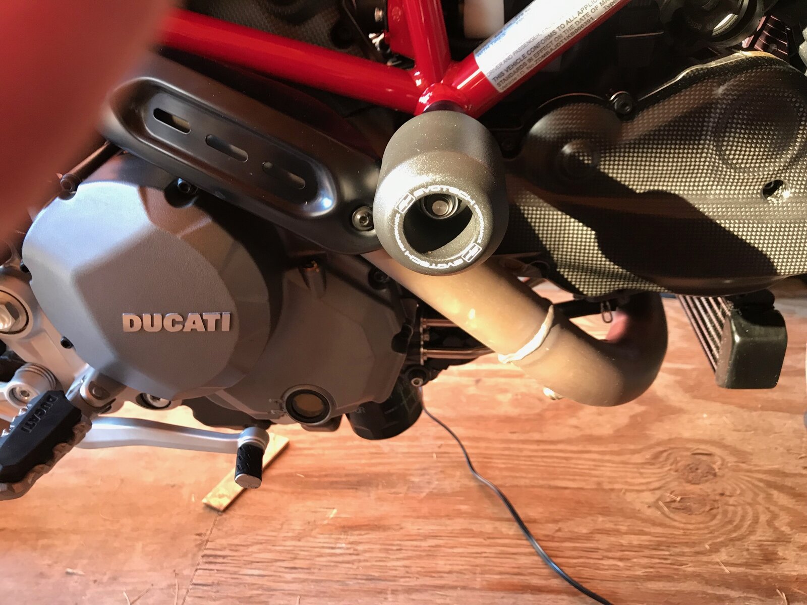

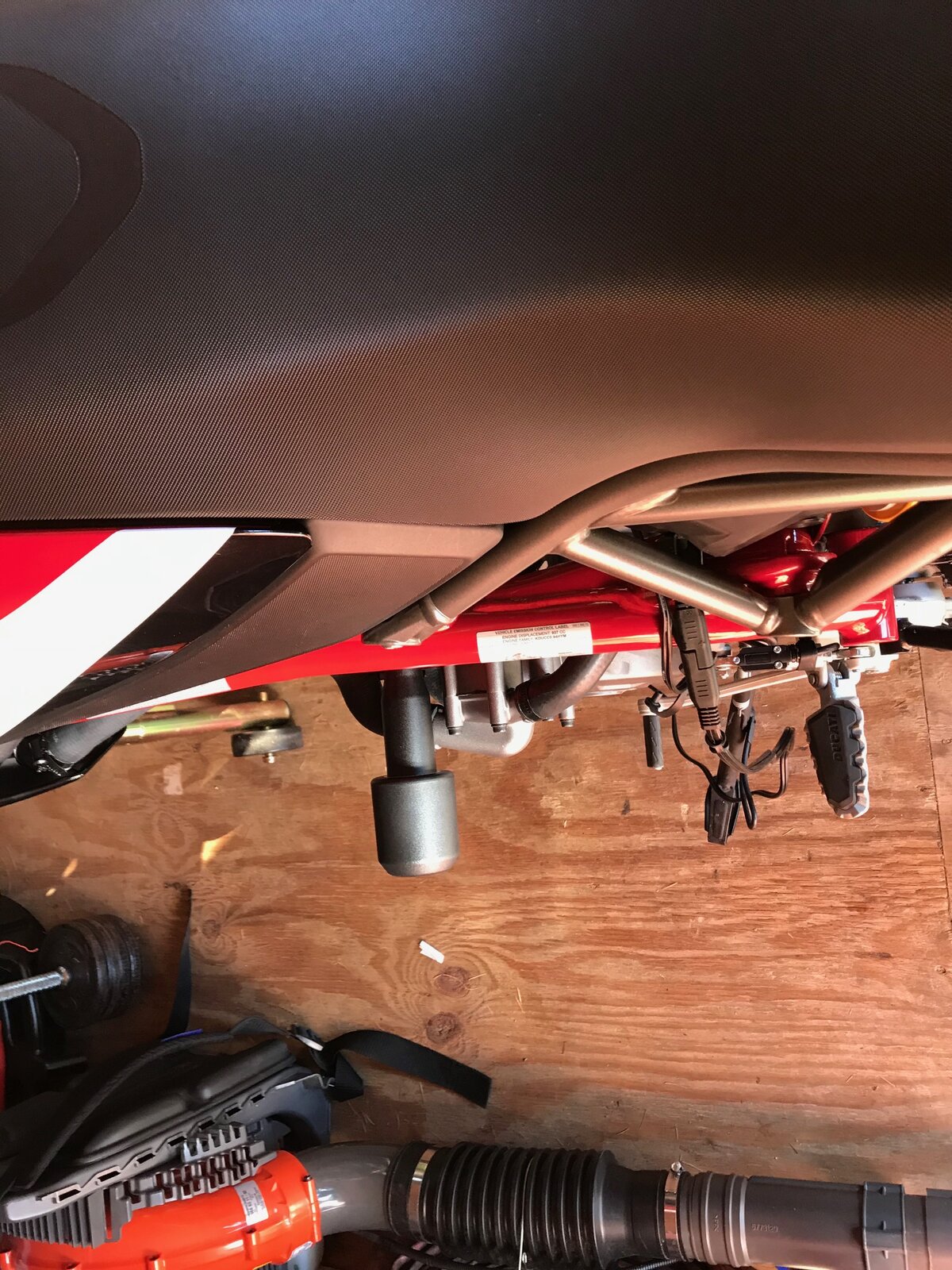

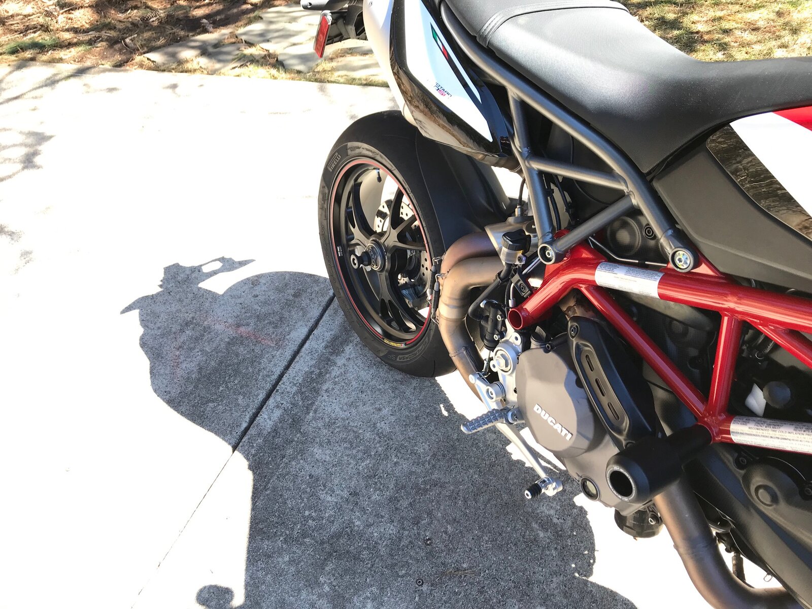

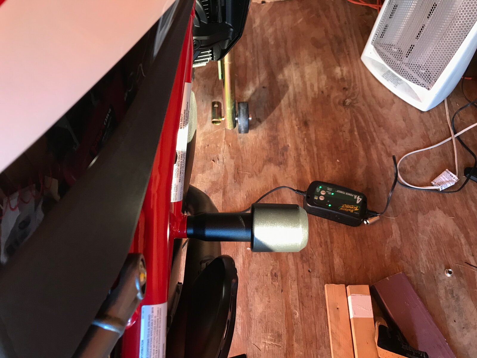

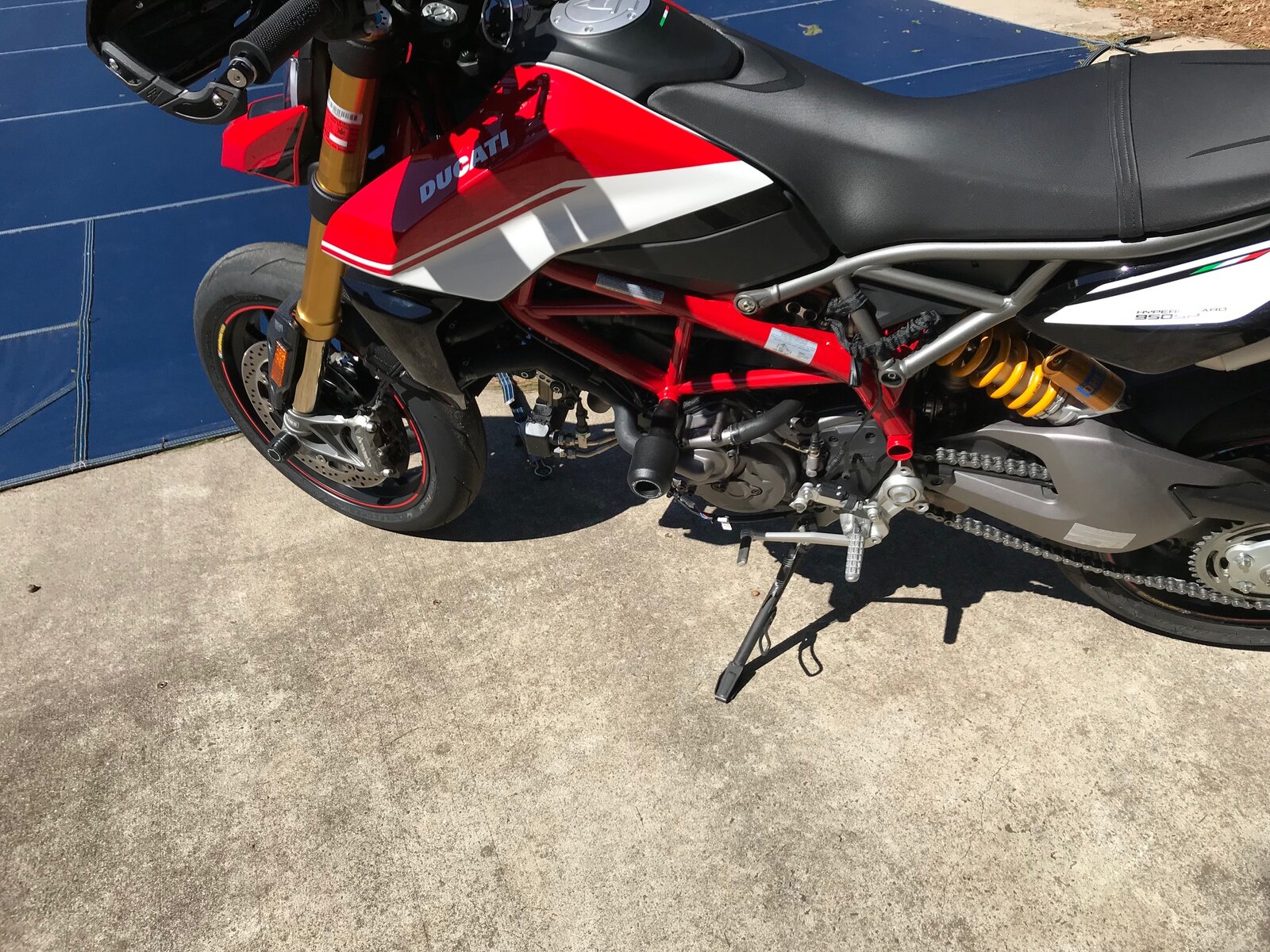

  7. Installed the Evotech Sliders.
    Support the engine from underneath when you slide out the OEM bolt and slide in the Evotech bolt.
    Once the OEM engine bolt moves out of the hole on one side, the engine can sink within the frame and lose alignment with the frame holes.
    To prevent that, you drive out the OEM bolt from one side by inserting the Evotech bolt and driving out the OEM bolt.

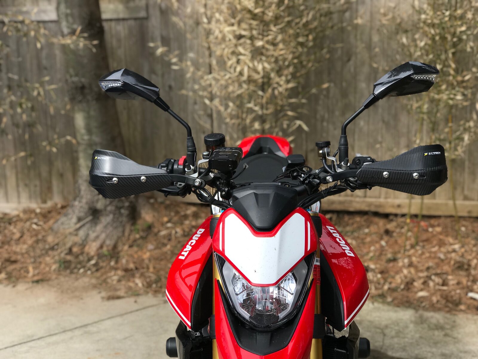

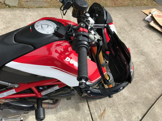

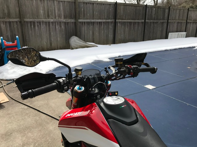

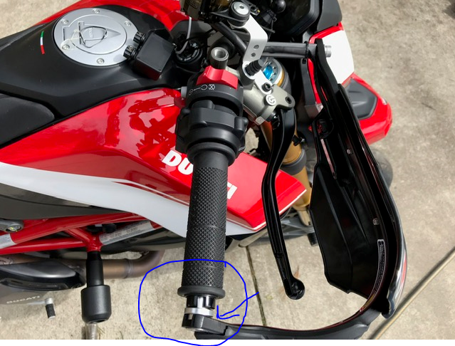

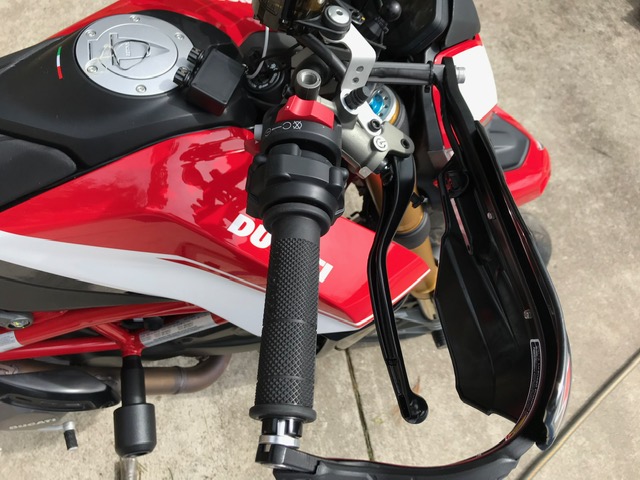

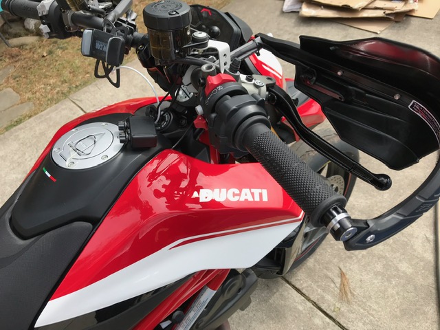

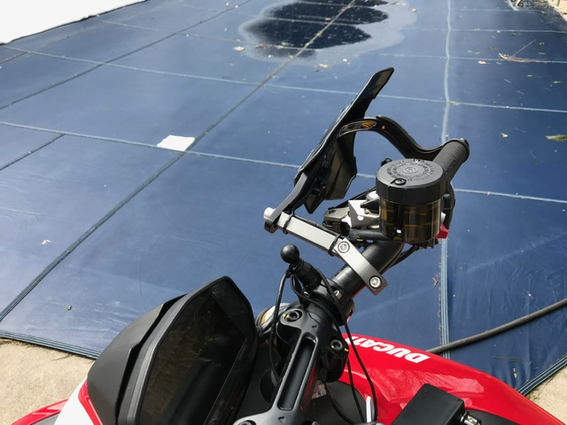

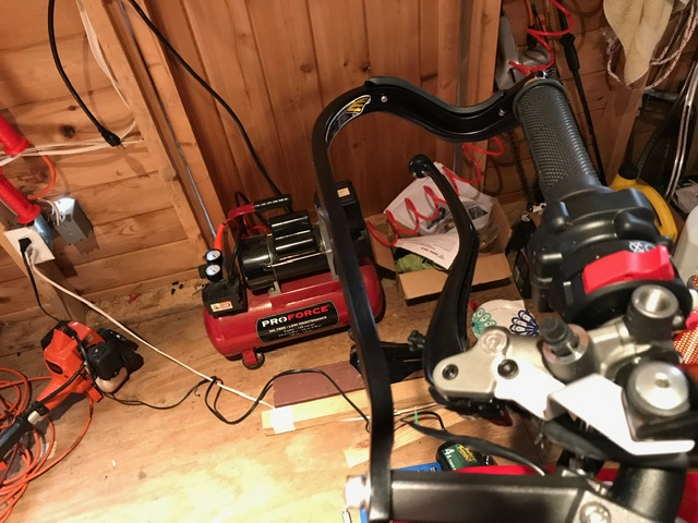

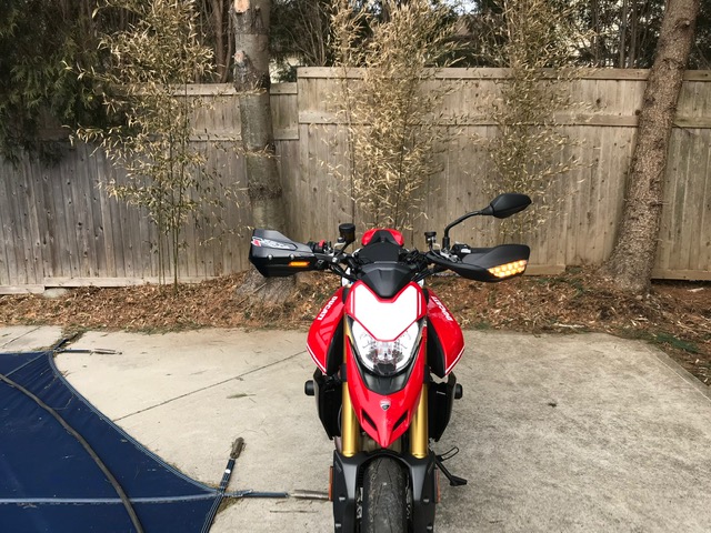

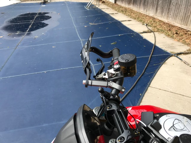

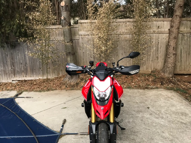

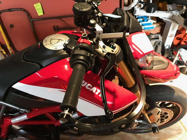

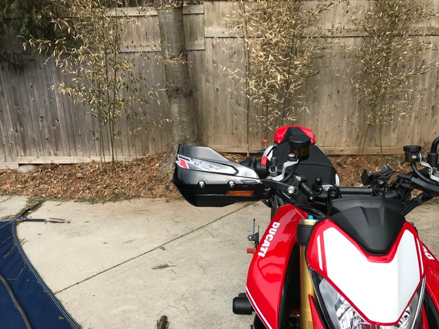

  9. IMG_1224.jpg Installed Zeta Pro Guards with integrated LEDs on the right side.
    They require the extended brackets to clear the master.
    Fit on the bar end is not perfect due to the torque placed on the natural bend of the aluminum guard bar, required to fit the hyper. I will play with that a bit more for a more perfect fit.
    The LED directional indicator is not even close to being as bright as the stock. Not a deal breaker for me.
    The actual plastic of the guard is glossy black and not pretty to look at. I have some Ducati decals on order which I will apply to dress it up.
    Overall I am happy with it because it should offer actual crash protection. The structure is solid and should save components in a slide.
    IMG_1212.jpg IMG_1213.jpg IMG_1224.jpg IMG_1217.jpg IMG_1225.jpg IMG_1227.jpg IMG_1228.jpg IMG_1230.jpg IMG_1233.jpg IMG_1234.jpg IMG_1235.jpg Gap.PNG

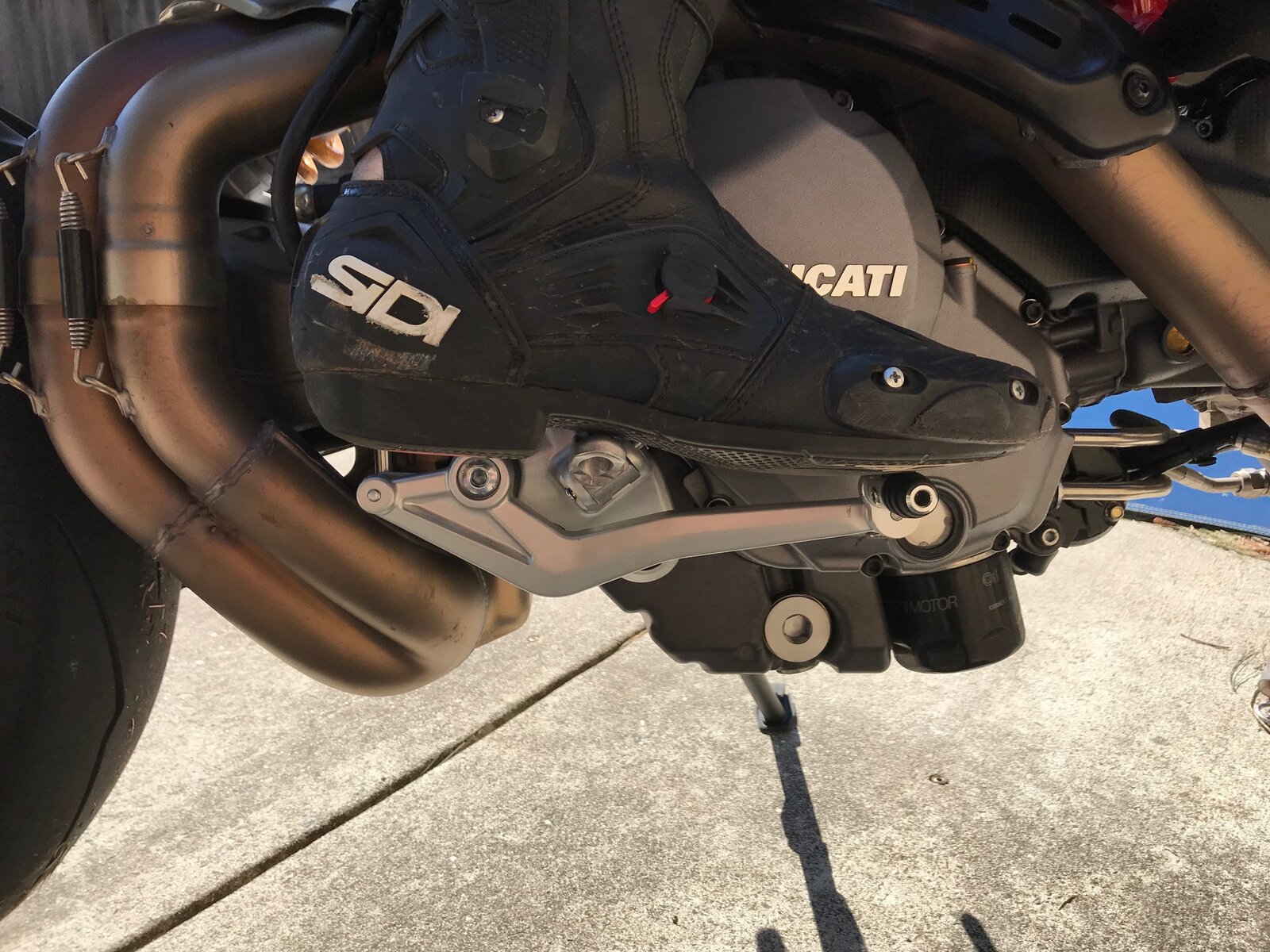

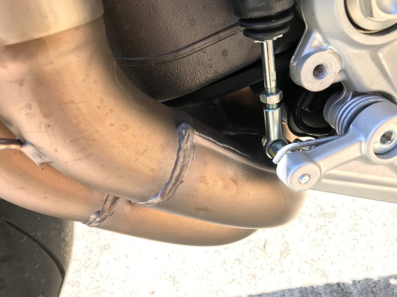

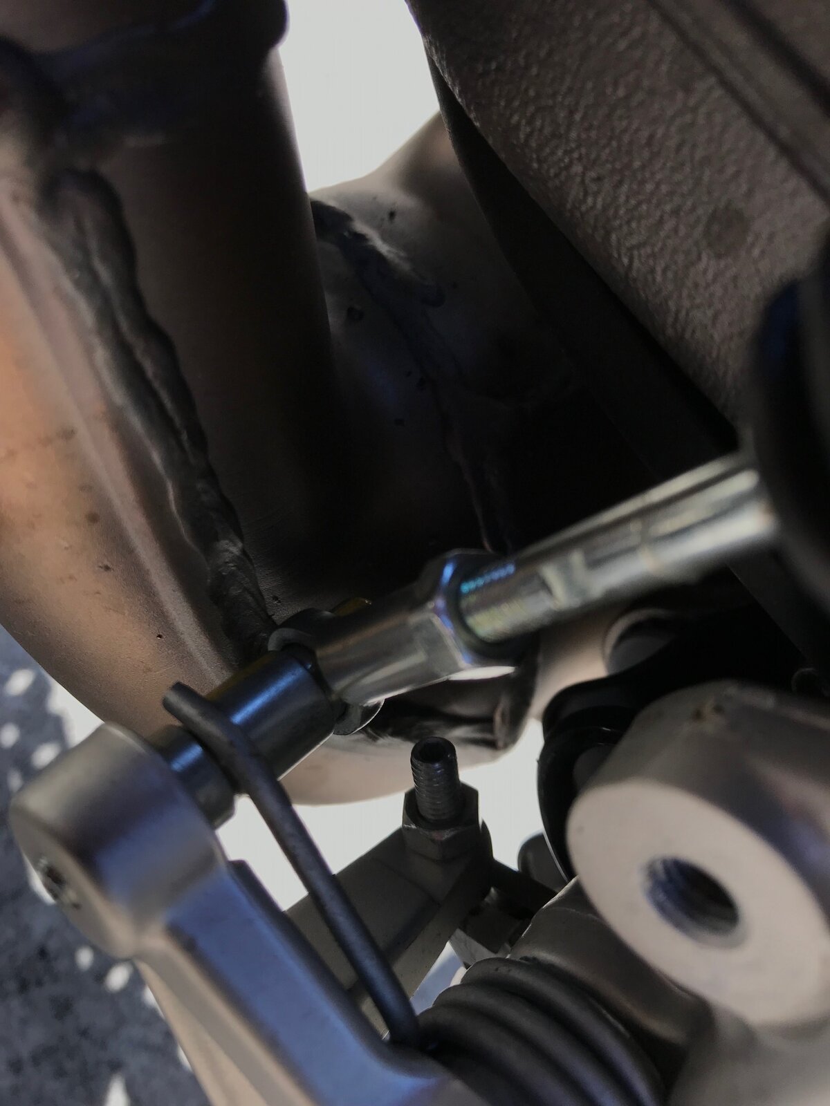

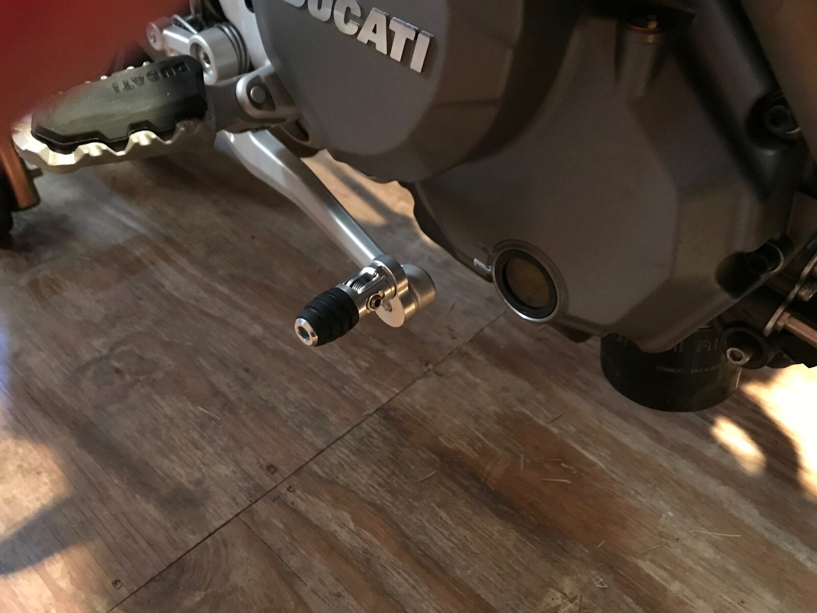

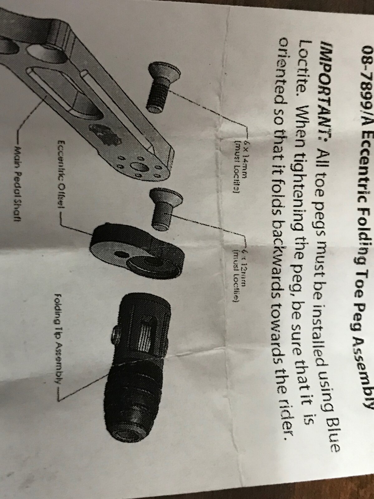

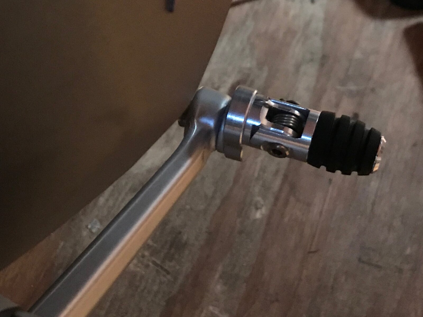

  11. I found it hard to reach the rear brake toe piece to apply adequate braking force.
    The stock lever has some limited height adjustment. I maximized brake pedal height using the set screw, and I turned out the brake master pushrod a full 7 turns to max the engagement of the rear brake to occur as soon as possible with pedal depression. (see pics )
    I went the woodcraft eccentric folding toe peg route to modify the brake lever.
    https://www.revzilla.com/motorcycle/...ding-toe-piece
    This mod was pretty easy to do. It allowed me to find the perfect position for the toe piece, and will fold rather than bend or break in case the bike goes down.
    The woodcraft toe piece is mounted with a single bolt through the brake lever. It also has a positioning pin, so in addition to cutting off the stock toe piece and drilling out a primary mounting hole, I had to drill another small hole for the positioning pin.
    Looks OK and solved my ergonomic issues. The toe piece is now both closer to and higher up in relation to the foot peg.
    I removed the passenger pegs and peg mounting frames and replaced the front pegs with the passenger pegs.
    Tricky on the right side because the clutch case prevents the pin from coming out.
