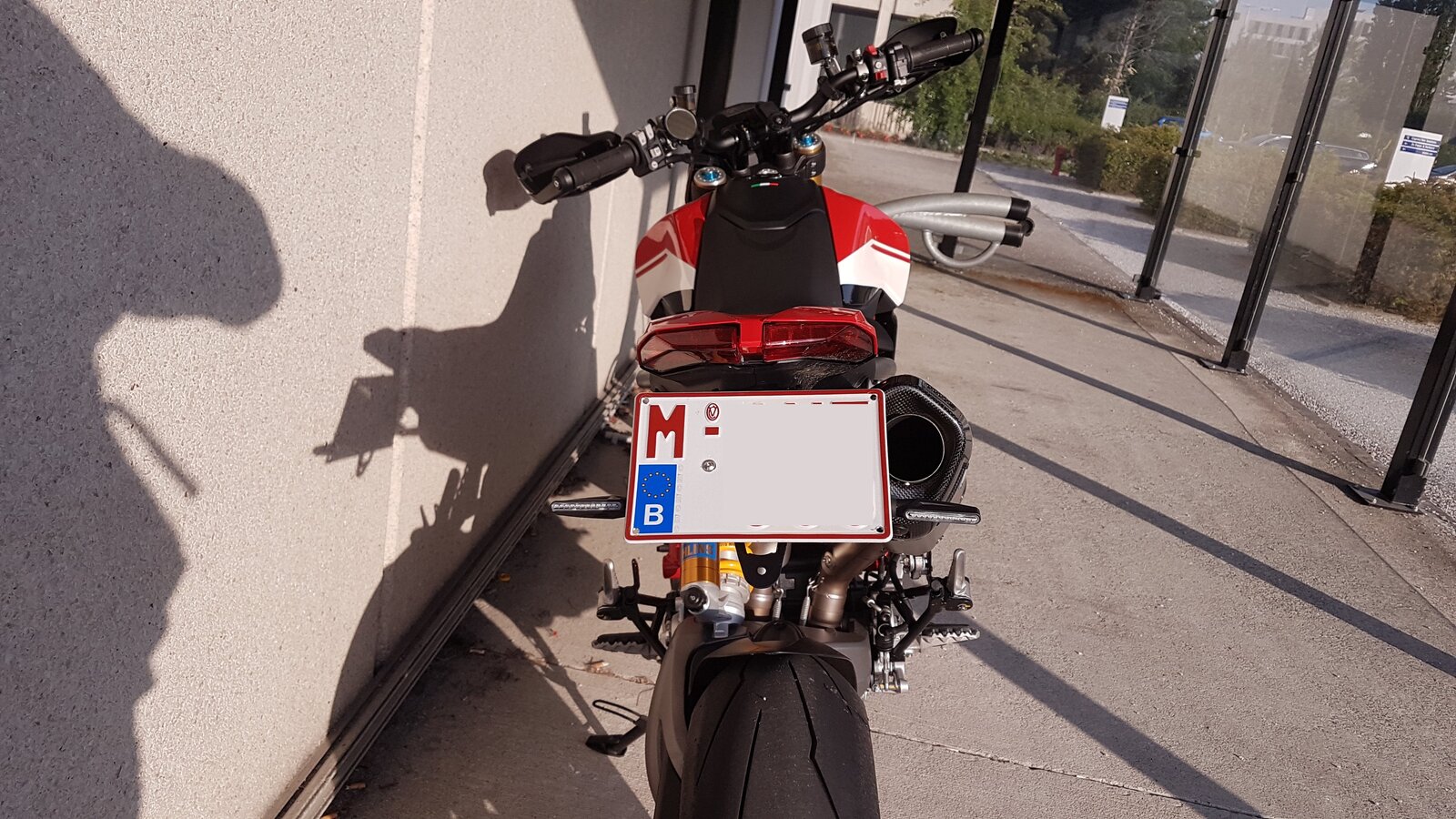

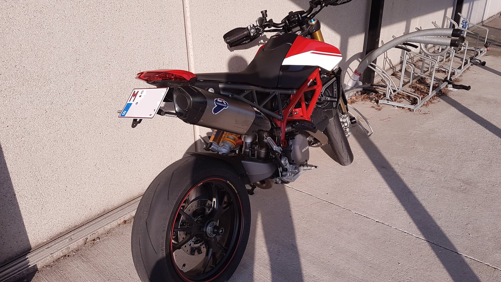

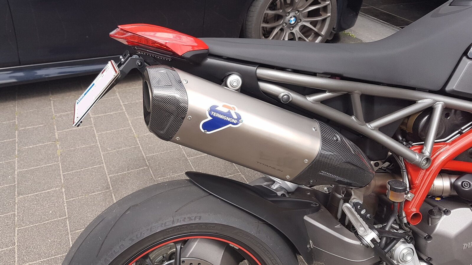

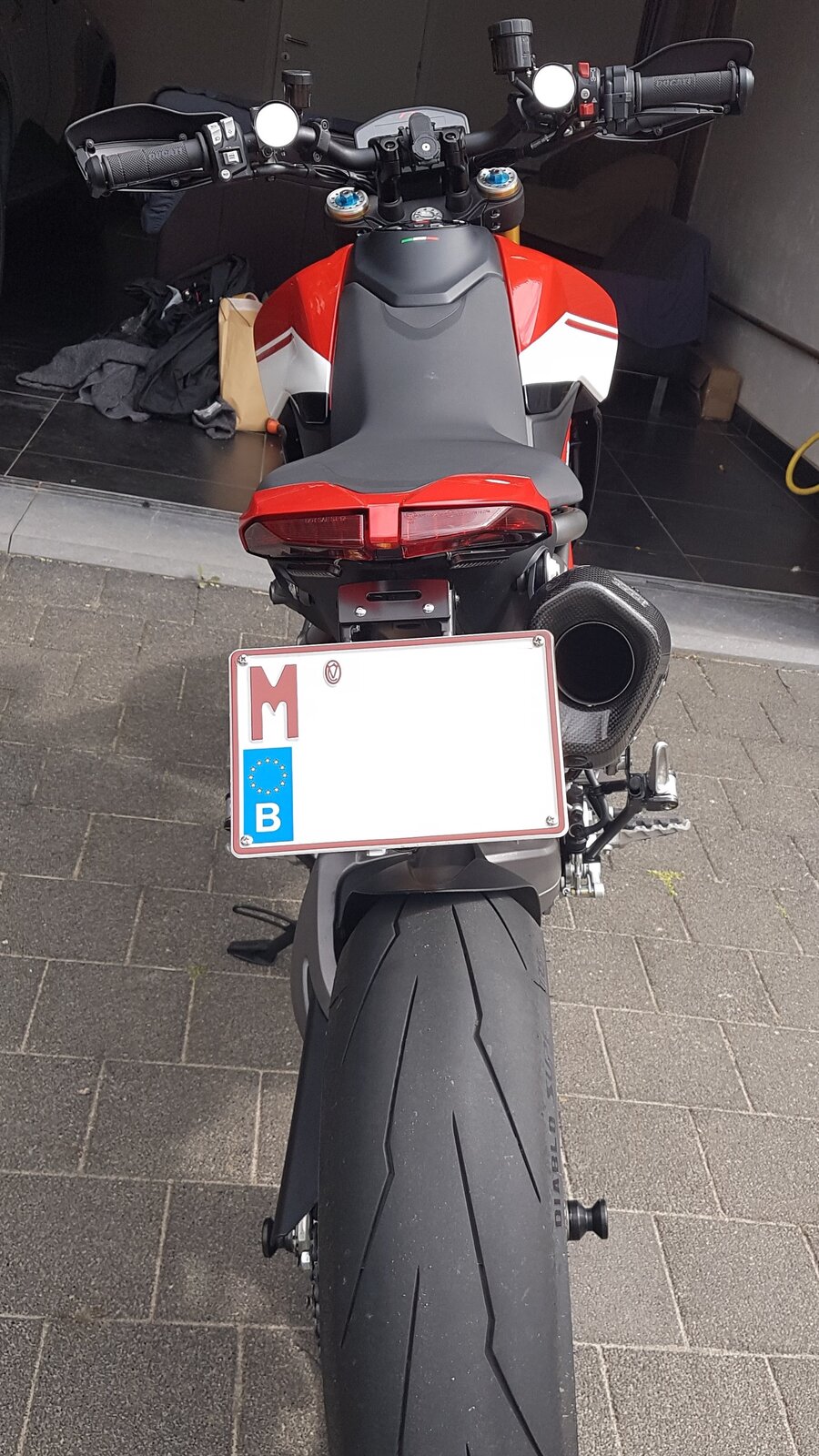

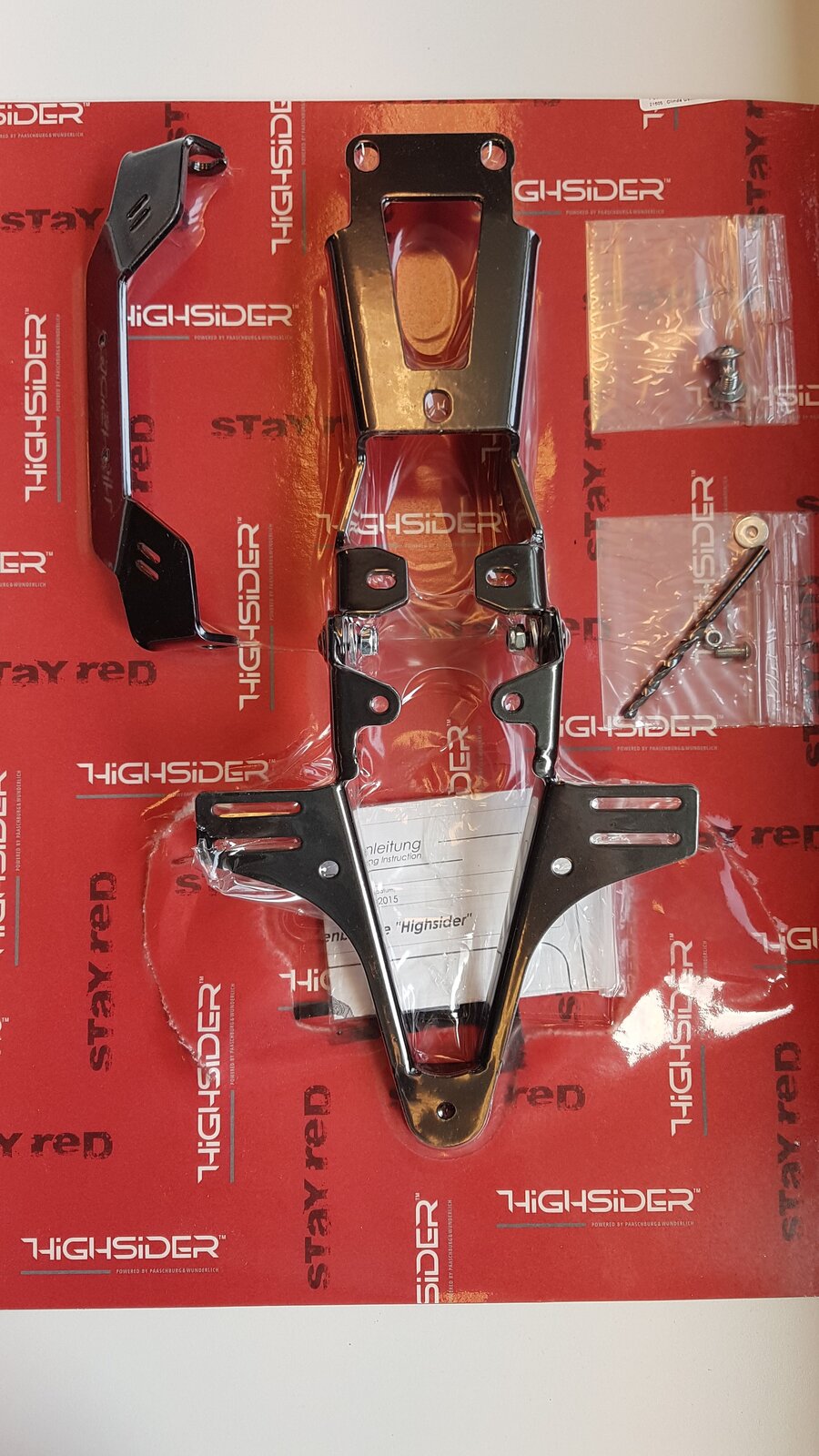

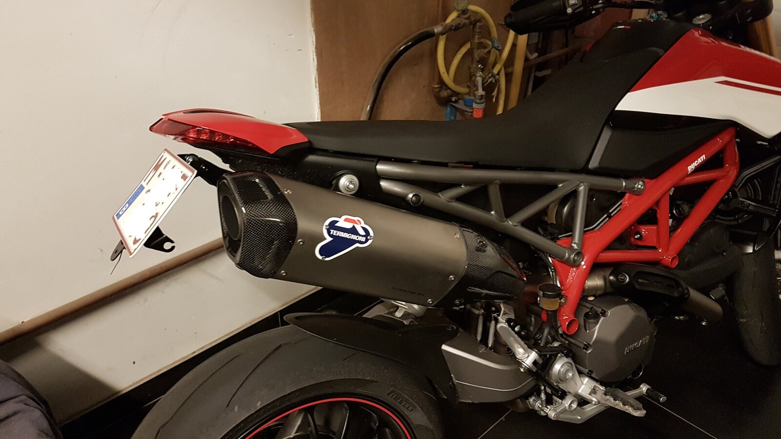

  1. I mounted a tail tidy from italo-shop fits good with the termignoni, but still need to do something with the signaling, it get hots. The bar where they are mounted now is tie strapped. I can't use the upper or lower postion where you can bolt it.. Hits the termignoni.. I have the mounting options for oem signals to but don't want to use them.

  4. Why is it taking so long for someone to knock out a full under seat system? Why have Termi not sorted anything out when they released the cans shortly after the bike launched? Needing to get shut of the full single sided systems first?

  5. I removed the signals from the ital-shop tail tidy and used some audi style cheap led strips..
    Replaced mirror by small bar mirrors.
    sadle strap under the sadle..

  7. How do you get on with those mirrors?
  8. I see everthing left and right under the arms when I need to change lane or take a turn and need to see bikes etc... can't see directly behind me
  9. Who makes them? I’d like to give them a try :)

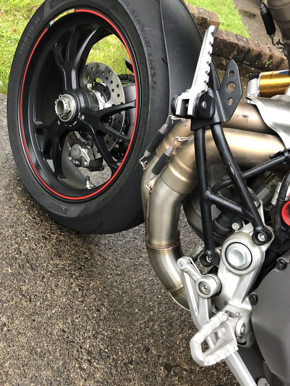

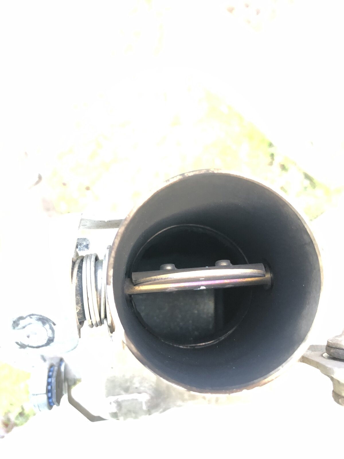

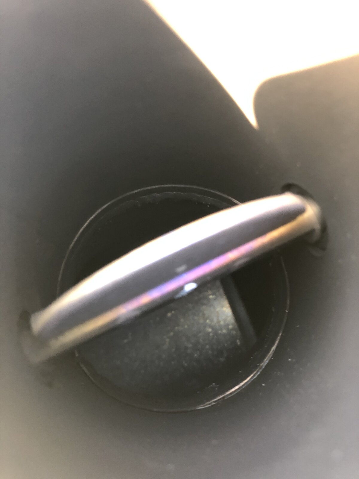

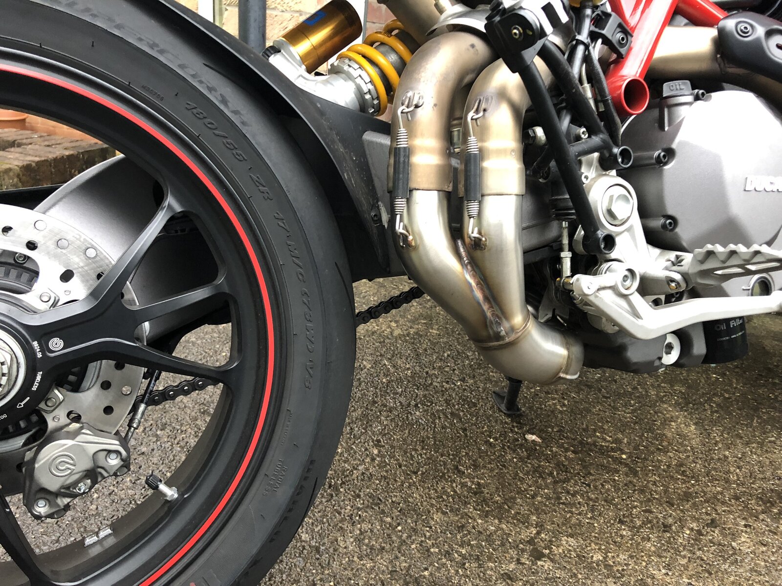

  12. My Arrow link pipe arrived! It weighs 1006g and the bits that have come off total 3131g (Catalytic converter 2785g the cable 70g and the exhaust servo 276g)
    So I’ve knocked 2.1kg off the bikes weight which combined with the lithium battery and the mirrors means it’s dropped roughly 5.6kg so far.
    The cat looks to be more restrictive than I thought it would so I think a quick dyno pull to check the fuelling might be in order, I’ll fit the link pipe over the weekend and ride it before deciding :)

  14. Yeah it’s on but I’ve had no chance to button everything up and take it for a spin yet, it sits pretty close to the swing arm so I was going to loosen the headers and fiddle about with it a bit this evening if I can make time. Its pissing down here :(
  15. I got everything tightened up this evening, it sounds a lot better to me having had a full Termi system on my 939sp...
    I fitted a Healtech exhaust servo delete so I can get my puncture repair kit into the space that the motor came out of if need be :)
    The link pipe sits pretty close to the swing arms rubber bung so we’ll see if this is a problem when I ride it as well as the fuelling, fingers crossed.
