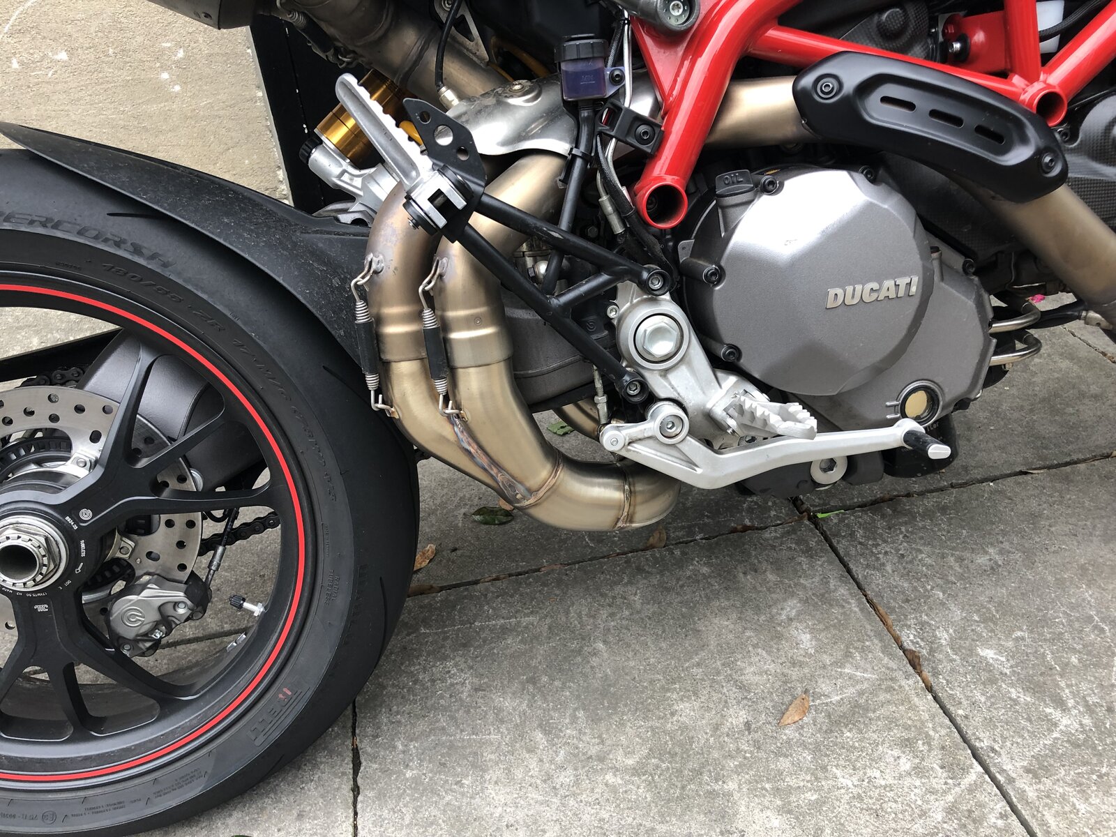

  5. Ridden it! The fuelling is mint, no issues at all :) The pipes changed colour a little as well so it looks a bit better....
  6. Awesome!!!!! Ordering one now Is there a big difference in sound??
  7. Slight dilemma now though, i cant unsee the austin racing pipes!!! Im wondering if it will sound better with stock pipes and decat or cat and austin pipes. I think the cat does most of the muffling so maybe its better with just decat
  8. It’s a lot louder and it feels like it’s got a bit more grunt :)
