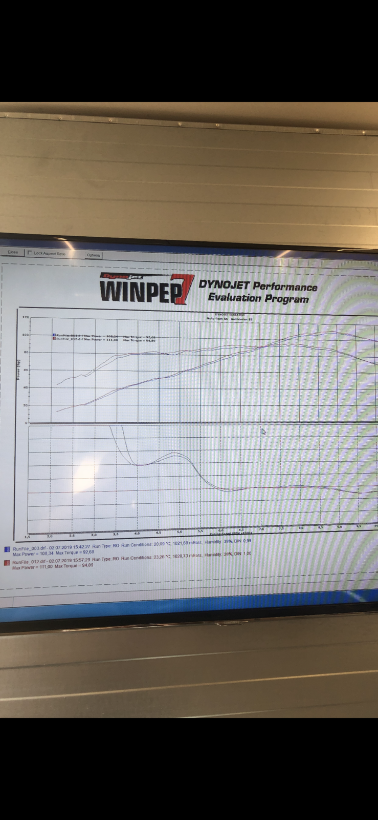

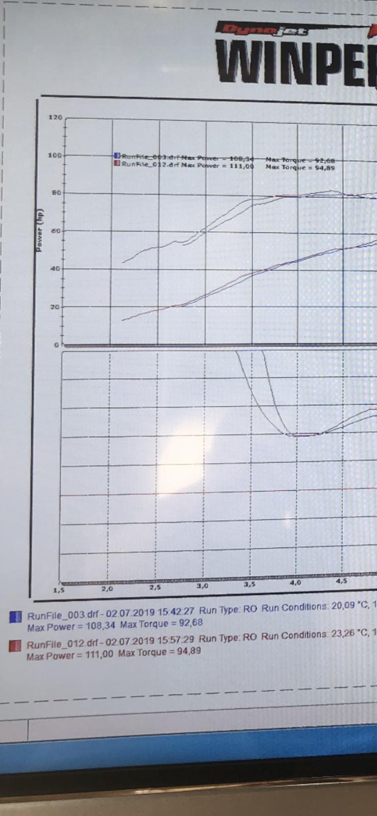

  3. Ok, just had the dyno run. Blue line is with boosterplug connected, red is without. To my surprise it doesnt make much difference on the graph but im 100% sure its smoother with the boosterplug connected. Ill be trying it on and off over the next week to make sure my mind isn’t playing tricks on me. It creates a bit more power without the booster plug which the dyno guy said is also the case on the duke 790. The AFR readings look all over the place up to 6000rpm which he said is the closed loop doing its thing. After that they level out right on the money and tail off just at the end.Most importantly for me though is the readings are totally safe and well within BB7EC316-B9AF-4408-B08D-B726CF6CF74D.png 9E6747EE-A6D0-40EF-AC19-FE1317172D98.png limits. So the de-cat with standard pipes with or without boosterplug is a go

  5. Thanks for posting the dyno results :upyeah:
  6. Is the torque in ft/lbs or Nm
  7. 94nm of torque at the back wheel
    its NM
  8. Sorry, posted at the same time!
    94nm = Something near 69ft lbs I believe.
  9. A bit less than the 1100evo but in the ball park. Enjoy...

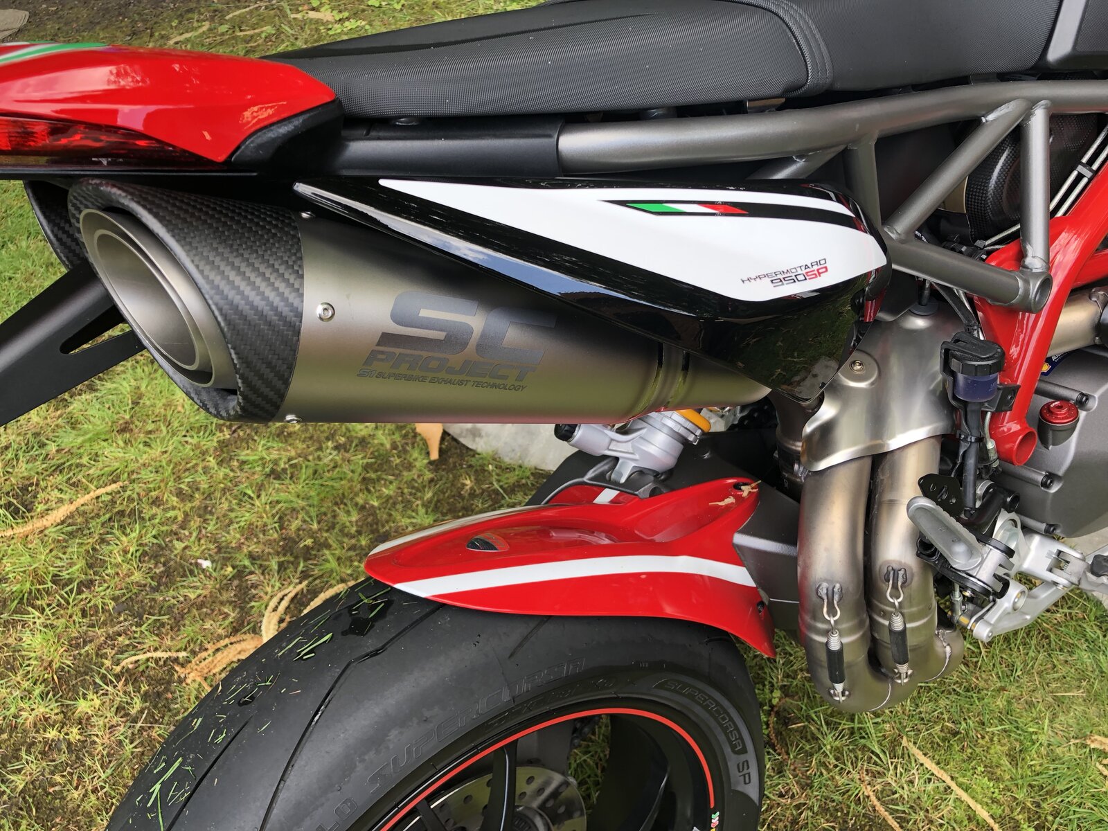

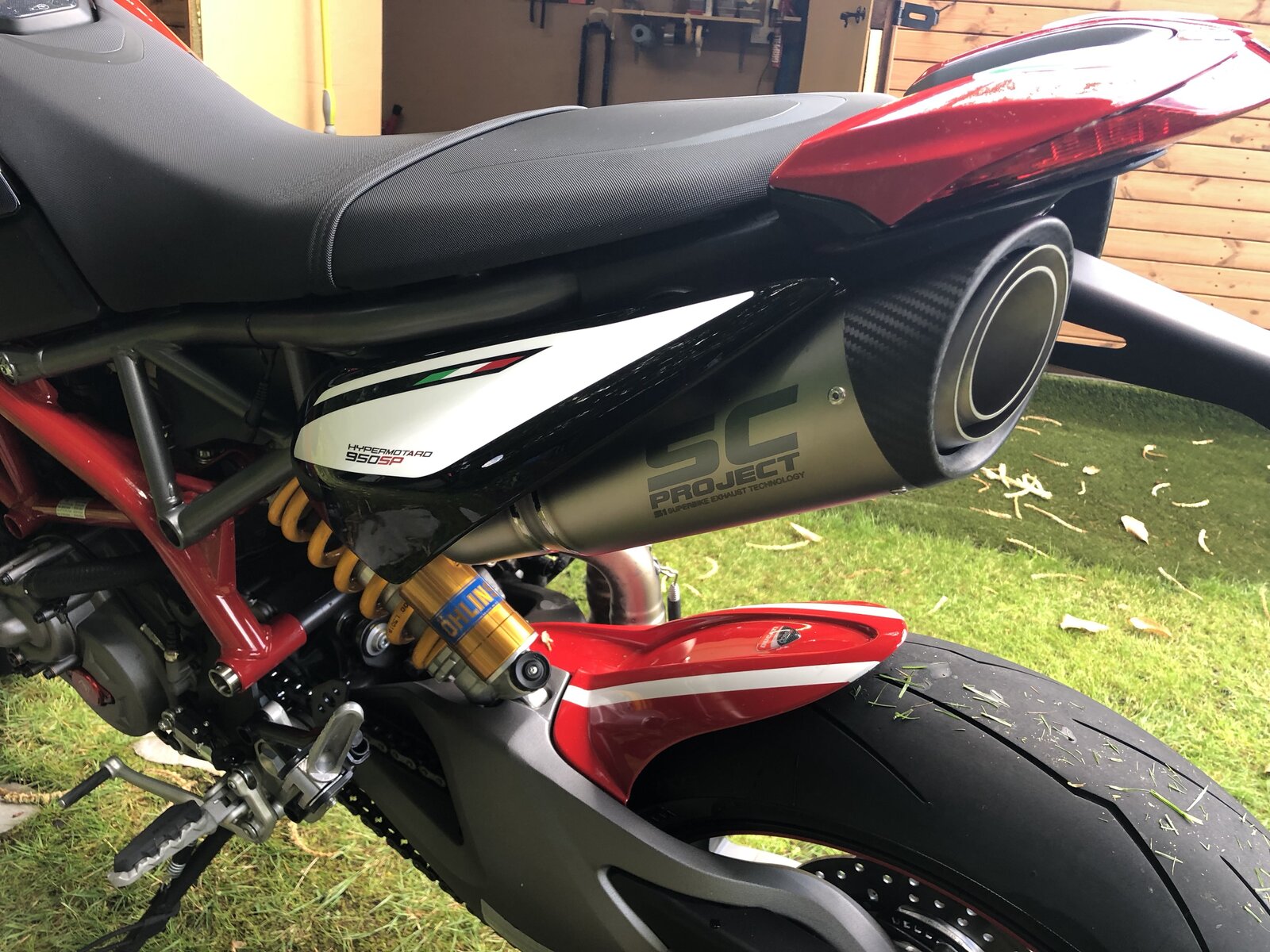

  12. opPJB9U4QfafuwE6BSkDWQ.jpg XZo%s2G1RyaZ9Nwl3lRXPQ.jpg My SC Project pipes arrived today - first thing I did was to grind out the welds holding the baffles in, a bit tricky but not too bad. Fitted the pipes and went for a quick ride - far too loud, unbelievably loud! Went home and fitted the baffles back in, still very loud, huge improvement on the stock pipes. Highly recommend.
  13. I love the pipes but have an evotech tail tidy that looks like it would hide them from the rear
    Your rear hugger looks great as well.
  14. Thanks. Yea, I'm still waiting on a Tail Tidy, the Evotech is a definite no as it just spoils the look, someone will come up with a better alternative. The rear hugger was a do it yourself job - think it came up quite well!
  15. Evotech was a temporary option till something else came along cos I hate the giant no plate hanger - if/when it does I’ll change it and get same SC silencers
