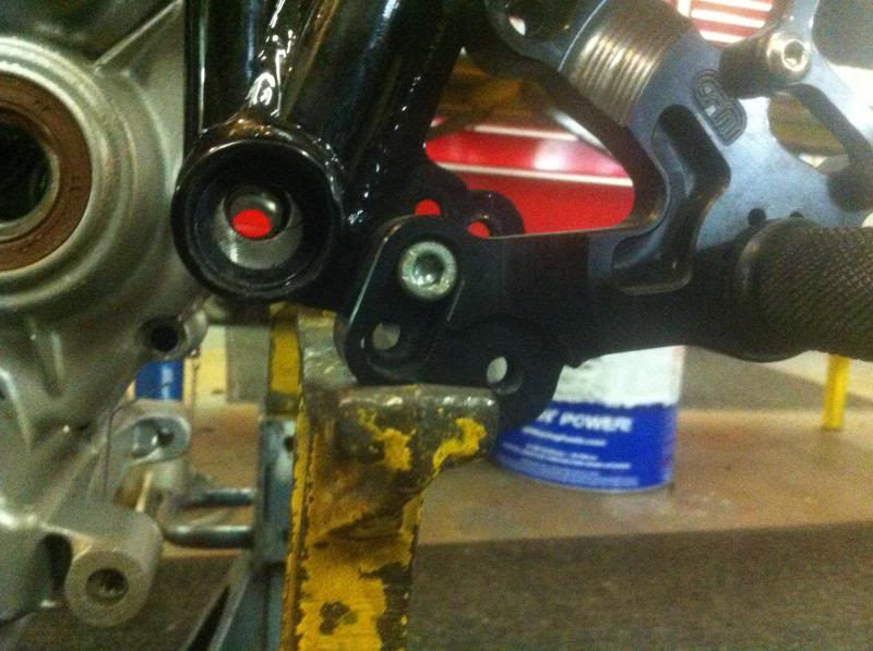

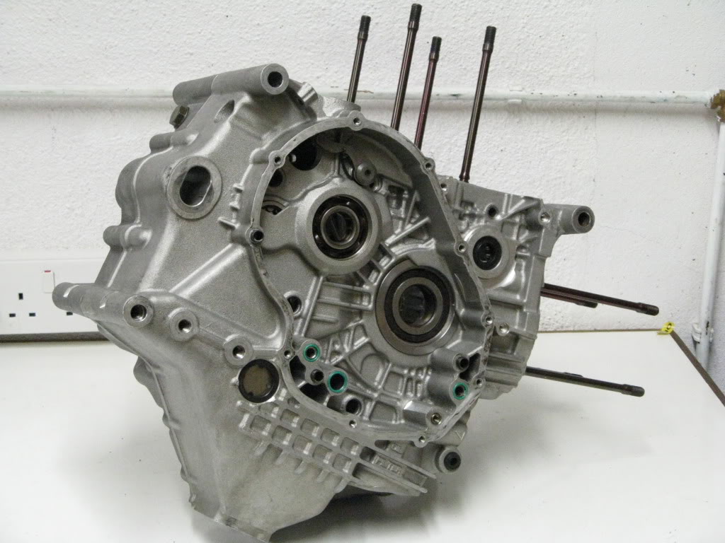

  5. Needing a good machine shop in London who can drill my cases..... the 2v bikes have a higher swingarm pivot than the SBKs, so i need to ovalize the case so the little bugger all fits together.
    Anyone have machinist they trust to do work like this?
    An example of the alignment needed can be seen on this old post from ducati.ms

  7. You need the pivot bore to be like the 999RS cases.
  8. The magic would be if someone had a template to make it a no risk operation :)
    I'm sure it's easy to sort out, as long as i mark up the cases well!
  9. All you need is clearance for the pivot pin.

  11. A dremel and a 10mm bolt not a 12mm one.
  12. Louigimoto also suggested a dremel, but the idea of me and power tools near my engine cases scared the bejesus out of me :)
  13. its a ten minute job. Even @bradders would struggle to fuck it up

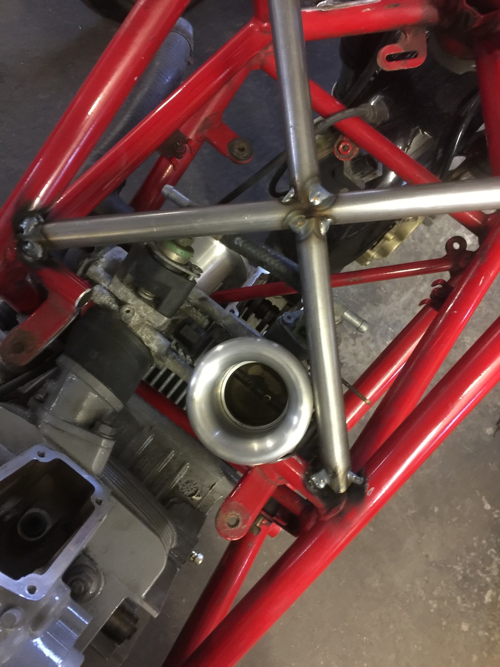

  17. Another question..... which throttle body trumpet fits directly onto a 1*00ds 45mm ID throttle body to create as short an inlet length as possible? I was told that a 748 fits but it is way too big to just slip on.... see below. I am after something that fits without machining ideally as i have enough do to already :-/
  18. Have you spoken to Mark @ MADASL?
    These are on my ST2 throttle bodies.
    Yorkie
