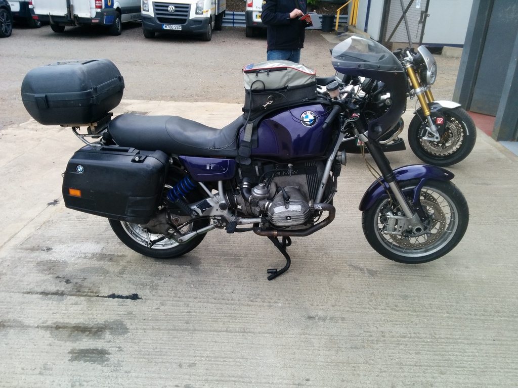

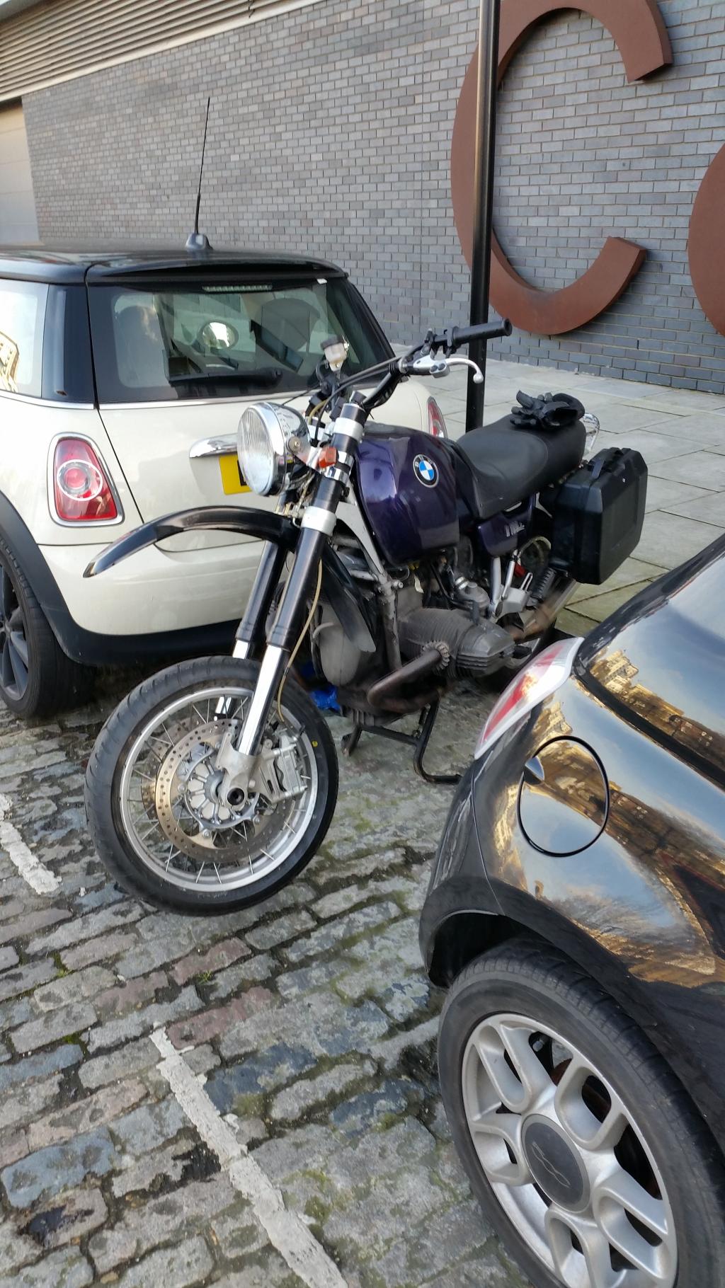

  13. The stem was done by Jim Cray, doyen of all things BMW twin.... he does some machining and welding for my BMW R100R with a KTM front end on it.
    Basically I asked him to cut the top off one GSXR stem and add a longer bit of a second GSXR stem i bought.... in hindsight, i probably could have got away with the standard suzuki length by using a shorter stack of lock nuts under the top triple....
    ... and here is the BMW in its various modes :)
