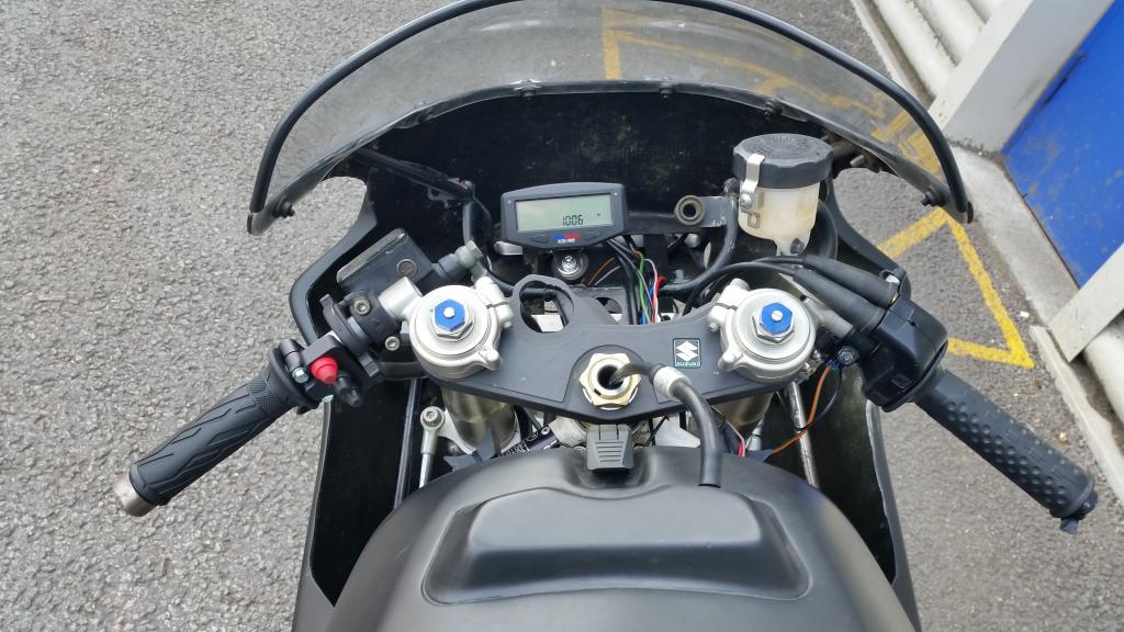

  5. i'll be using the acewell 1600 from my 900ss in the pic below. it is pretty minimal, but has a rev counter and a few idiot lights so is all i need.
    and others will have more knowledge than me in relation to ECUs and Dashboards, but CJS provides the following service for setting up track bikes and for absent minded owners.....

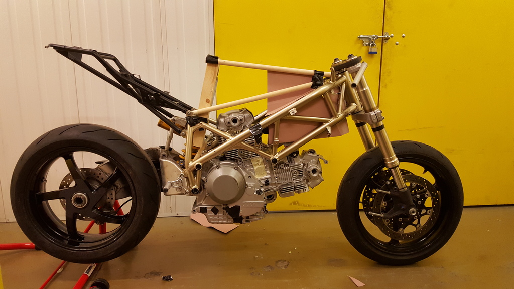

    but this is me trying to work out what my tank and airbox look like and where it all fits....
    the basics are:
    • airbox will be built out of wet lay up carbon, using a female mold, made from MDF simply fitted into the frame to set the shape... easy!
    • fuel tank will be carbon as well with lots of POR15 and about 5L, sitting centrally behind the airbox so that the bike balance doesn't change as the fuel goes down... still a few details to work out but thinking it will be bolted to the rear cylinder valve covers
    • over the tank i'll build a light weight frame from tubes with some panels on the sides to use when hanging off the side that serves the purpose of a fake tank and be strong enough to hold my weight when leaning off the side.....

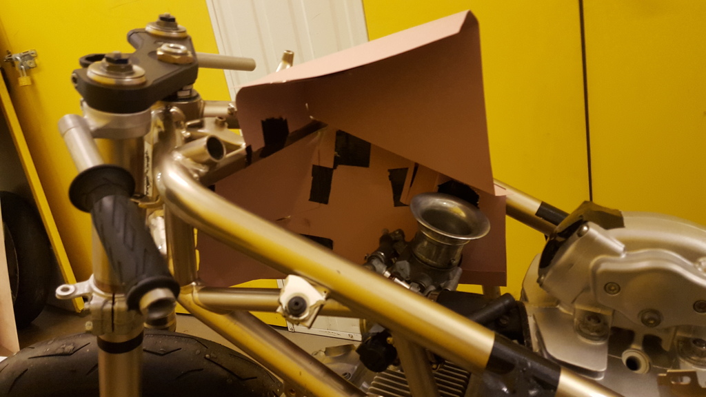

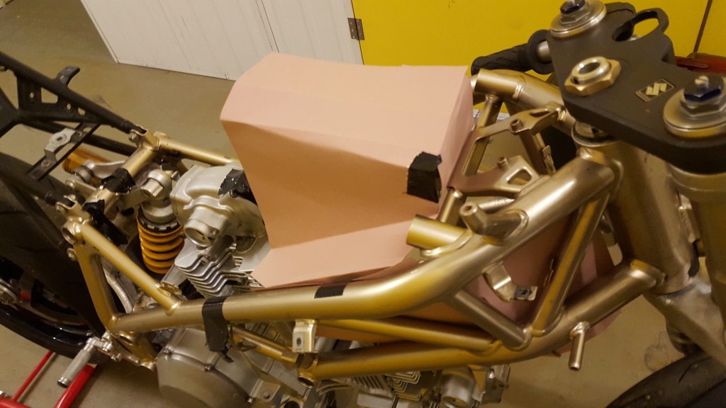

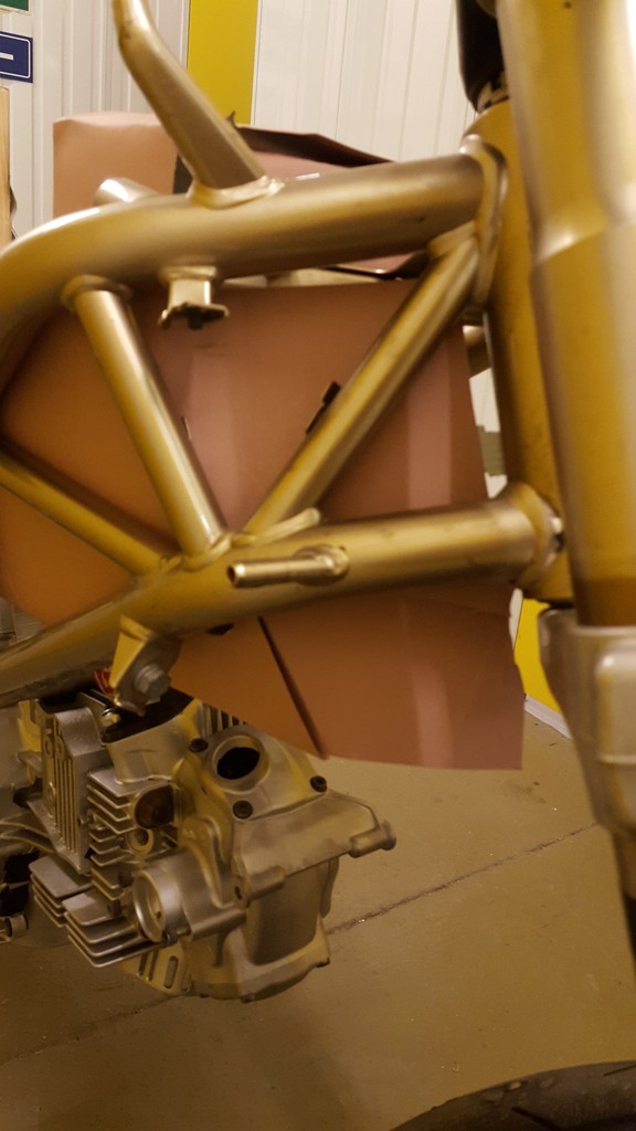

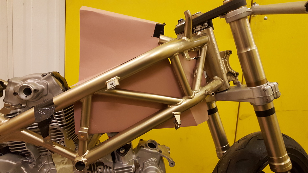

    so, here is my "starter for 10" mock up of half the airbox and the trellis structure that sits around the tank. it will be obvious why i'm looking for an old seat now as i have f*ck all reference to work out where i want to sit to get the best ergonomics :) final seating position will depend on any words of wisdom .... or roughly the same as the 1098 DP seat.....
    the airbox on its own.... thinking i'll need to lower the lid as getting a 5L fuel tank in there may be a struggle
    i'd plan to run the fake tank support tubes down the side, so the lid of the airbox needed to come in a little
    i'll have the airbox pressurised so will put an inlet next to the headstock
    and thinking i need to raise the side of the airbox a little to give more room around the trumpet....
    and please no laughing!! this is really just working stuff out at this stage :)
