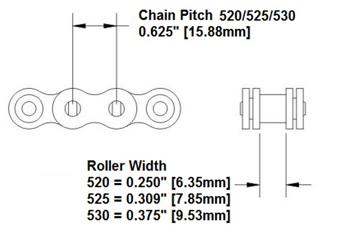

  2. The CarpiMoto link was only an example of a complete ready to go kit. You can build one of your own from UK suppliers.
