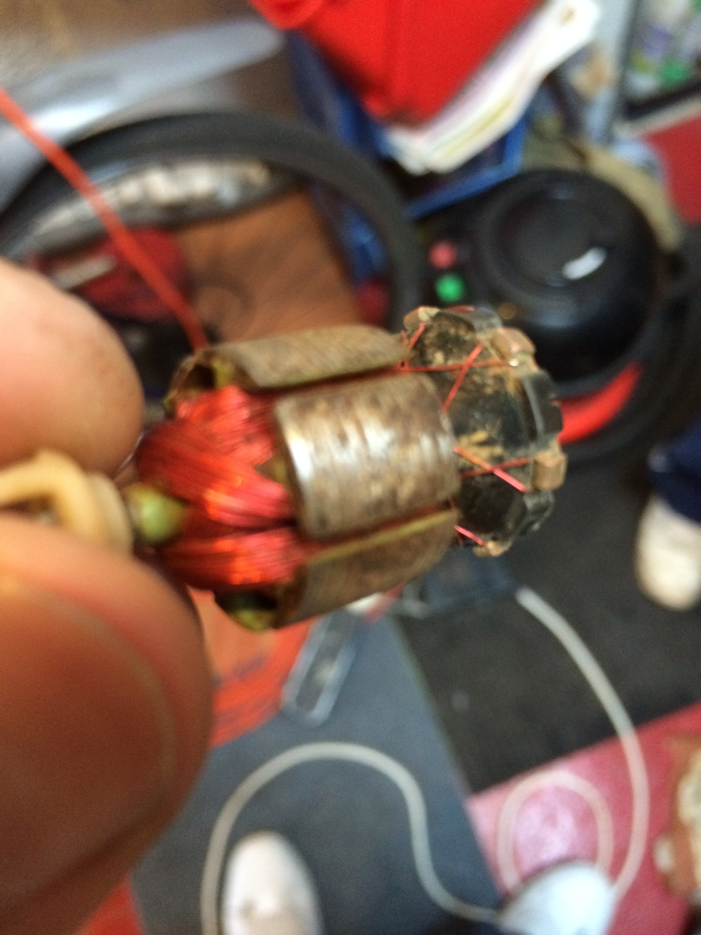

  15. Does anyone know where I can one from. It is from inside the fuel pump, the single wires are all split.
  16. Speak with a local company that does motor rewinds. They may be able to refurb it for you.
  17. Found a company just up the road from my work, hopefully they can rewind it. On a positive the bike turned over first time, expect for no fuel I recon it might of started.
