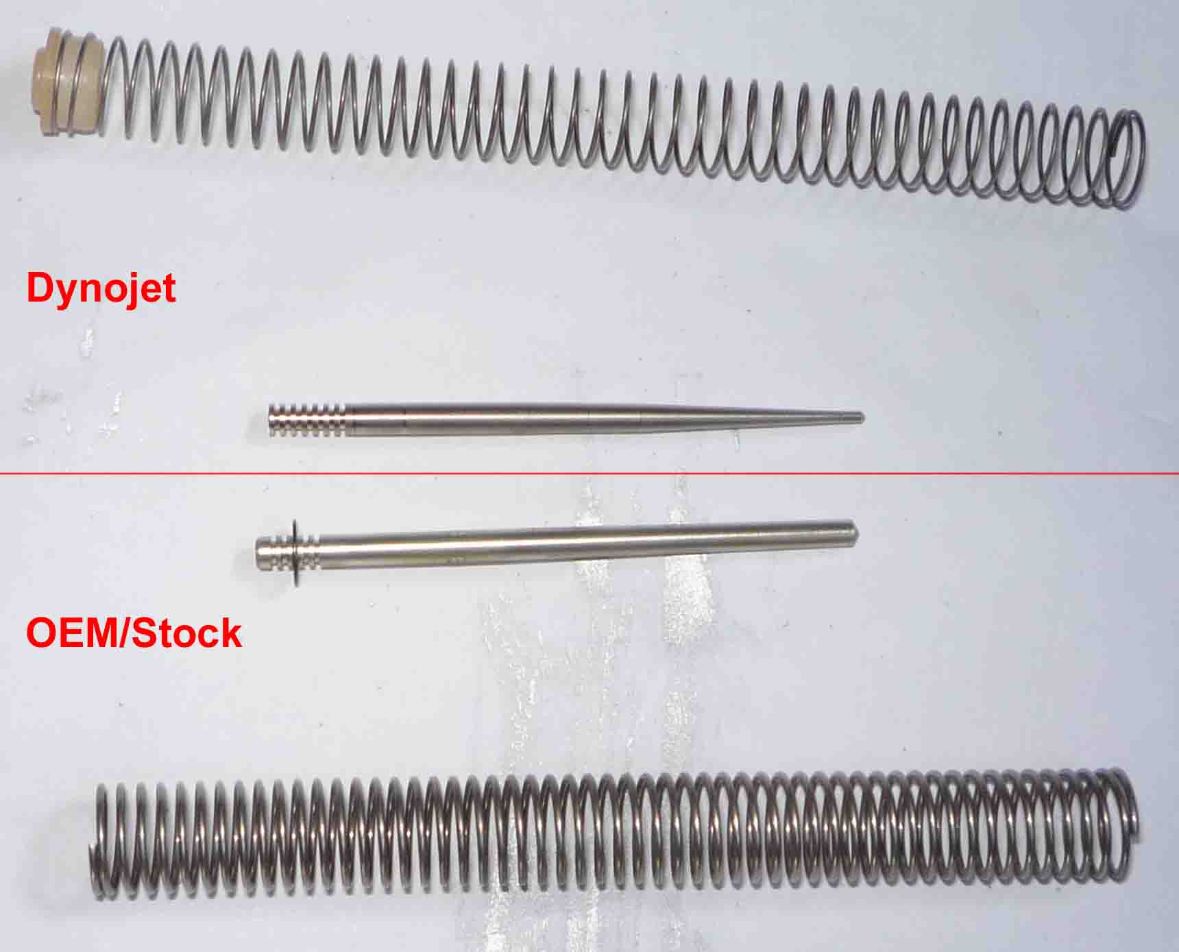

  16. You need to access the needles, the big springs and the main jet size markings.......
    Check the pic out..........The OEM main jets will have a size number and a little square logo.........the DJ ones only have a number.
    To be blunt, unless you have had all the jets out and the pilot screws out then ultrasonic cleaning of the carbs wouldn't have been worth doing........the galleries for the pilot screws are tiny and there is one area within the gallery which is like a small chamber that easily contain tons of cr*p....
    Also have you checked the O-rings and seals, including the ones that are hidden under the throttle slide light grey plastic body where the emulsion tubes are situated??
    With regard to the bracket you refer to, do you mean the little fork shaped thing (piece of brass?) that holds the main jet in place?
    If so, how has it been bodged? We here can probably find you a spare if Allens don't have them.

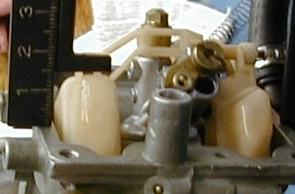

    With regard to the fuel height / float levels, don't mix up the float assemblies and don't alter the setting........but it would be a good idea to check the setting measurement...........
    To do so, without a float bowl gasket fitted, turn a float bowl around the other way so the gasket face holds down the float assembly in the carb (using two screws to hold the float bowl on) and then measure from the carb body gasket face to the top of the larger float........make sure that the float needle doesn't compress its spring, so you will need to tip the carb slightly so the float needle just closes.
    Somewhere between say, 12 - 14mm could be expected.........but don't be surprised if it is as low as 9mm.
