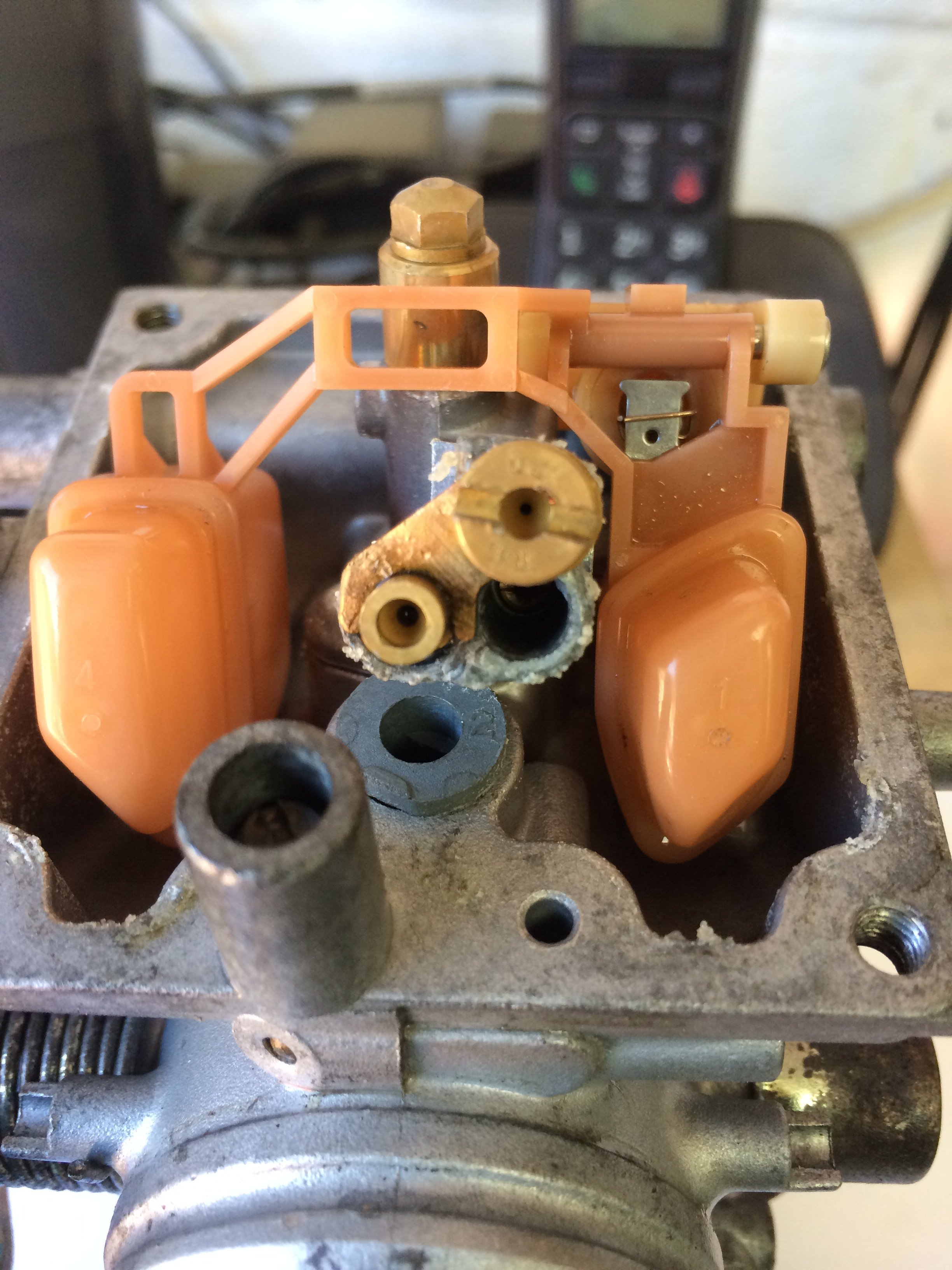

  1. I have just striped the carbs off. Going to strip them down tomorrow at work at make sure nothing is blocked or missed anything. It is dyno jetted.

    Going to need these two new bits. The number stamped on it is 70 I think and the letter R with a square symbol next to it.
  4. Where did that come from??
    Are you saying that is a jet and the retainer that holds the main jet in??
    If so, that is a starter jet.........because it is the only one which would be a 70.
    And if its the retainer, it's not like the shape of any I have seen.....
    If you can't get them from Allens, I probably have them.
    AL

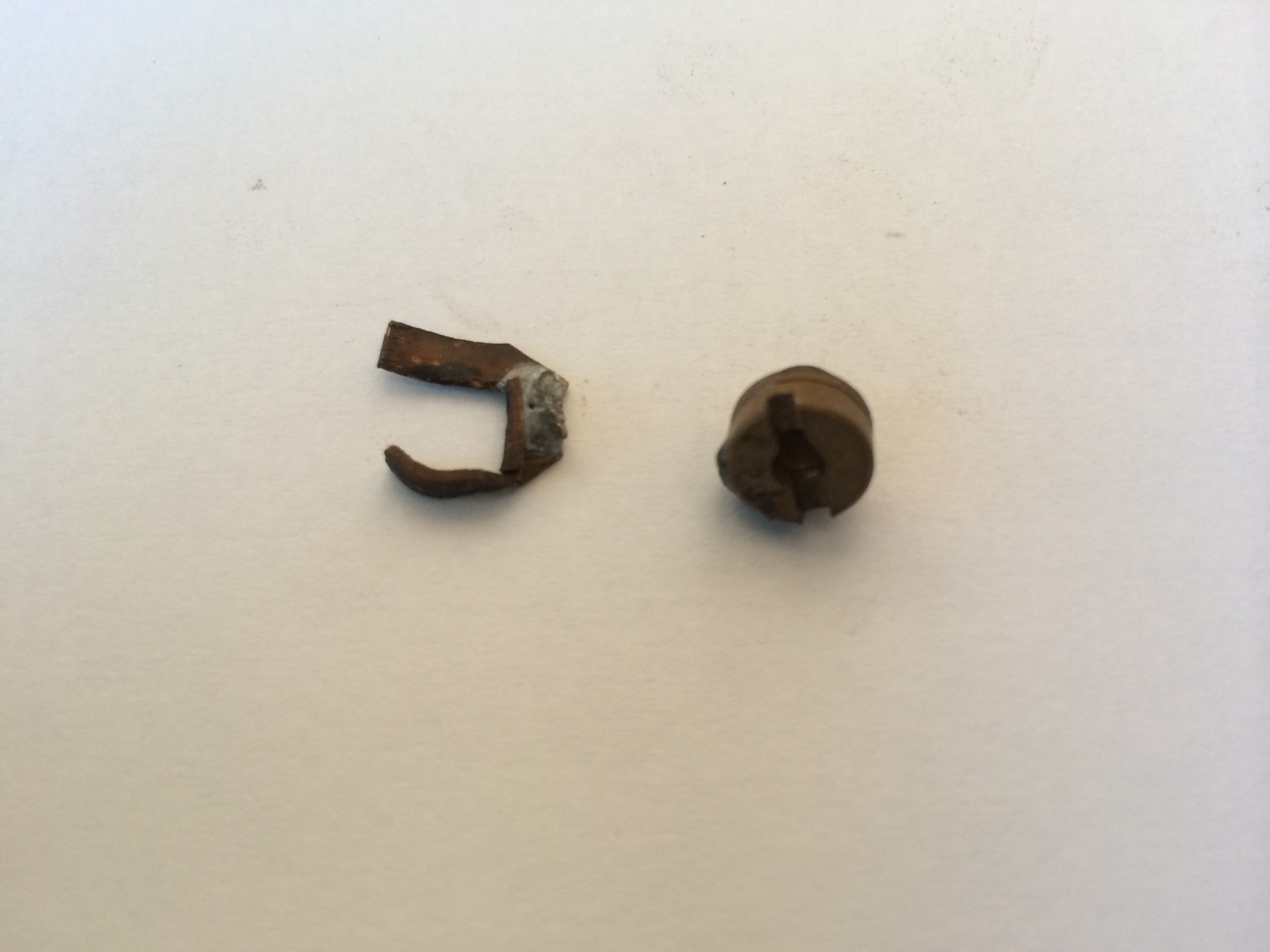

  5. That's what other carb looks like.
  6. Excuse the sarcasm..................so much for ultrasonic cleaning...........
    .......No surprise why it doesn't keep running.
    That is the correct retainer shape.
    I can't read the starter jet size..........but I think it should be a 70.
    The pilot jet (down the hole) I expect to be a 37.5............That is small enough to be well blocked up with cr*p.
    Let's get this straight..............what size is the main jet (the one with the O-ring around it) and has it got the square logo or nothing but a number on it?
    If it is a Dynojet, I suspect it will either be a 144 or 148 for a Stage 2 kit; or a 124 or 128 for a Stage 1 kit......If it isn't a Dynojet, then it is probably a 132.5 (with the square logo).
    I expect you are going to need several O rings, and study the diaphragms thoroughly for splits, cracking and stiffness.......they should be very pliable.
