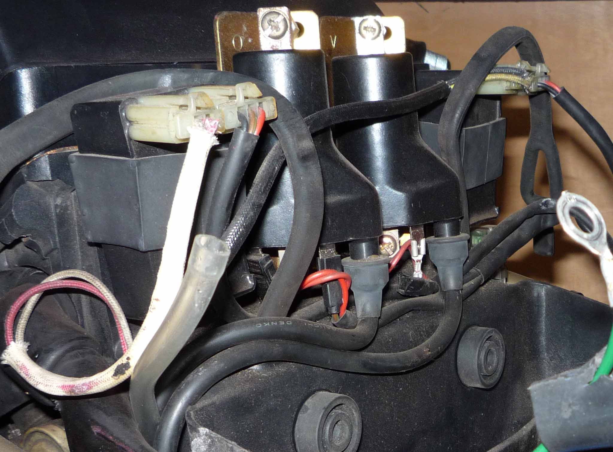

    I have attached a pic of my coil wiring in case it helps........A bit mucky, I know, but it was before I tidied it all up.
