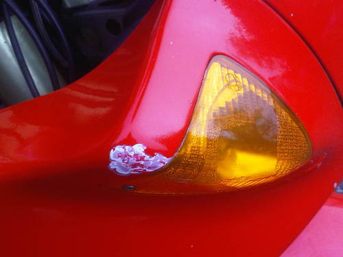

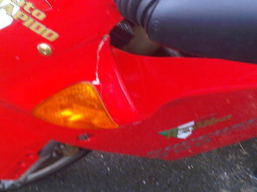

  19. AL, thanks for the useful advice from your experience. Might need more than the blob on the stick treatment for this bit:
    I was expecting to have to blend this in, along with where I think I am going to need to repair the crack in the fairing:
    But as you say the thing is to experiment and find out what works best.....if the worst comes to the worst I can take it down the local spray shop and get them to sort it out.

  20. yes - remember seeing the damage on the advert. Good news is, it won't fail an MOT on it:) Unless you have had any bike bodywork done recently I would make sure you are sitting down for the quote as it's a lot more labour intensive than general car painting (and that isn't cheap) I think it would be enough to cancel out the 'bargain' start you have got off to tbh. You could 'V' out that main crack from the rear and put copious amounts of Araldite on it for the time being - both of those areas could be sprayed/filled (chemical metal works well on outside face and is easy to mix/apply) fairly easily yourself if you have the eye for it.
