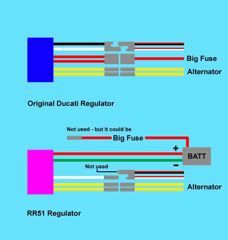

  7. If you are fitting an Electrex RR51 instead of OEM reg/rec and have any queries about which wires do which (or rather which ones you are left with and where they go....Electrex wiring diagram not brilliant).see below.
    AL
  8. Which one's the Northern Line Al?
  9. You know as well as I do, the red one is the Circle...........but there is a problem at Liverpool Plug.
