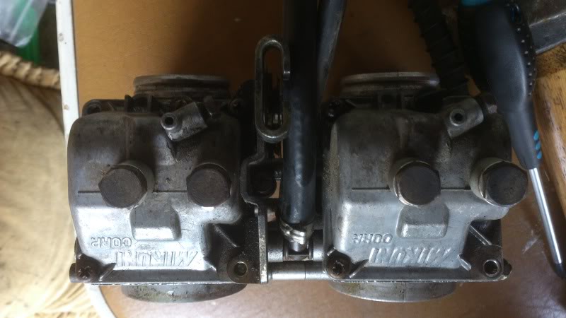

  9. Had a look at the GSXR750/1100 Mankini's :biggrin: of 1990 - 92 vintage, the earlier 90-91 carbs had a thumb twiddler like this:
    Suzuki GSXR GSXR1100 Good Used Original Carburetor Set Carbs 1991 #US | eBay
    Not quite long enough to clear the cable pulleys, would still be a faff?? The longer cable adjuster has a rep. for breaking, meaning more faff to remove & replace the broken bits. :rolleyes:
    The TDM850 had a pair of Mankini CV38's with a cable adjuster, apparently the cable has now been discontinued? No point fitting a second hand one as I would be waiting for it to snap etc.
    A further search for a twiddler... came up with this:
    KAWASAKI KZ1300 KZ 1300 MIKUNI CARB CARBURETOR THROTTLE STOP IDLE SCREW 79-82 | eBay
    Looks to be the right thread & length to be convenient? Would mean using the float-bowl sidemount adjuster support to stop the longer adjuster jibbling around - may need another made up by the look of it? No prob. :upyeah:

  10. Don't use the 1300 one....on the bike there is nothing to mount the stabilising bracket to, therefore vibration will be an issue as I reckon the d*mn thing will wiggle around like mad and undo itself.
    The long one on the bank of carbs above would be OK, I reckon.......the awkward bit is where to fix it if too long, as there is too much cable twist.......

  11. Bought the 1300 one yesterday, am committed, lol! Can make up another stabilising bracket, would have to fit under the SS cable holder anyhoo?

  12. To what will you fix it....??......and you will still have to stick your hand in a hot engine area.......
    PS.....did you have a good look at it first?.....the thread bit seems to be bent out of alignment with the rod....hopefully it hasn't crushed the fine thread together...
    AL.
  13. I should be able to use the two carb float bowl screws as per the Kawa bracket? Will probably have to fab another bracket up, or weld a washer on the bottom of the SS cable bracket where the U-shaped bend is as per bottom photo?

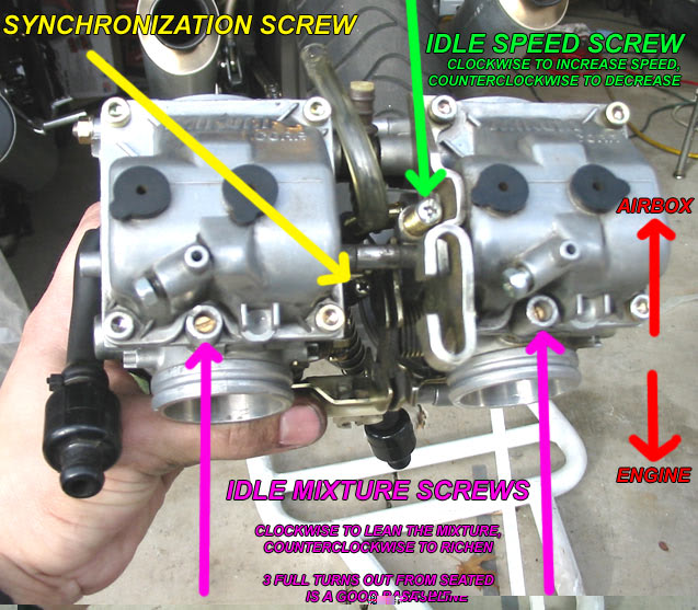

  15. Granted! I am unable to locate a tickover screw to get this cable made up, searches brought up the longer Kawa screw which I assume to have the correct thread? I can't see Mankini messing with different thread sizes on said screw?
    Yes - would still mean sticking my hand into a hot engine area, but should now be able to be done knelt by the side of the bike with a finger-&-thumb twiddle rather than led under the bike needing a screwdriver?
    All good. :smile:
  16. It seems that screw size is common across many of the Mikuni carbs.........when you eventually find one, give me a shout.
