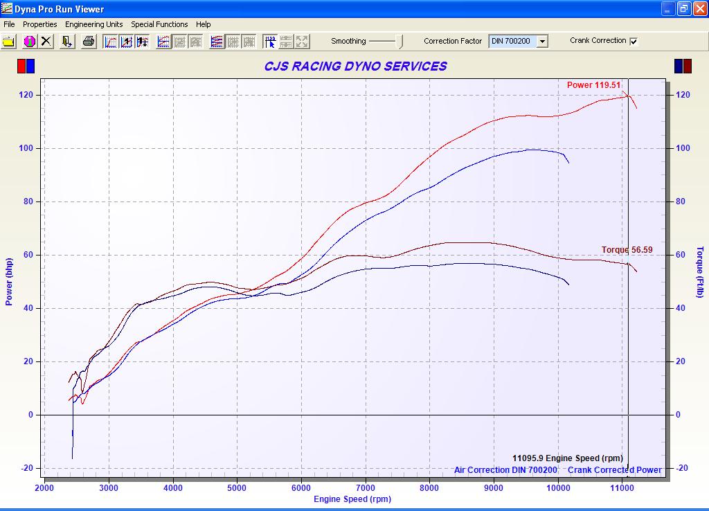

  1. Hi guys had the 748 on the dyno today heres the results im well happy!! ALISTER (1).JPG
  2. Not bad for an 853 :smile:. Geoff builds nice motors by all accounts
  3. yeah its very smooth chris the dyno man was impressed.
  4. Thats healthy!!
