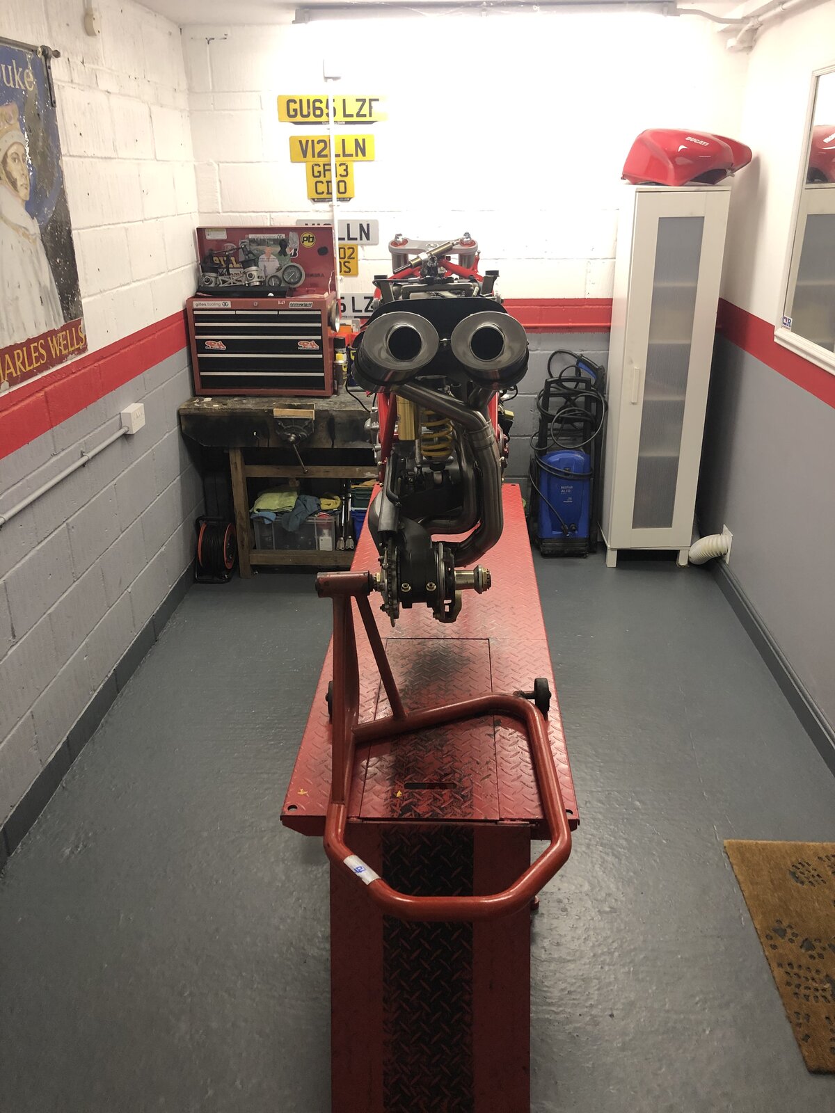

  4. Bit of a slow week this week with regards the build physically/mechanically, but made huge leaps (people from this forum paid a huge part) with taking the right route towards getting the bike running correctly. I’ve a set of 998 throttle bodies and a carbon airbox coming my way in a few weeks, as soon as I have both I’ll get them fitted and get the bike over to a friend to replace the belts and carry out a full service.
    I did get the rear subframe re-fitted and the exhausts back on this week. I’m now just waiting on parts.

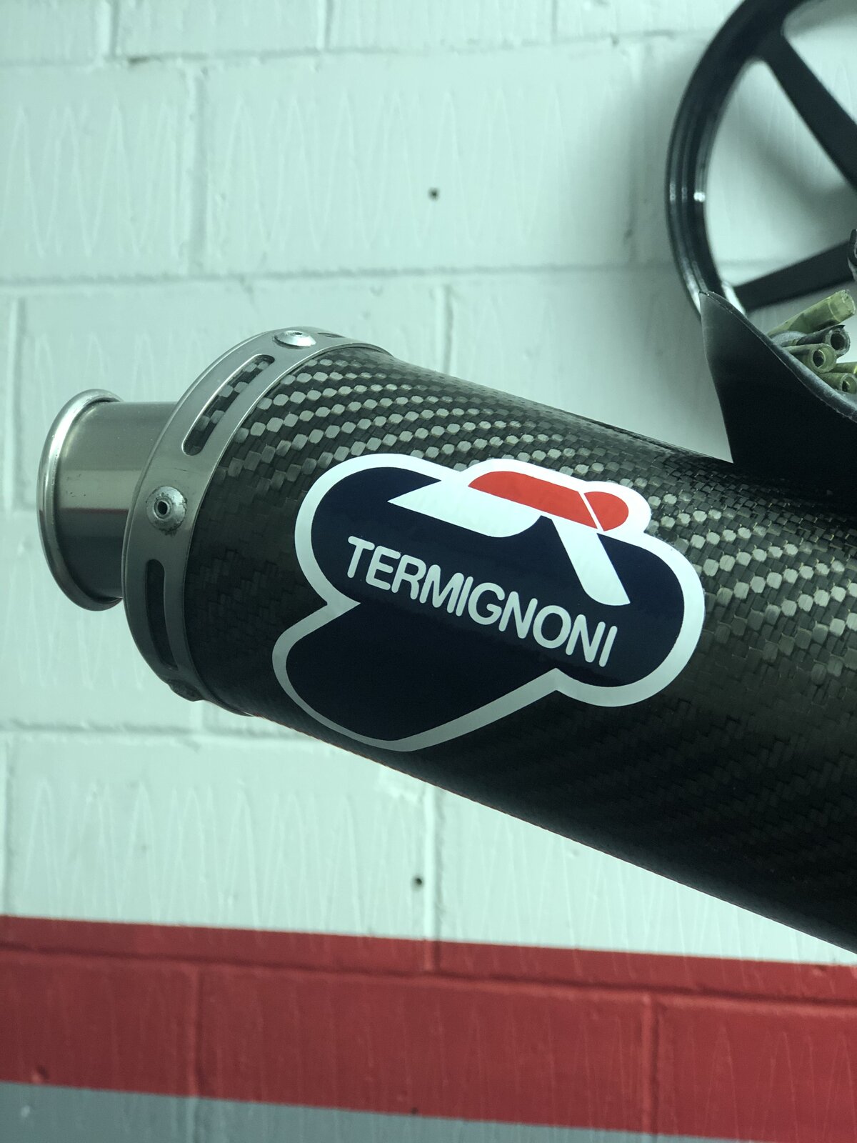

  15. Removed the old exhaust decals, which I fitted about 15 yrs ago. New decals courtesy of Pete from Pro Twins.
  16. £7.20 delivered. 90x90 decal, think the later 999/749 decals were 60x60.

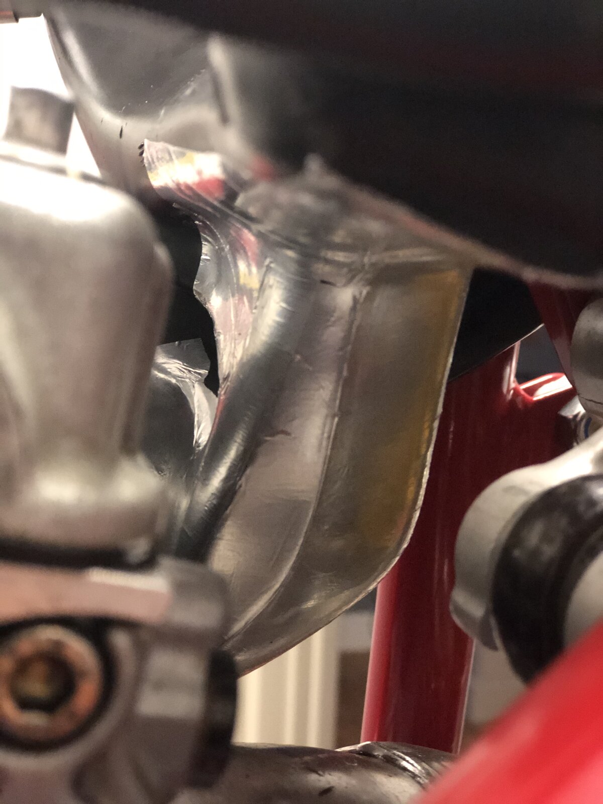

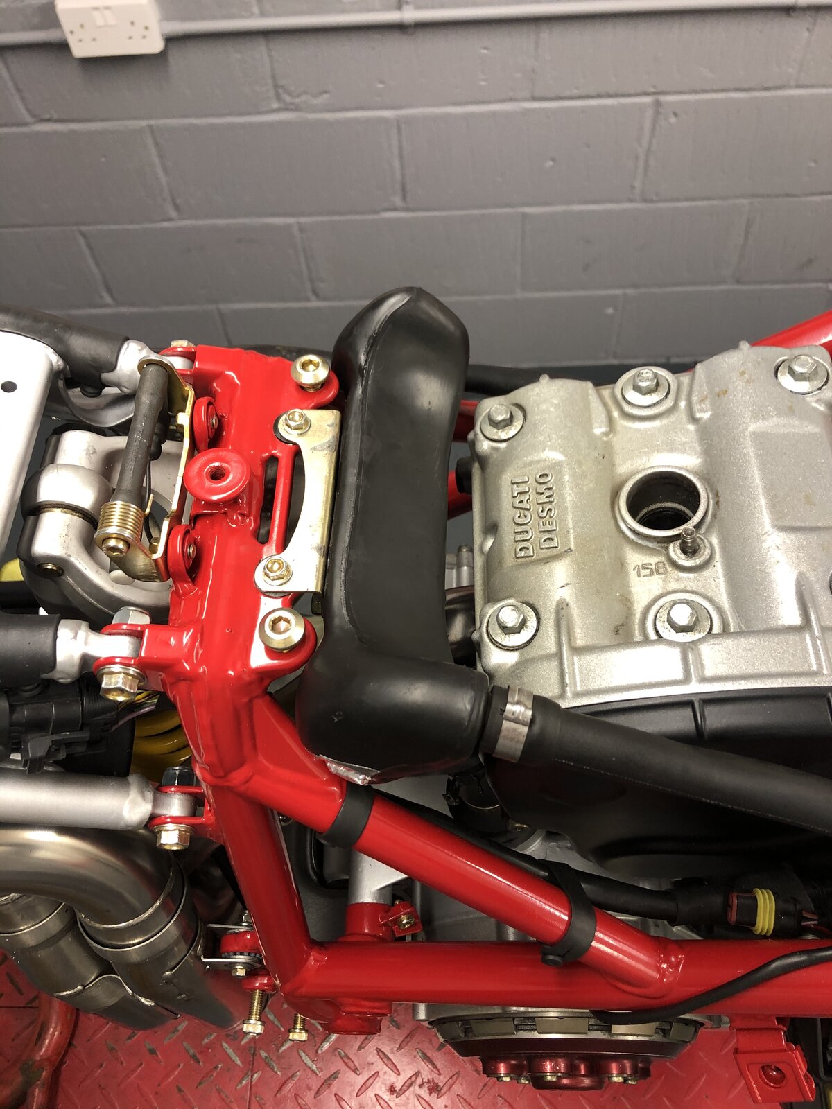

  17. Still quite slow on the build. Taking the lower clamps to get machined tmw ready for some new forks. I’ve packed the clamps out with washers and tightened, to ensure the clamps stay circular when machined.
    Before I re fitted the oil breather tank, I removed all the old heat reflective tape, cleaned up and replaced with new. Also replaced the crank case breather hose. The original hose had gone very soft over the years and started to perish.
    D5D756E2-CE35-411D-894D-C71B2DB7B77A.jpeg 54112502-686B-42E6-925D-6354F8453F46.jpeg C74A777F-2CE5-48A6-A298-762FB94D2C7F.jpeg 7DE460F5-82C1-482C-B752-8B47FA6A0D5B.jpeg
    I’ll hopefully have the carbon airbox and 998 throttle bodies by early next week. May even have the wheels back by then too. I’m aiming to have a rolling chassis by the end of the Christmas period. Looking forward to the next few stages :):upyeah:
    Thanks again for all the help and advise. I’ve probably been driving a few people mad with all the questions :joy:

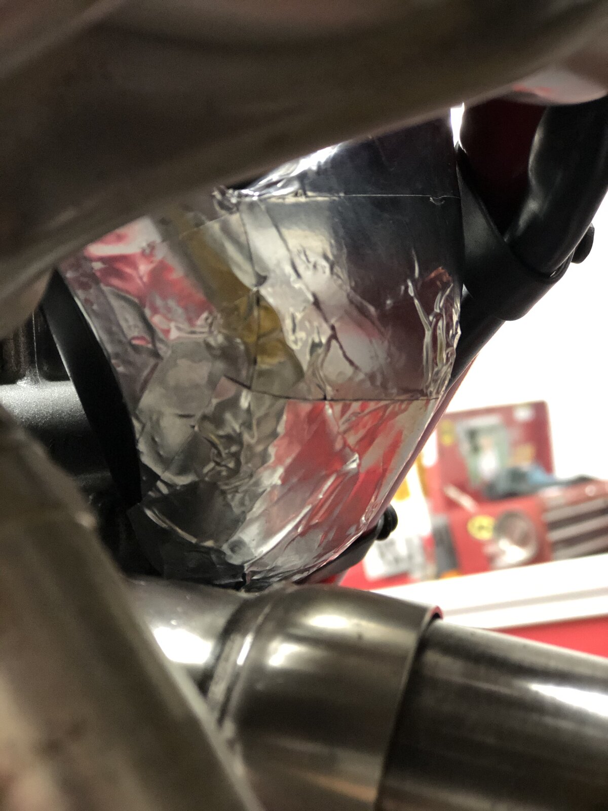

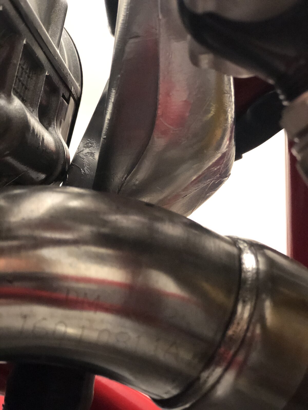

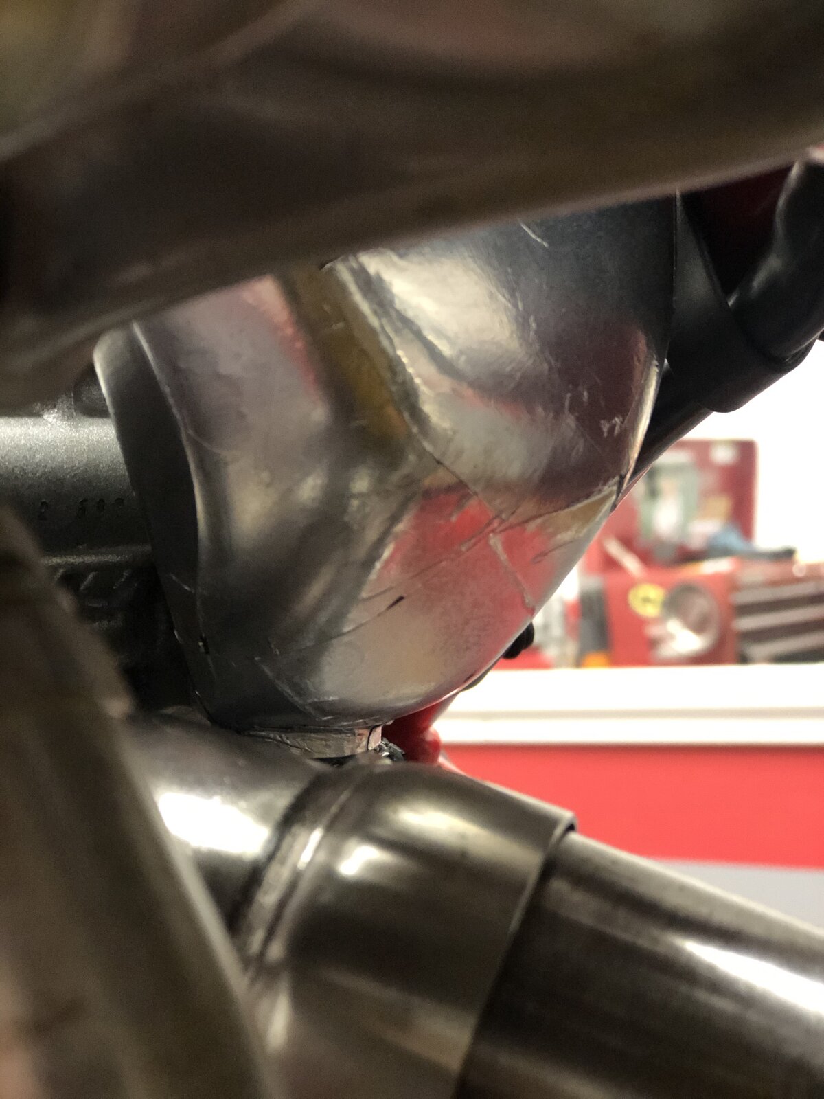

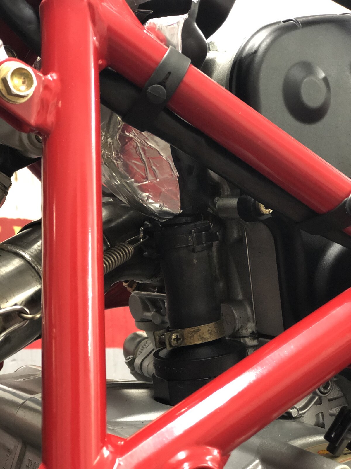

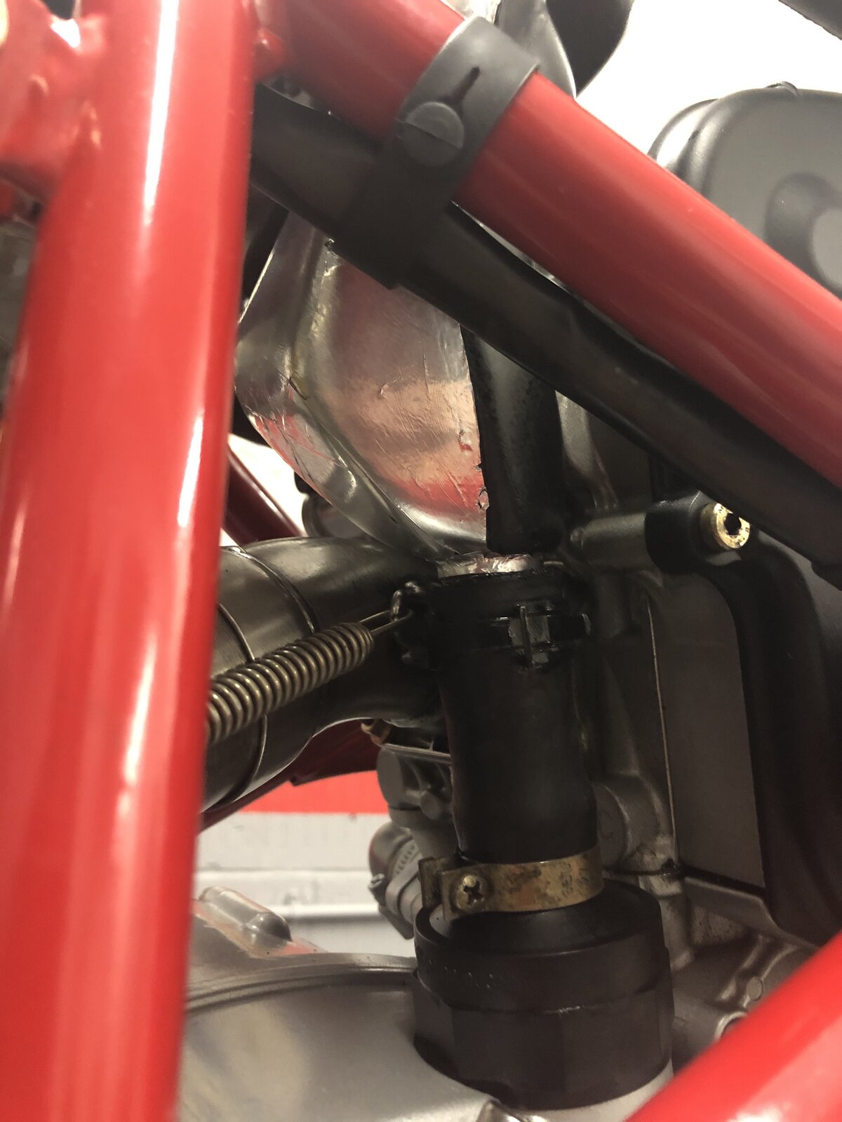

  18. After having another look at the tank, and the heat reflective tape. I decided to redo it. Just wasn’t happy with it. So removed the tank and all the tape and started again.
    This is the end result.
    15D1D7E6-48D9-4DB0-B9CB-CE0D470D0810.jpeg CD6AD669-70D3-419A-918D-7F557CF2E9CB.jpeg 5E3D5228-2990-4FA5-842C-196D3D04C8F0.jpeg 580BFDF2-8A21-4790-907C-D583CBB17157.jpeg
    Now I know it’s not perfect and the likelihood of it ever being seen is pretty slim, but it didn’t sit right with me so had to be done again. This time, is come out 1000 times better.
