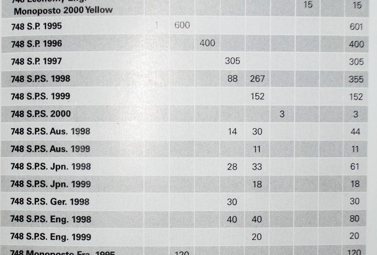

  7. The SPS was made in lesser numbers and is therefore considered to be rarer, although it's possible that fewer SP's exist today as they are older. Only 20 were imported into the UK in 1999
