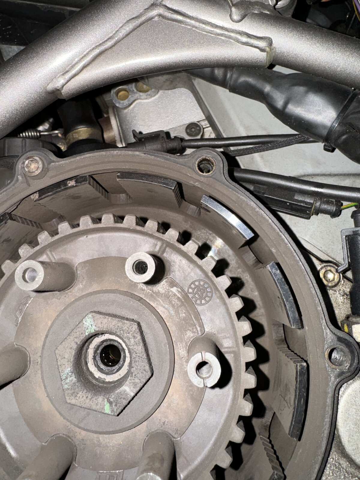

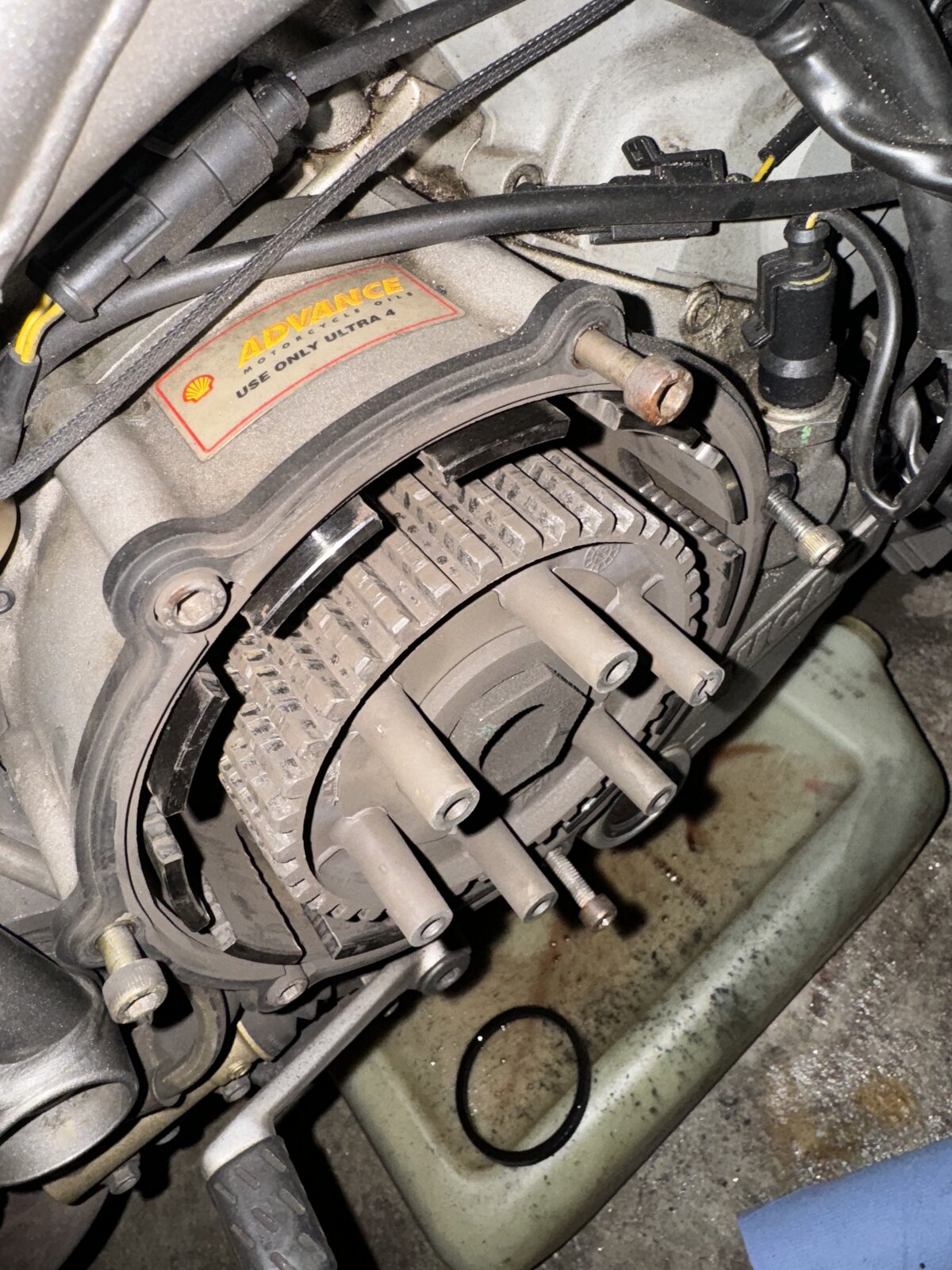

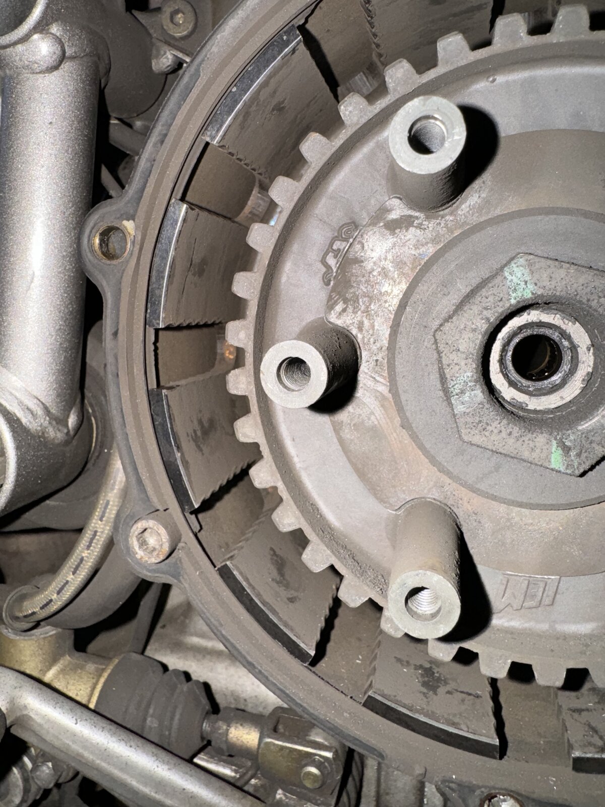

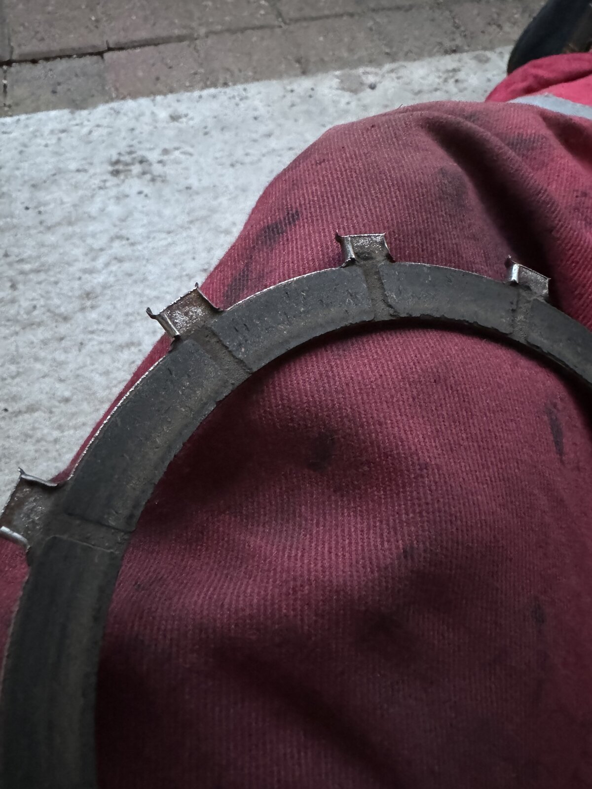

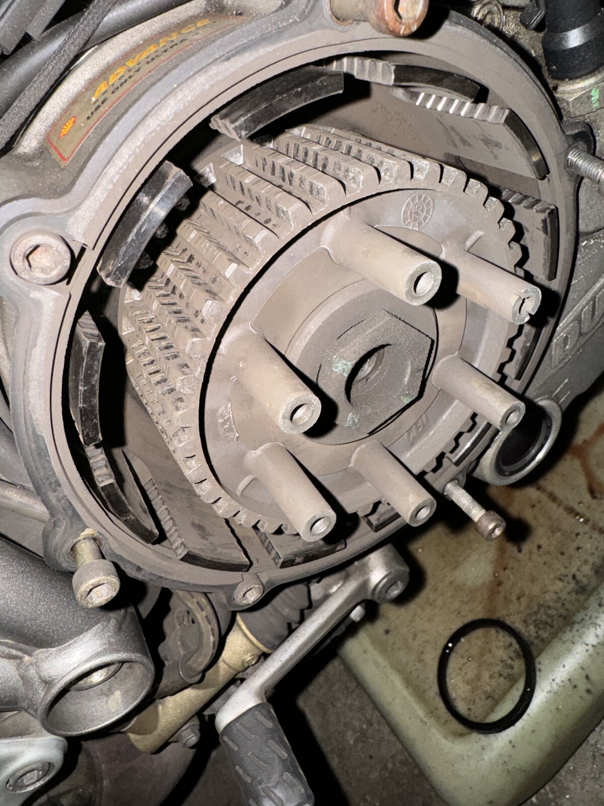

    The bike hadn’t done many miles last year but been in the garage giving everything a once over, generally all good but have seen some really heavy wear on the tangs of the clutch pack. What’s everyone’s thoughts on this, give them a file and ride on or replace. Basket has wear but no sharp edges and the pack depth is 38mm which is bang on spec.
  19. Most would throw their hands up in horror and scream replace everything. It looks very much the same condition as mine which while it rattles and bangs like hell it works just fine and doesn't slip at all. In short if it works as it should use it for now and plan for replacement in the future.
    #119 Hughdg, May 12, 2024
  20. Thanks! That aligns with my thoughts.
