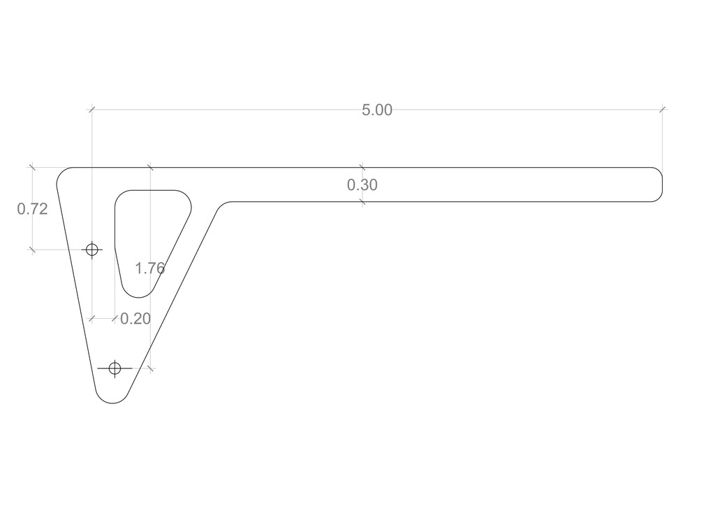

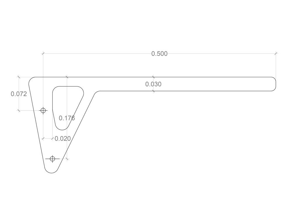

    i'm new... i'm looking this thread and i'm really interesting.
    i would like to reproduce this ride height tool.
    it's correct?
    a new project four next week
    definitive
    ps i'm sorry, i'm an architect and work in meters...! :biggrin:

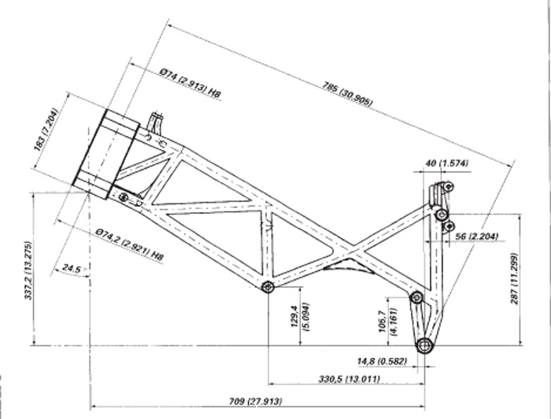

    but i'm not sure the distance a_b it's 20mm but 14,8mm and the difference it's 105,7 no 104
    i think this is correct

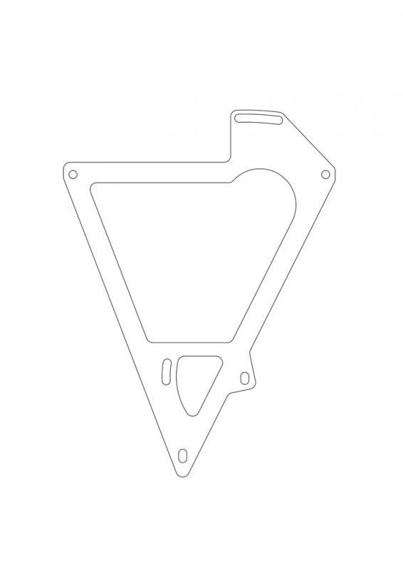

  2. Did anyone take this forward and make their own ride height tool ? Asked about sourcing a genuine Ducati tool today only to be told it would be easier to collect rocking horse poo or extract hen's teeth. Andy
  3. I also ask the same question as android853 because today I contacted Ducati Coventry about buying a gen tool only to be told that they are no longer available. Steve
  4. Steven, if you search for 748 rear ride height measurementl, CrankerV2 has posted a .pdf drawing of the tool which I used to make one for myself out of stuff I had in the garage. Pretty it ain't, functional it is. Andy
