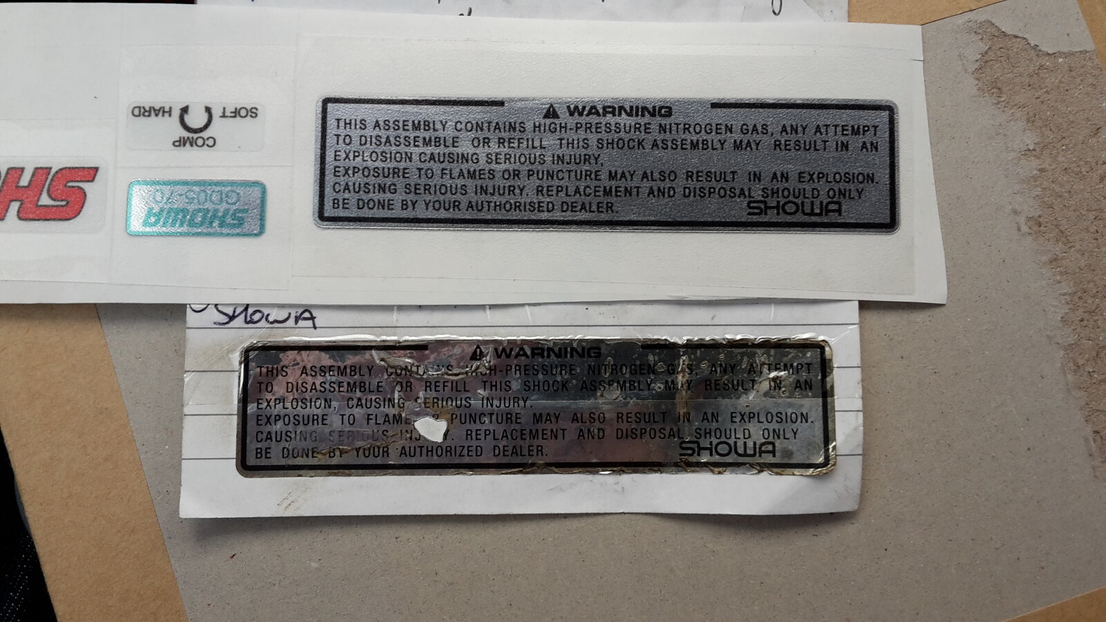

  5. Hi Keith,
    With regards to your rear shock, I had someone replicate the Showa decals/stickers to replace my knackered ones years ago. The guy whipped up two sets, I should have a spare set (below) hidden in the garage some where if you're interested?
    You can see that the mirror finish is not a perfect match, but they were a massive improvement on the ones I removed and with a freshly powder coated spring, made my shock look like new again. You're more than welcome to my spare set.
    Great to see the pics too
  6. Yes please Rob, they would be most excellent.

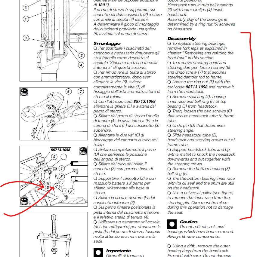

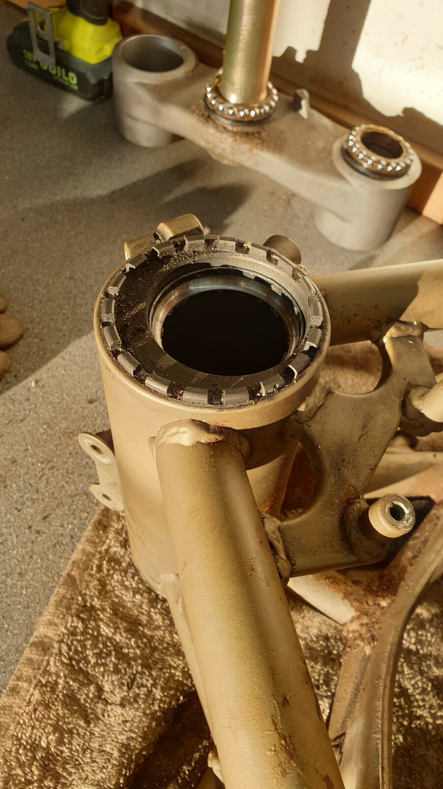

    Whilst I'm here. How the chuff do you get this apart? A square edge bar fits perfect but it just turns. The Haynes manual doesn't have anything on it either for removal.
    Help????
    Many thanks
    Keith
    should jsut be the securing screws on the outside of the frame mate
  8. Ahhhhhhhh, never thought of doing that.
    Thanks

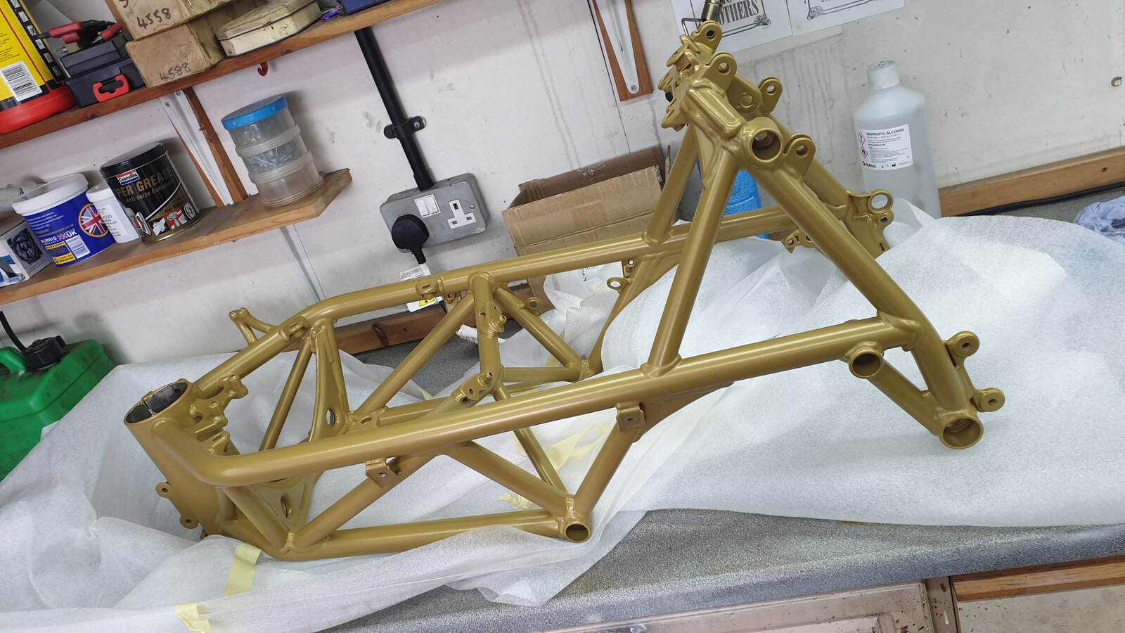

  13. Small update. The 748 frame is back with me today and the wheels Monday with new diablo corsa rubber on them. Love the colour I have to say.
    Next stop, paint work on the engine block to get rid of most of the pitting and corrosion and then I can start putting it back together.
    Keith
