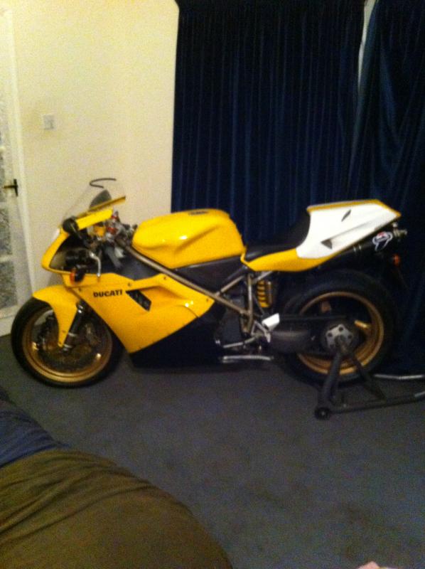

  14. So it's home. Well not my home I haven't even seen it yet as my mate went to pick it up.
    Now people have different ideas about what the "best sps in the uk" (as described in the ad) and the original cover was missing despite being listed in the ad, and the 'FSH' meant the belts was last changed in 2010 (but it hasn't been used really to be fair).
    But it seemed straight enough, the fella who had it seemed allright and the history of the bike is fairly solid with the majority of the use coming from the previous owner who had it since -99. I couldn't really be arsed to argue so took it home. Gonna need a big service at least and I'm gonna have a look at the rockers I think.
    Where is the best place to get the bits I need for a service? Prefer buying from someone who is active on the forum.
    Only have this shitty pic from a mobile. :upyeah:

  17. Judging by the photo it is not 100% original as the bottom fairing is black and they never were, the airbox is either black or carbon, again they never were. The wheels look very "gold" in the photo and should be frame coloured. Finally the Termi stickers were not fitted on this model.
    Apologies if this sounds a bit negative,it's not meant to be at all, but it's not an original bike. I don't know how the seller was portraying it but I would have said there were grounds for knocking him down on the price at the time, I don't know if you managed to do that or not.
    I think the seller didn't really know what he actually had!! does it have the original bill of sale out of interest.
  18. I don't mind mate, and I prefer to know what's what. When I get better pics I will put them up so I learn more about it.
    You are right on all of the above, and additionally some twat seems to have painted part of the engine cases, or it's flaking. Either way it doesn't look right.
    But the overall feeling of the bike is that it's not as bad as it sounds, the history of the bike makes sense with the mileage, numbers match up etc so I decided to take a flyer on it. He already said he won't take a penny less whatever I find on the bike so I paid (all)the money and left. I'm still not sure who did best out of the deal (me or the seller), I reckon it's about 50/50 at the moment :biggrin:
    Clearly I should've bought the 748R or 916sps mentioned earlier but since I didn't get my fingers out I'm stuck with this.. It will be right in the end, and I reckon this will actually be a better buy long term rather then an R
  19. Oh the black lower fairing is carbon WRAP :biggrin: Still don't know if it's to hide something or someone thought it looks cool... It is nasty imo
