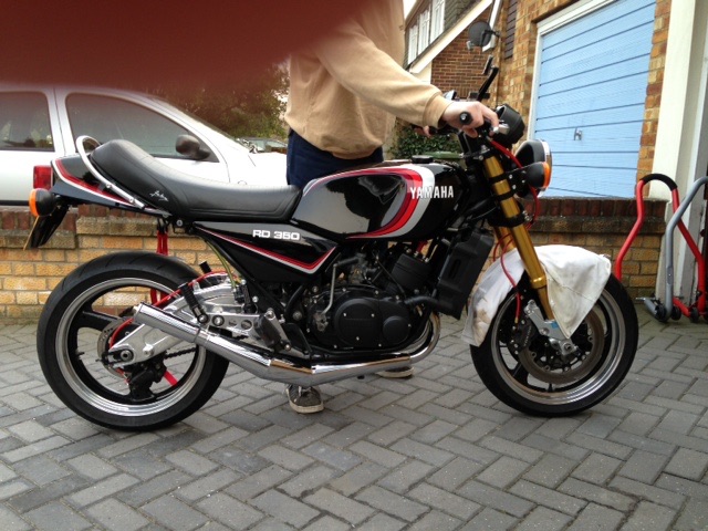

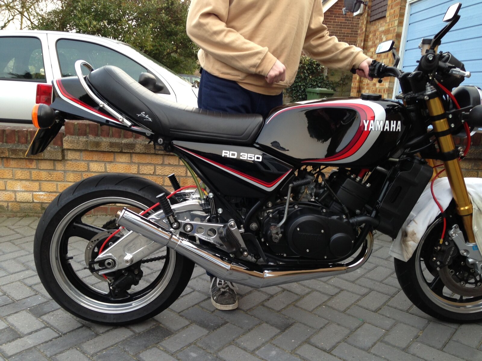

  3. Is that 6 years on your LC in your photo.
  4. Yes, Fully running now just needs paint and seat trim... I'm 1/4 way on a new project ZXR400 J2 or SP model and looking for my next one ideally a Late 748R Olins 2001-2002 or may be a 916 SPS etc..
  5. Done a few 350lc and two lc2 and this one :heart_eyes:

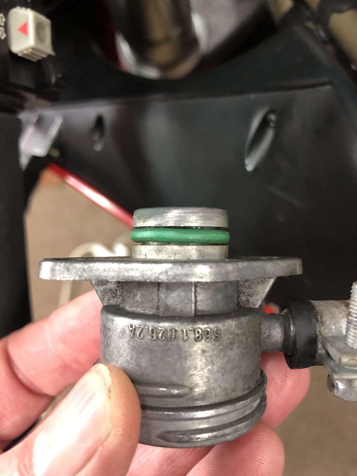

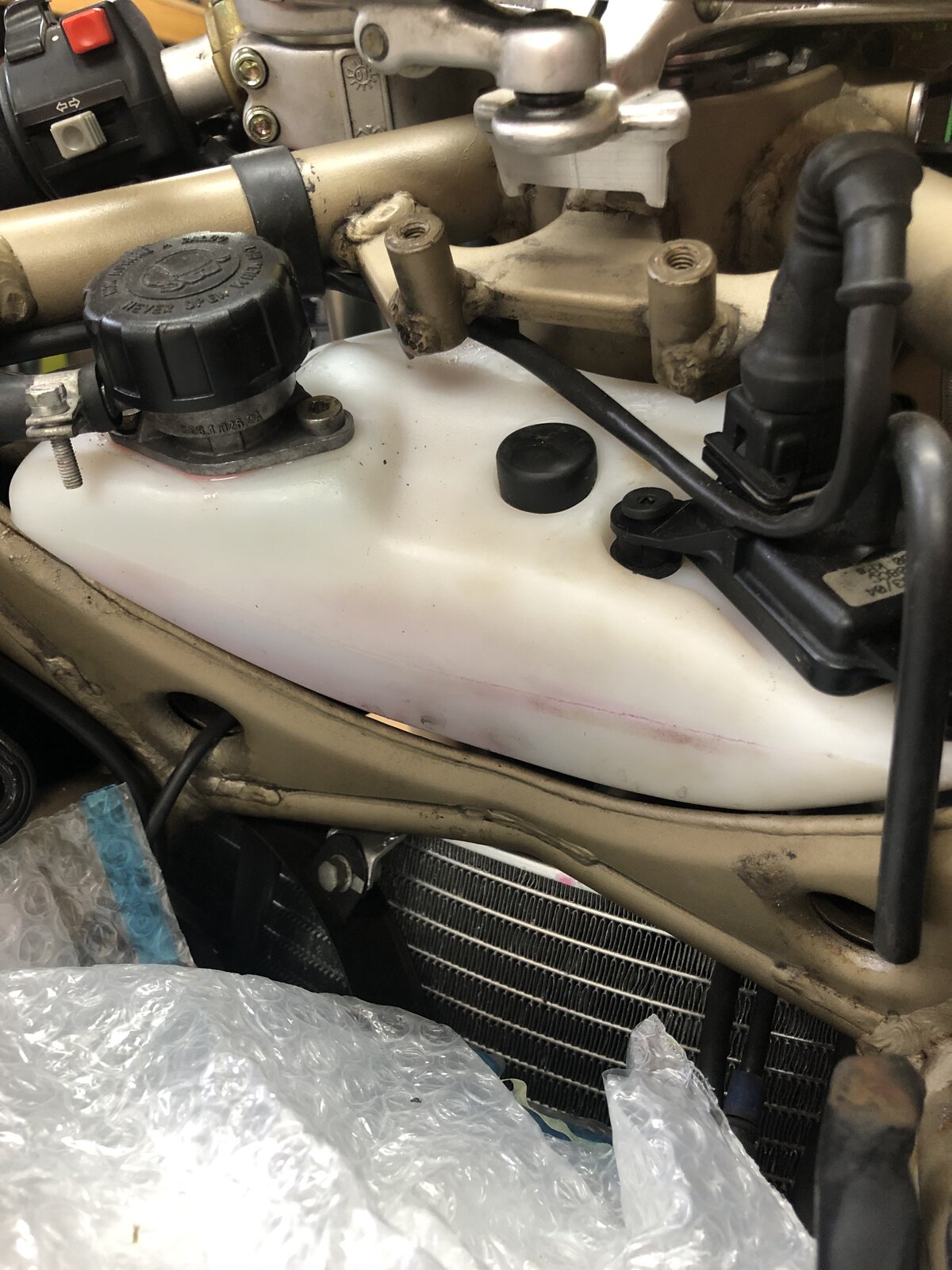

  7. Noticed i had a slight leak on the upper coolant tank back in march and when i started to have a look thats when my Tendon snapped in my righthand so job has been on hold until this evening,
    Once tank and airbox off i could see where the leak was coming from bottom of the filler plug and running down and dripping on the top of the rad.
    For the life of me i couldn't think how it could leak there as coolant level is below the filler plug and I've not used the bike since last October
    Then it came to me how, every winter i leave my bikes on rear paddock stands and now and again push down on the bars to move the forks/seals which also sloshes the coolant about in the tank, last time i replaced the tank i didn't renew the green o ring and that was in 2016 its probably the original one which has worn/shrunk.

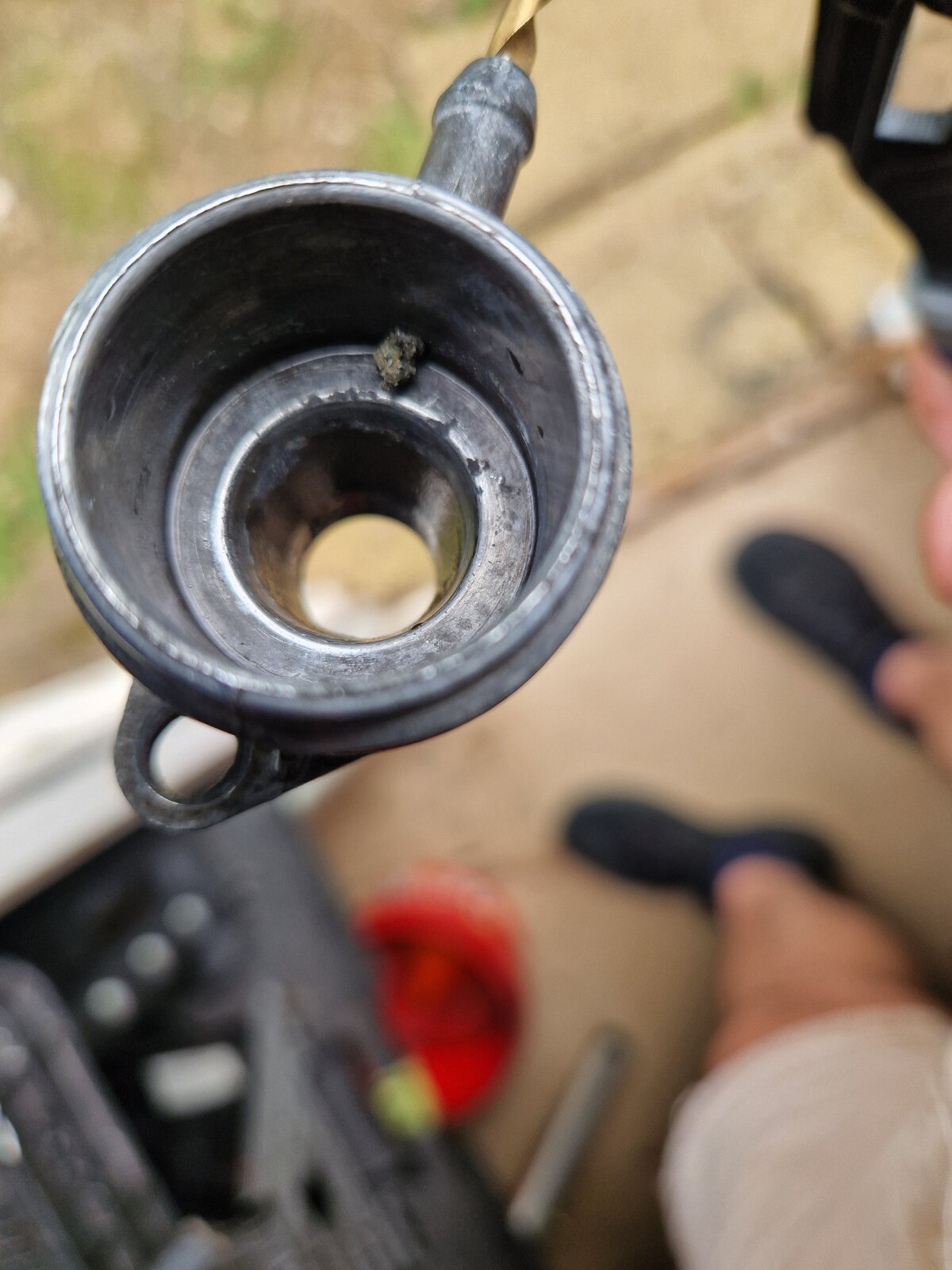

  8. I have been having an issue with my 996 coolant, if ticking over for over 20 minutes, it starts bubbling and spitting coolant from the same place
    After talking with John Hackett at Ducati Coventry (JHP Racing), he advised to clean out the overflow pipe on the filler neck with a 4mm drill bit, as it is prone to blocking with corrosion, did it on mine, at the same time, I replaced the thermostat, it appears to have solved the issue
