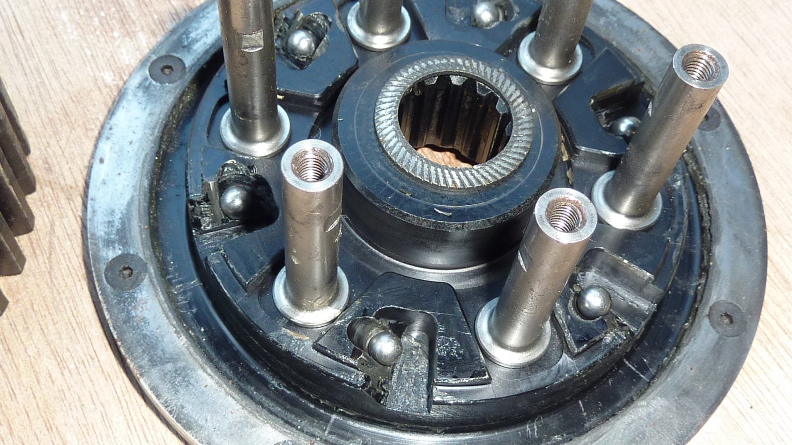

  12. Hope this helps, a picture of a slipper hub, when the center rises up the ramps a steel plate fitted first would drop of the back of the splines and jam the whole thing up.

  13. Hi Birdie
    Thanks for the photos i can understand things better and there great for comparison :upyeah:

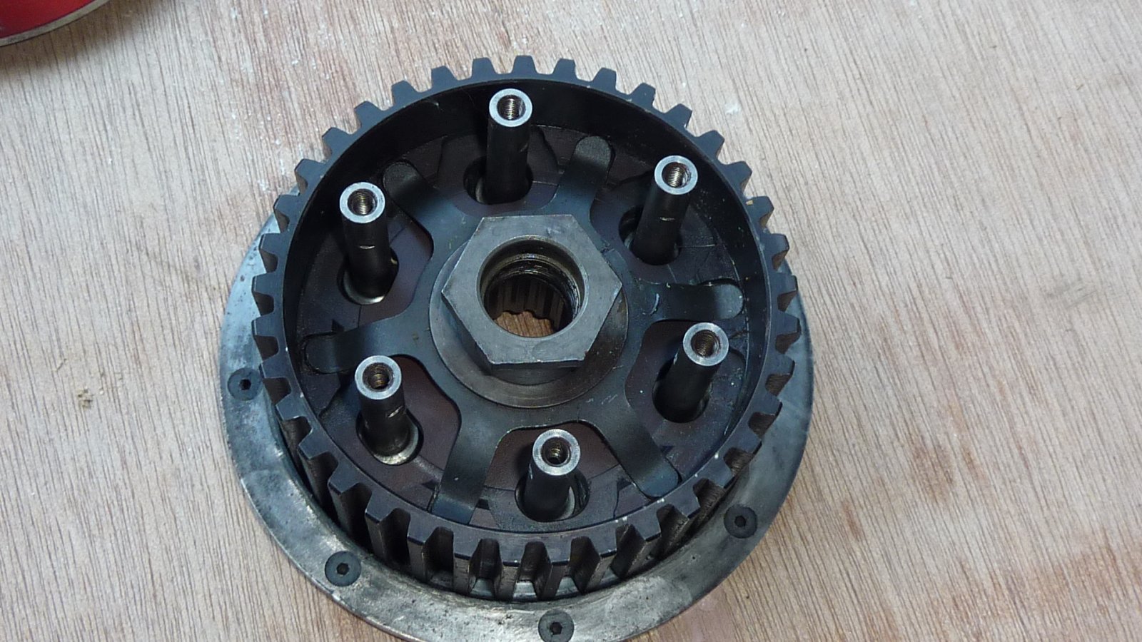

    Theres no receipt for a slipper hub, i think its just the basket with standard plates, hub and pressure plate but I've not taken it out yet,
    With the clutch springs it seems its not much more then finger tight?
  14. That is a disaster waiting to happen so fortunate you found it now. Can't find a torque just says tighten securely. Andy
  15. about 4nm if i remember right from doing mine last year. The pressure of the springs means it doesn't need to be over tight.
  16. Looks like those spring caps have seen some action as looks like 2 or 3 have heavy burrs?, wouldn't be surprised if you have a new drum already as above often means a post or two get sheared off. Be careful tightening clutch screws, better to feel them up rather than use a torque wrench - they only need lightly nipping up as design is a bit lightweight considering it's a regularly serviced item. Many threads on the subject:-
    http://ducatiforum.co.uk/threads/rattley-growly-clutch-repair.32223/page-2#post-714559
  17. Cheers chaps,
    The photo is a bit blurry but a few do have burrs and the two top left screws are a bit ringed off, perhaps time for an open cover and coloured plate /screws.
    Thanks for the link Chris i will have a read.
  18. Check the threads in 6 posts carefully Paul as they often have previous damage i.e. thread could be partially stripped already. It's ok if damaged threads/posts are opposing each other as many owners run with only 4 springs with no problems at all. Not ruling out clutch slip totally but it's unusual.
