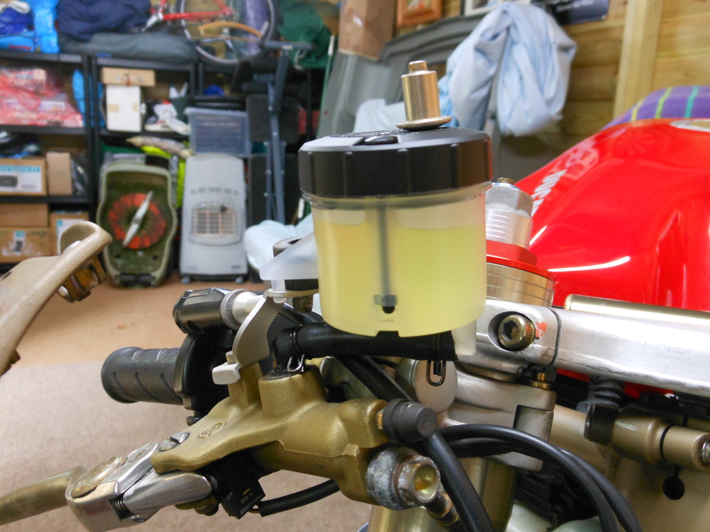

    Changed the brake fluid pot as old one was split around the nuts which the lid screws on and new fluid so job done but have got a new bolt on order which holds the pot to the little bracket as it snapped so drilled it out and put a tap down the thread.

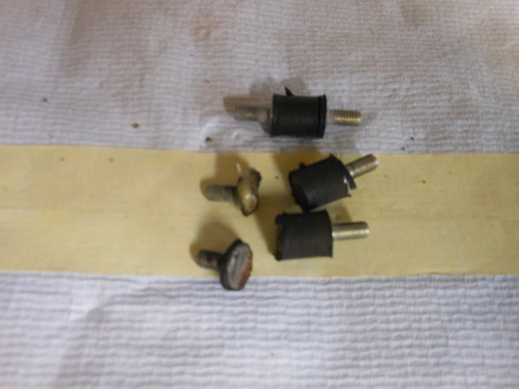

  11. Another little job off the list, (Speedo rubber mounts)
    Someone had glued two of them back together and one is split, no more movement now :)

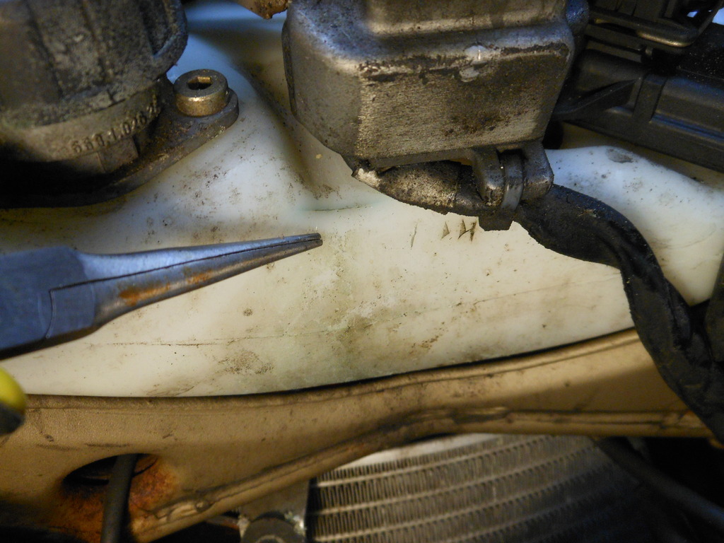

  17. Had the common coolant bottle leak which had split opposite the front petrol tank pin mount and had been leaking down the outside of the airbox then down to the bottom of the fairing and also a bit had worked its way into the airbox from around the rubber petrol tank mount,
    Good to get in there for a clean up.
    New coolant tank fitted and topped up with 1/2 a litre and run up to temp and all good, just need to take it out for a ride,
