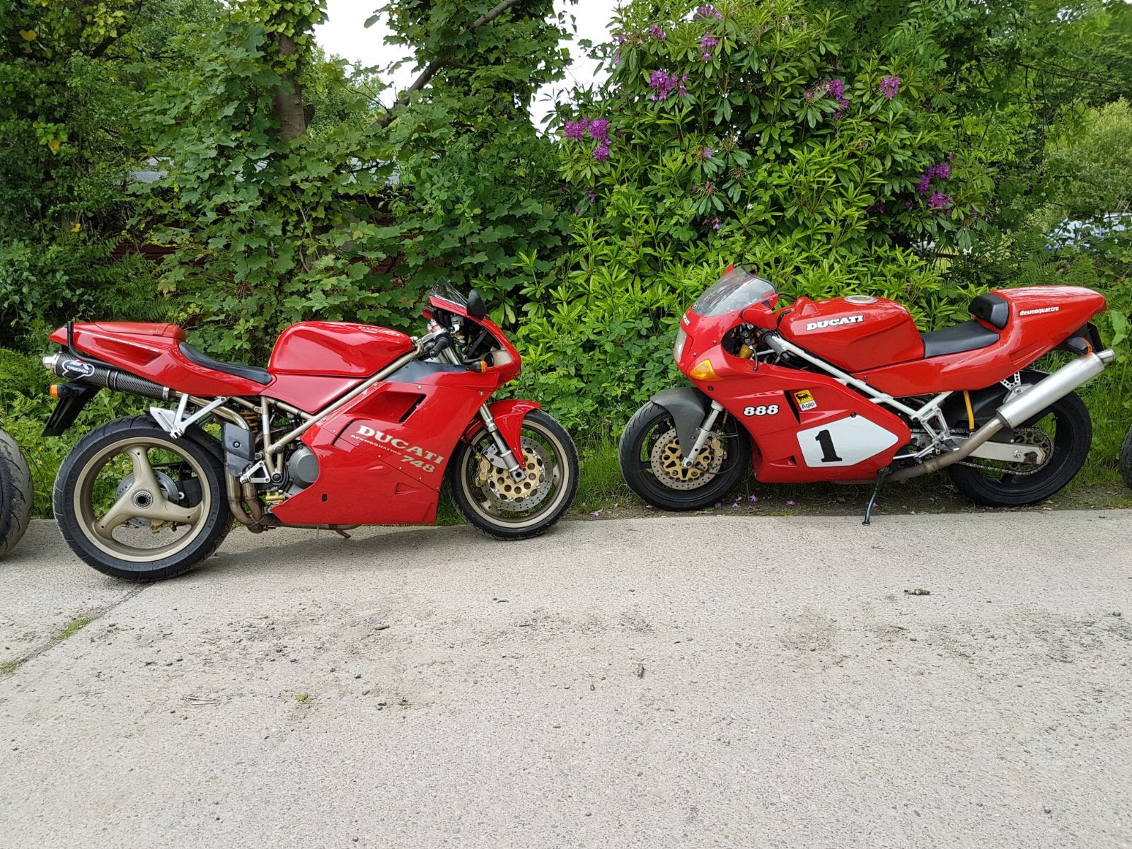

  1. In the thread about the 748 SP I’m building
  2. Dug up the paint codes I found, can't remember which one my painter used:
    Bronze = PPG code 339.7017 or RAL 1035 – finish with satin.
  3. Next job is now here,
    The wheels that came with the bike have been resprayed and are gloss/lighter colour, i have been looking for a pair of originals for a while i picked up a great front and then a rear that was unused or been on a bike for a couple of miles but was just a bit darker but when both offered up to the bike was a good match so i thought that will do, then a matching pair came up with i think an original pair of tyres from back in the day on them which has kept the rims/wheels in great condition and had been stored for a very long time.
