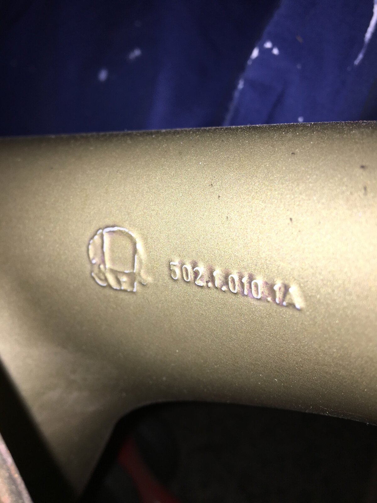

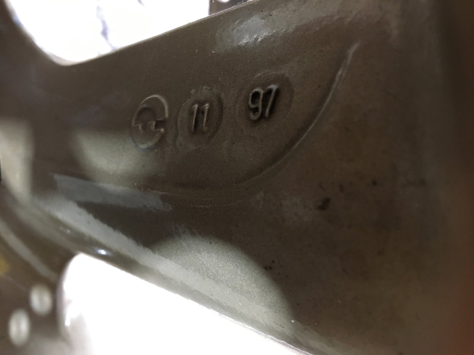

  1. Hi Re:- your wheels, my 748 was first reg on the 13/08/97 here's some pics of my rear wheel, I think mine's 97
    It's nice to see somebody else knows a spade bit from drill bit

  2. Here you are, my V5 states mine is a 748S
    #143 gtg, Mar 8, 2019
  3. Yep thats a 97 a first for me

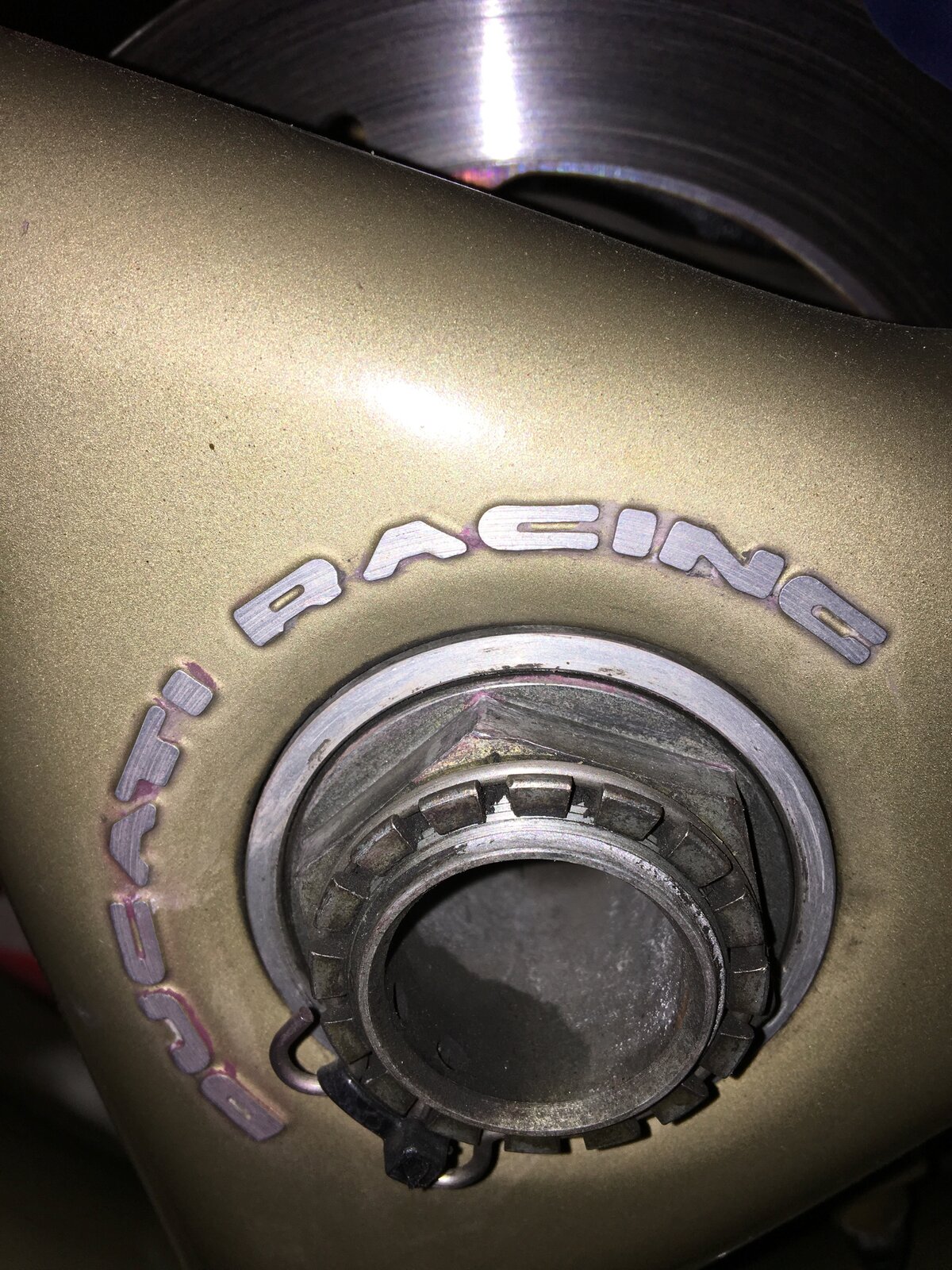

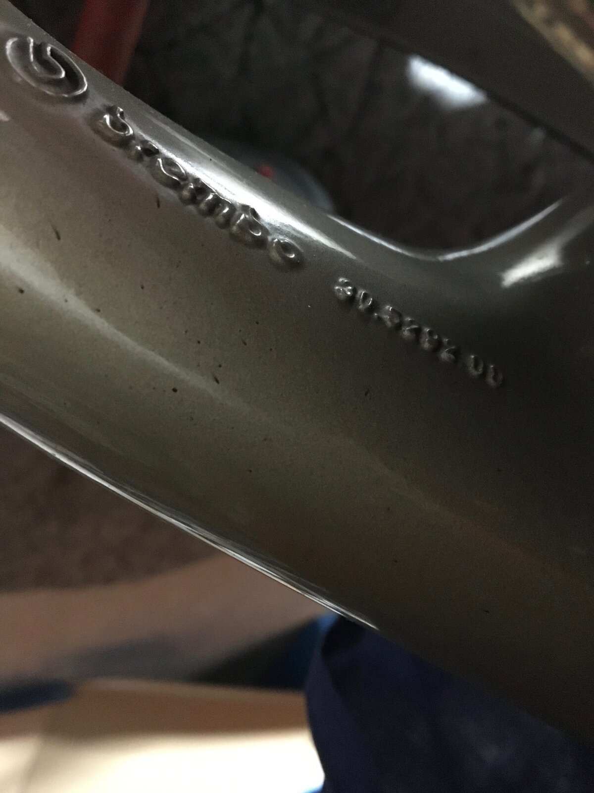

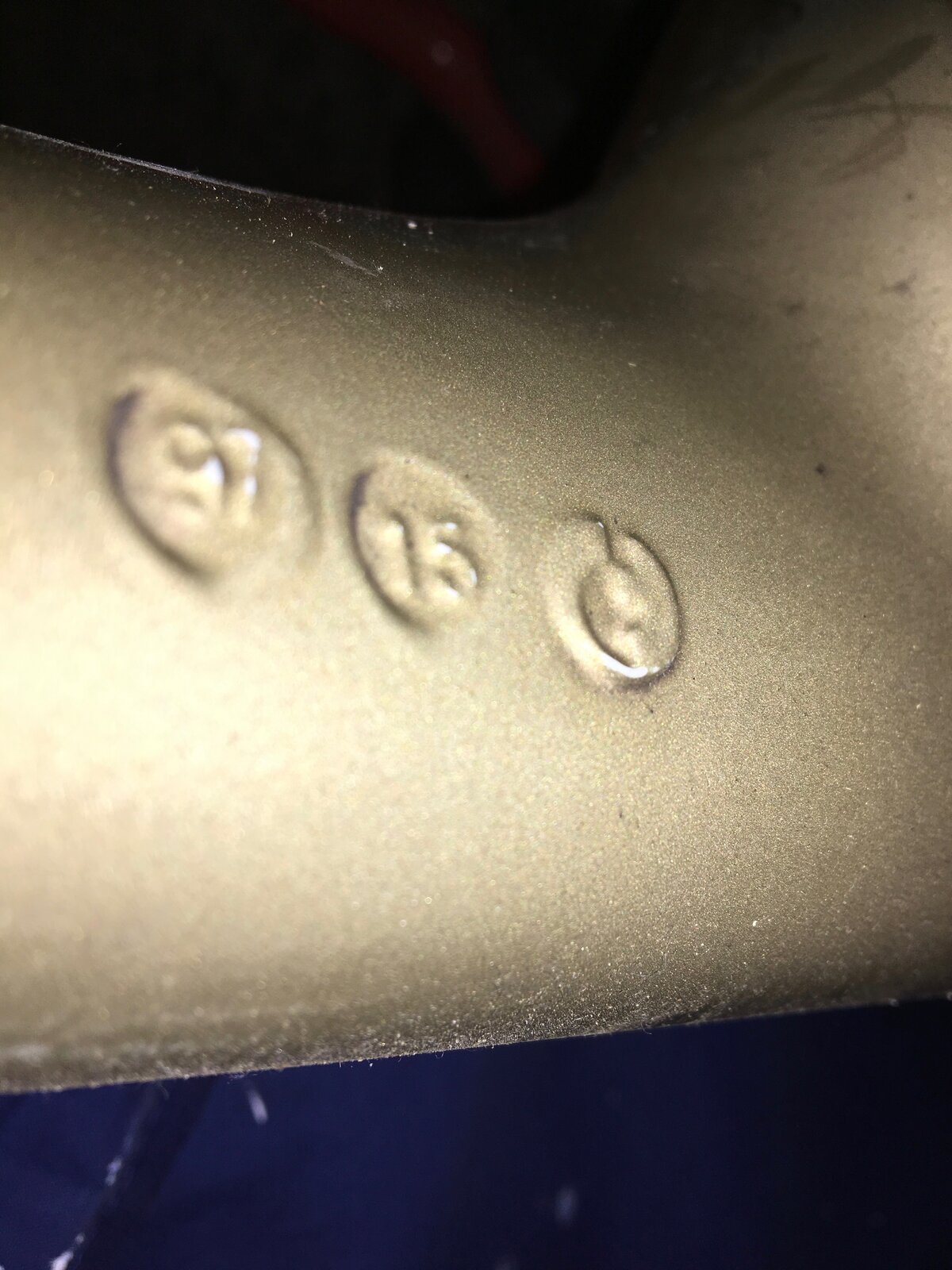

  4. a dumb question how do we know if they are Mag or Alloy
  5. Weight.
  6. cookster you silly old sod that bit i knew, my wheels are still fitted, I was hoping there would be a number on the wheels and I've nothing to compare to, has any body got some info they can post, the weight of with tyres please, so we all can check our's
  7. 748S' weren't introduced until 2000, so does that mean you're wheels were hanging around in the supply chain for 3 years? I would have thought not. Curious.

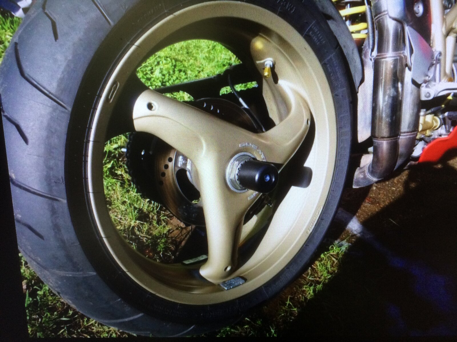

  12. E06FEBCA-09F3-45C2-96BC-E3F61CB7F9D6.jpeg It’s hard to beat the look of the standard three spoke wheel in gold. I submitted a picture of mine front and back to a bobbin manufacturer on EBay, he was just starting out back then some 9 years ago, still using the pictures today.
  13. What make is the rear sprocket please, it doesn't look like the original, I like that polished steel look. TIA
  14. Agree the wheels have a great colour/finish, were as the Grey I'm sure is more of a gloss finish. Do you still own the bike Chris.
  15. Both sprockets are JT and its a DID chain,
  16. It’s long gone sadly but still have a 996 and many 748 bits, probably enough to build an engine but I bet I never get round to it.
