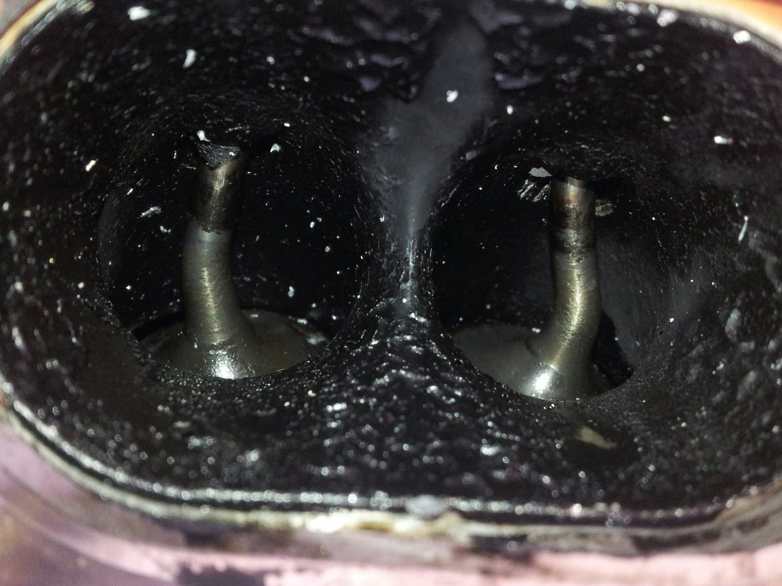

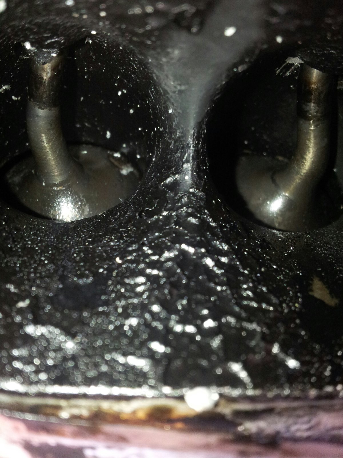

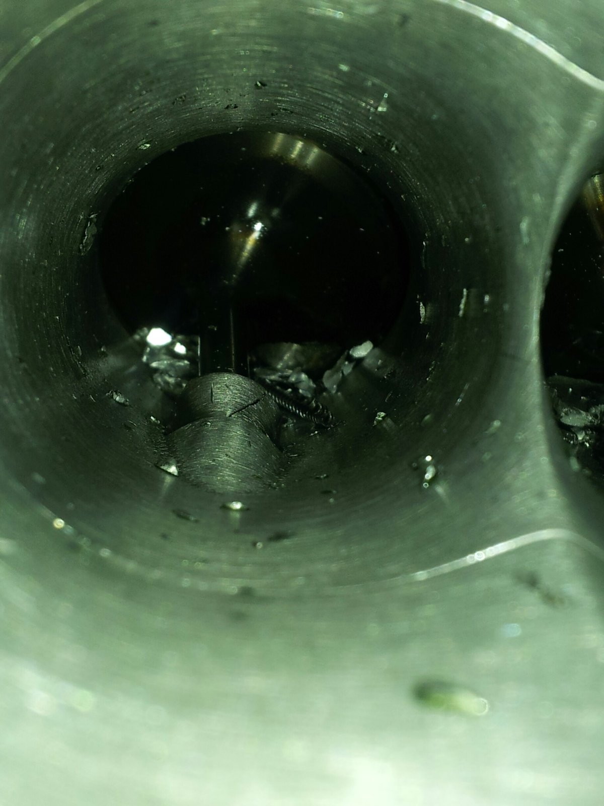

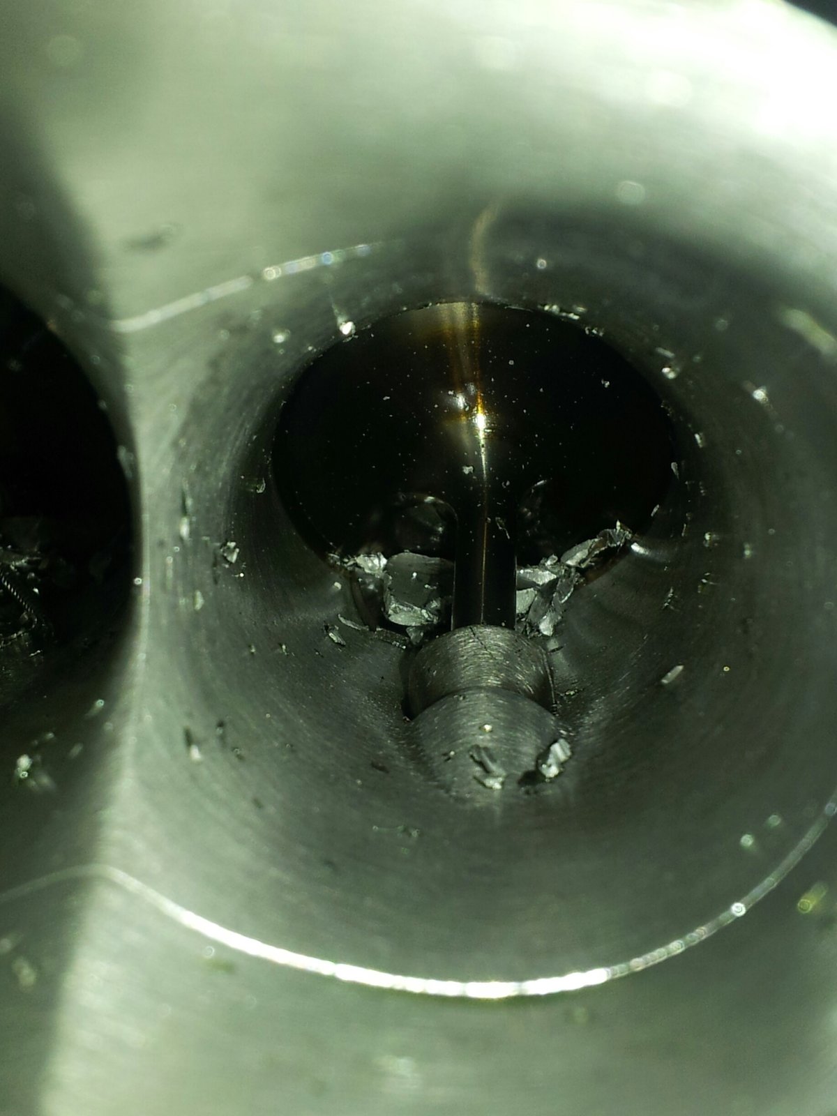

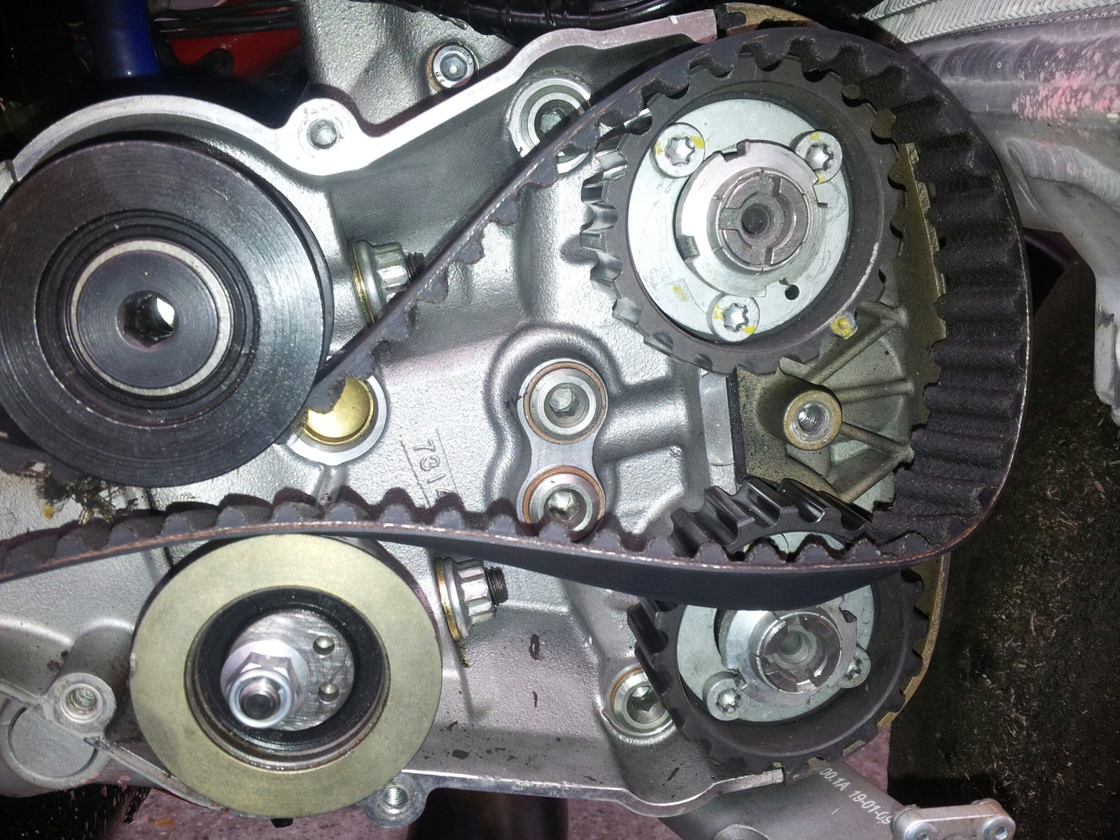

  11. Cheers Paul, managed to scrub speed off and pull over to the grass at the side of the straight. didn't want to touch the brakes too much, as I didn't know if the tyres got oil on them. The belt is in one piece, it jumped off due to the cams locking up. Tensioner nut is tight and pulleys free to turn.
    Luckily all parts remained inside.
  12. No inferno then?
  13. Nah, big smoke cloud out of the exh
  14. That’s what I feared, given AndyB cryptic Red Adair comment.
  15. i recon piston failure........that hit the valves, that then pinged off the belt.
