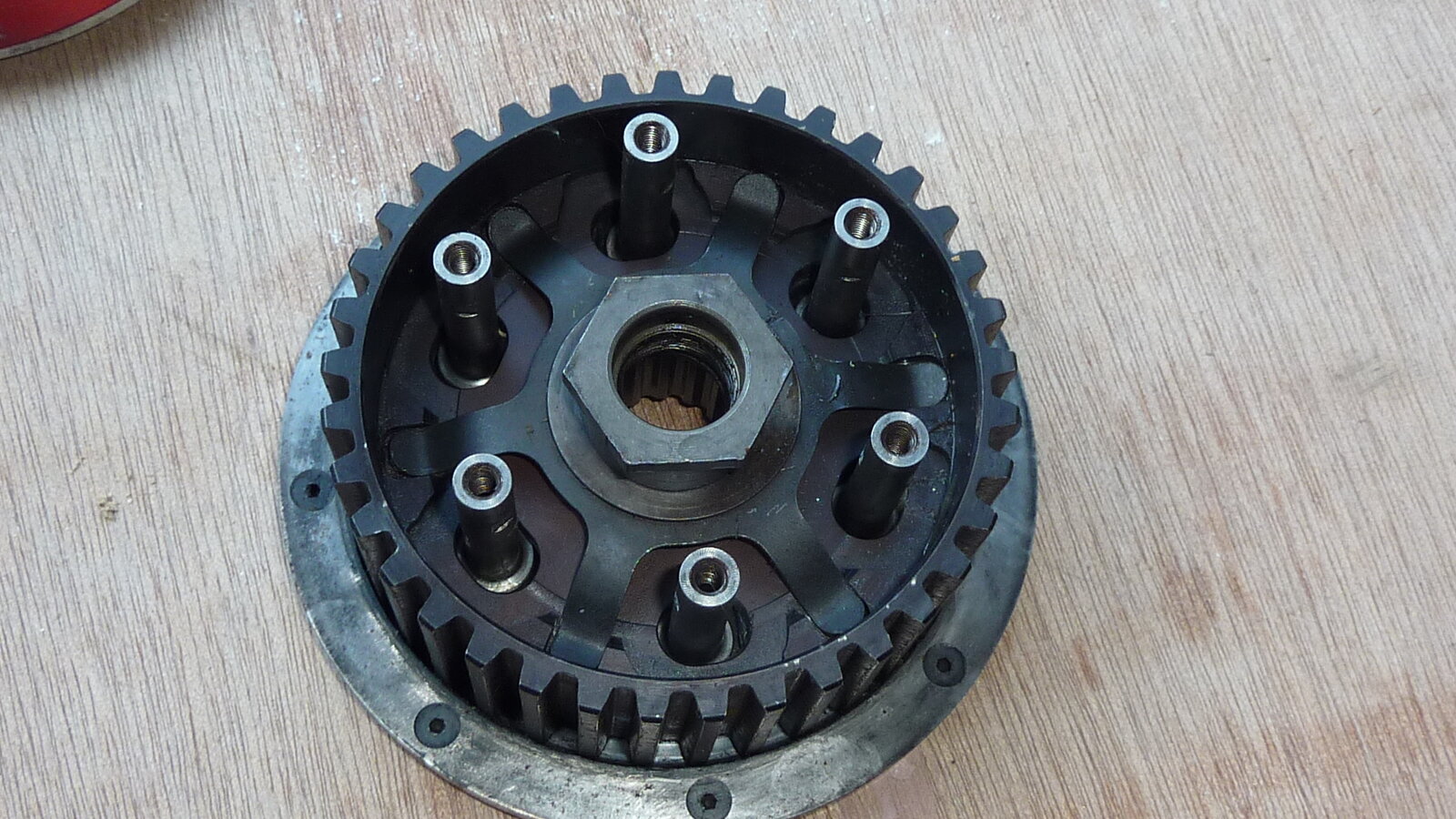

  4. Thanks Steve - I am wondering if over the years my clutch has morphed into a hybrid? What do you think?
    Here are the components of a fairly standard slipper clutch. I wasn’t looking properly at your photos previously. I don’t know the correct terms in English to describe the parts but you can see that the part (hub?) to the left has elongated holes in it, enabling it to move (rise up) from the plate behind it on ball bearing equipped ramps built into the plate and thus disengage drive ‘slip’ under heavy engine breaking instead of locking up the rear wheel.
    In your clutch, the six posts that the springs fix onto are fixed into that central hub your clutch cannot move in this way and you would have to control your engine breaking via the clutch lever.
    If you have the budget and/or are planning to use on track, invest in one. It’s one of the best upgrades available!
    Sorry I didn’t look properly a minute ago.
  6. Just looks standard to me, May have had a replacement basket but that's all.
    Steve

  9. That’s definitely a standard clutch. Yours should have a slipper clutch. Mine certainly did. The OEM slipper wasn’t very good, though. Only three ramps, and no ball bearings. Mine needed lots of maintenance to keep it working well. I replaced mine with a six ramp with bearings Sigma Performance jobbie that I got from eBay. Your basket and plates look brand new. You’ll have to ride it a lot before that classic clutch rattle can be heard.
  10. yes, didn't want to go there Steve, but you're right, aftermarket pressure plates, springs, caps, baskets and slave cylinders (and more) can all "creep" away from std dimensions turning what should be simple setting-up into a nightmare.
  11. Its a bit of a hybrid according to my dealers.
    The basket and plate set are for the standard slipper clutch used on the 748R.
    The centre hub and pressure plate are not slipper clutch components.

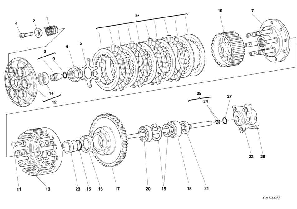

    Think its had a bit of a transplant somewhere in its life. The clutch boss is someway north of £700, so I think I will leave it as it is (gulp).
    Standard R diagram here:
  12. The baskets are the same for both slipper and standard, it's only the center hub that differs.
    Steve
  13. ....Although the part numbers differ from standard to slipper for the basket. The one in mine is the lightened vented one, the standard is not vented?
    Dealers told me that back in the day, it was not uncommon for people to swap out the slipper for a standard clutch as they took a lot of looking after (@razz ) and some people simply prefered a non slipper. Costly (VERY) to change back.

  19. @Expat Jack, been off the internet this morning so only just picked up your tag. Just about everything said that could be except the clutch centre you have fitted is date stamped 1992 and the 748R slipper clutch didn't exist then. Sad to say a previous owner has cut corners to save money. You have options but the original 748R style 3 ramp slipper was the only one that had the clutch basket and centre made in steel, the later 6 ramp and ball slipper clutches might be cheaper but used an aluminium alloy basket and centre which wear out quicker. My 748R slipper is less sensitive to set up than my 1098R slipper which is a bitch to get right. The 748R slipper might be 'basic' but I've never had an issue with mine, when it's kept clean. Andy
    #39 Android853sp, Oct 22, 2019
  20. Very good spot on the ‘92 Andy.
