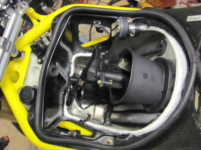

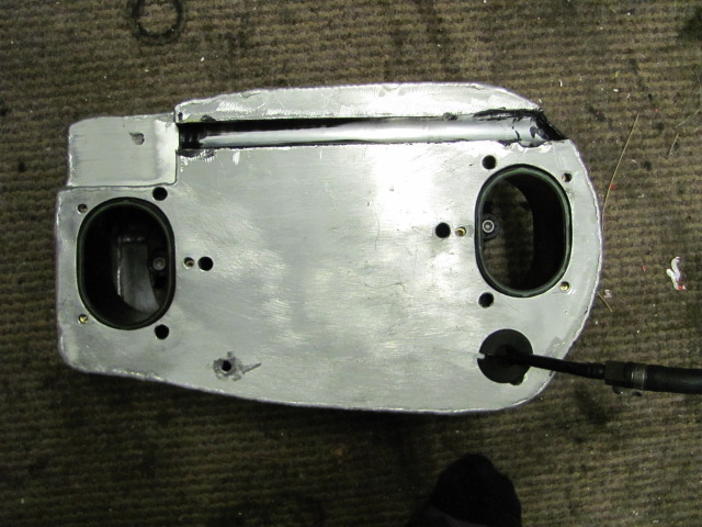

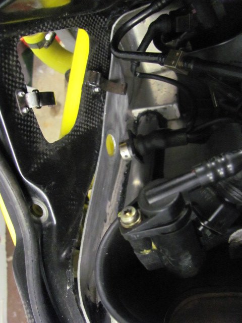

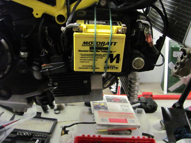

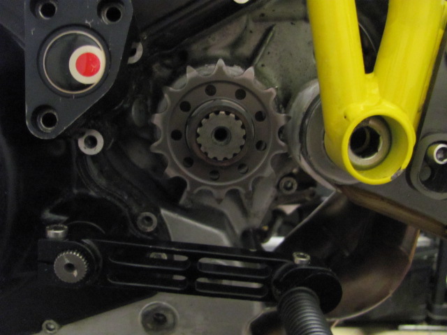

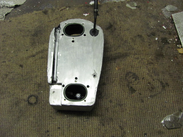

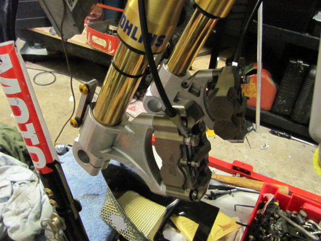

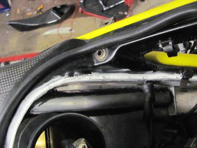

    Coolant lines all tight, though now not so pretty (I will improve eventually). Battery and reg rect all mounted. Another sprocket installed with correct retaining bolt. No quickshifter for this blighter yet so a standard race pattern lever in use, and a new rear brake lever to match.
    Recess made in airbox for throttle linkage and siliconed together ( damn I wish I could weld alloy at home).

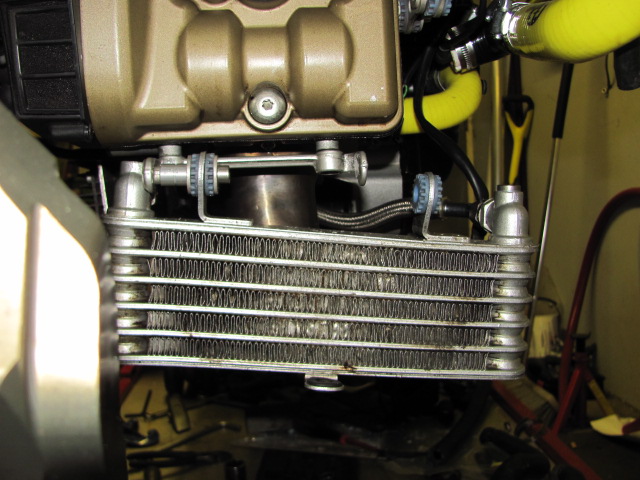

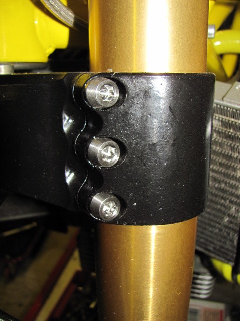

    And titanium goodies put in lower triple clamp. As Neslon has pointed out the oil cooler doesn't sit centrally on the evo heads, so I started on the little job of getting it central.

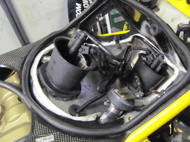

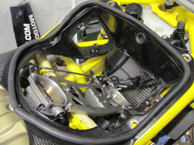

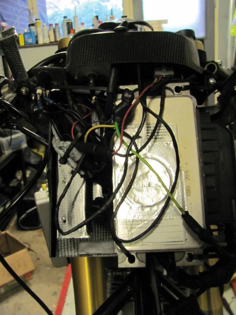

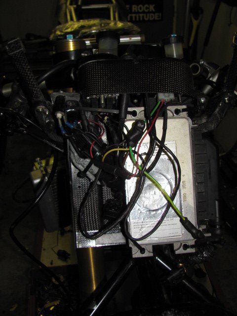

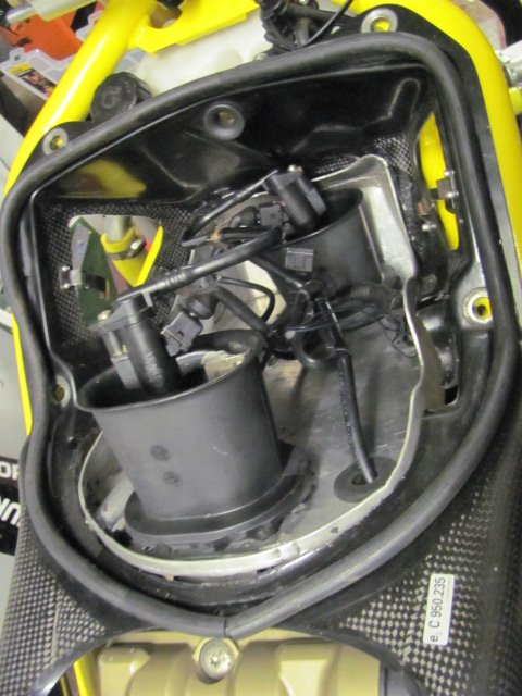

  4. So the airbox and throttle bodies are in. I also made an attempt to tidy up the wiring loom at the front. Smal steps and all that.
  5. All most fire up time...:Cigar:
  6. I turned it over from the starter today, wahoo! Just need to connect up the coils and tidy a few things up.

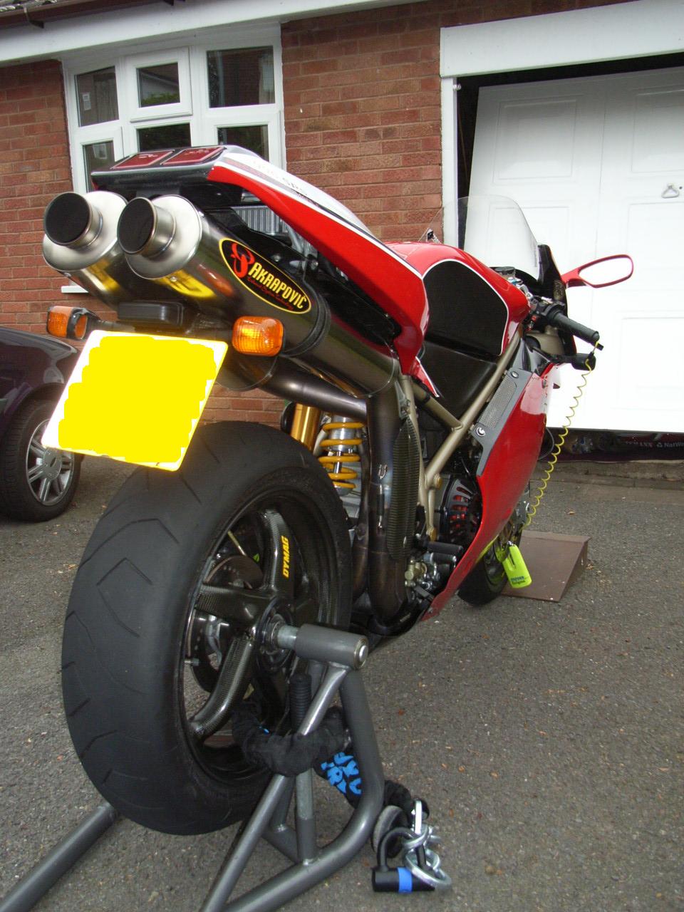

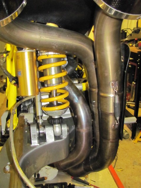

  7. Well, it runs! I fired her up just five minutes ago. A bit smokey so I will check my TPS connections in the morning. The re-valved shock is due back next week..............then its time for fine setting up on CJS's dyno. Then Ducati Trackday at Donnington, The yellow smokey (!) thing tramping around the track will be Yellow Shed MkIII with me aboard. :Happy:
  8. Top bombing. Lets hope it can keep up with my upright touring numpty lol
  9. Looks great with some real nice kit there and I thought that exhaust looks familiar as I sold it brand new to matt.Good news is its the quieter version than the one I have so should be better for Uk trackday restrictions on noise.
