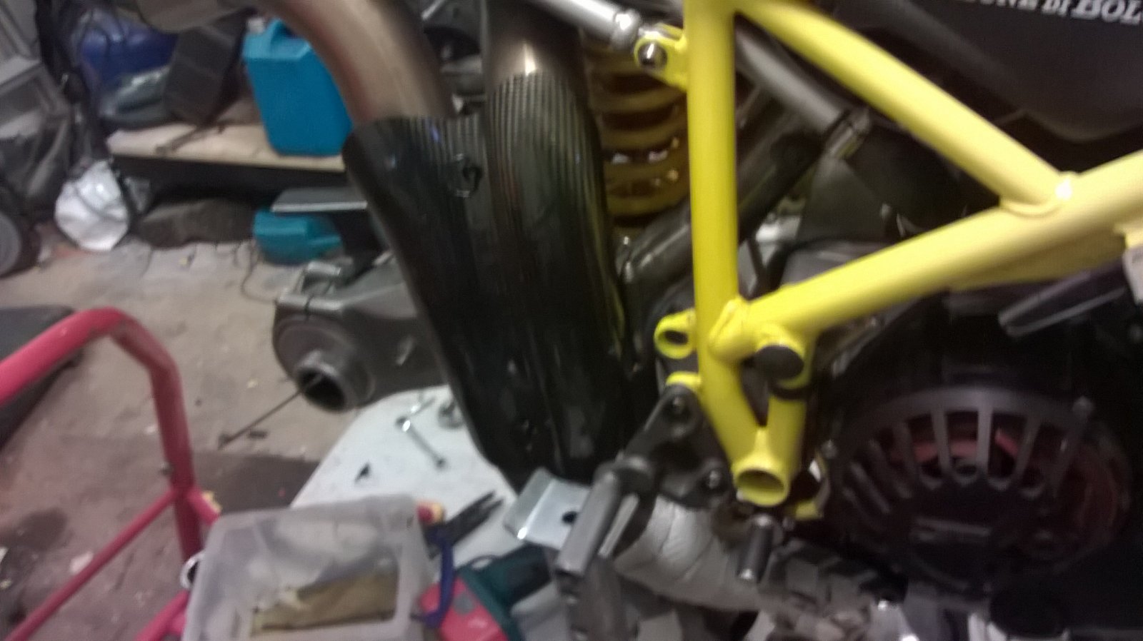

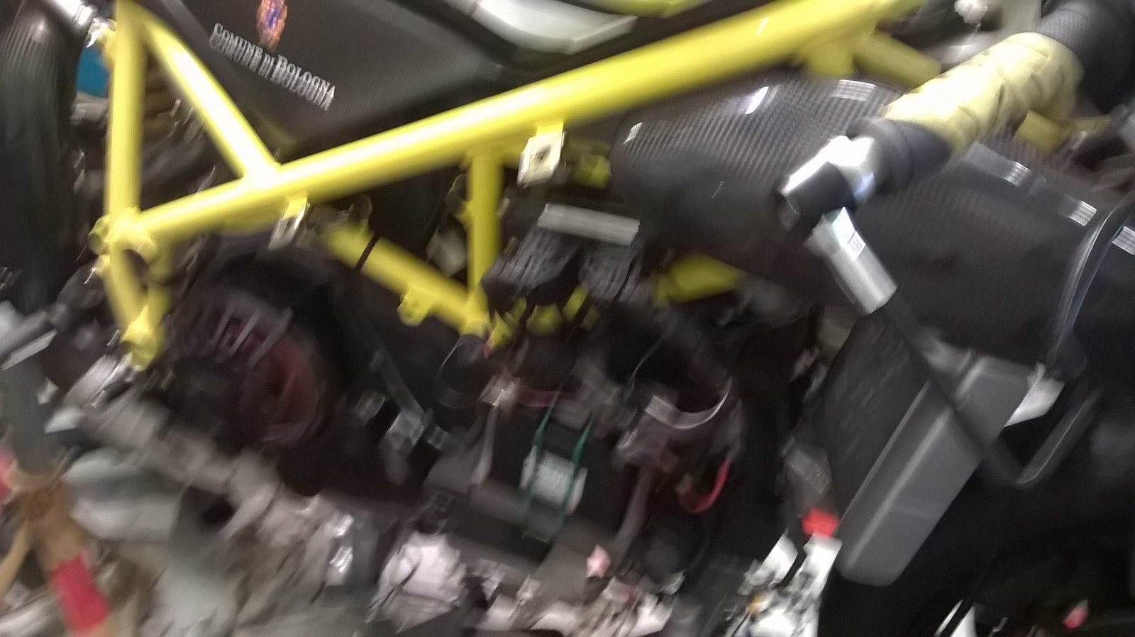

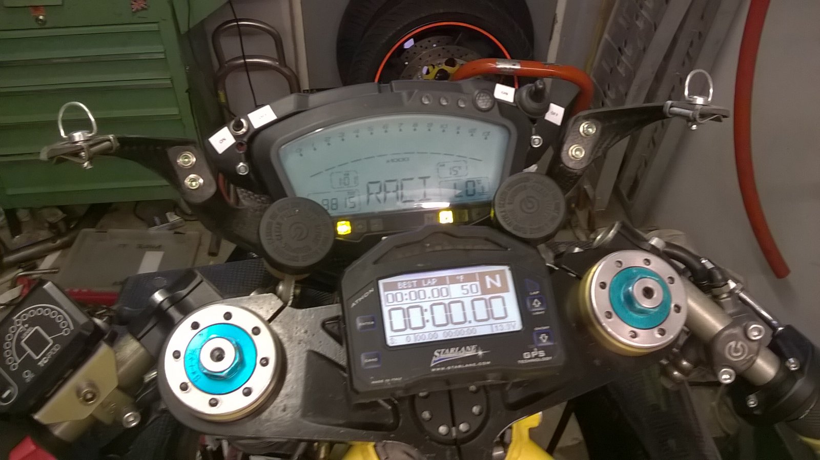

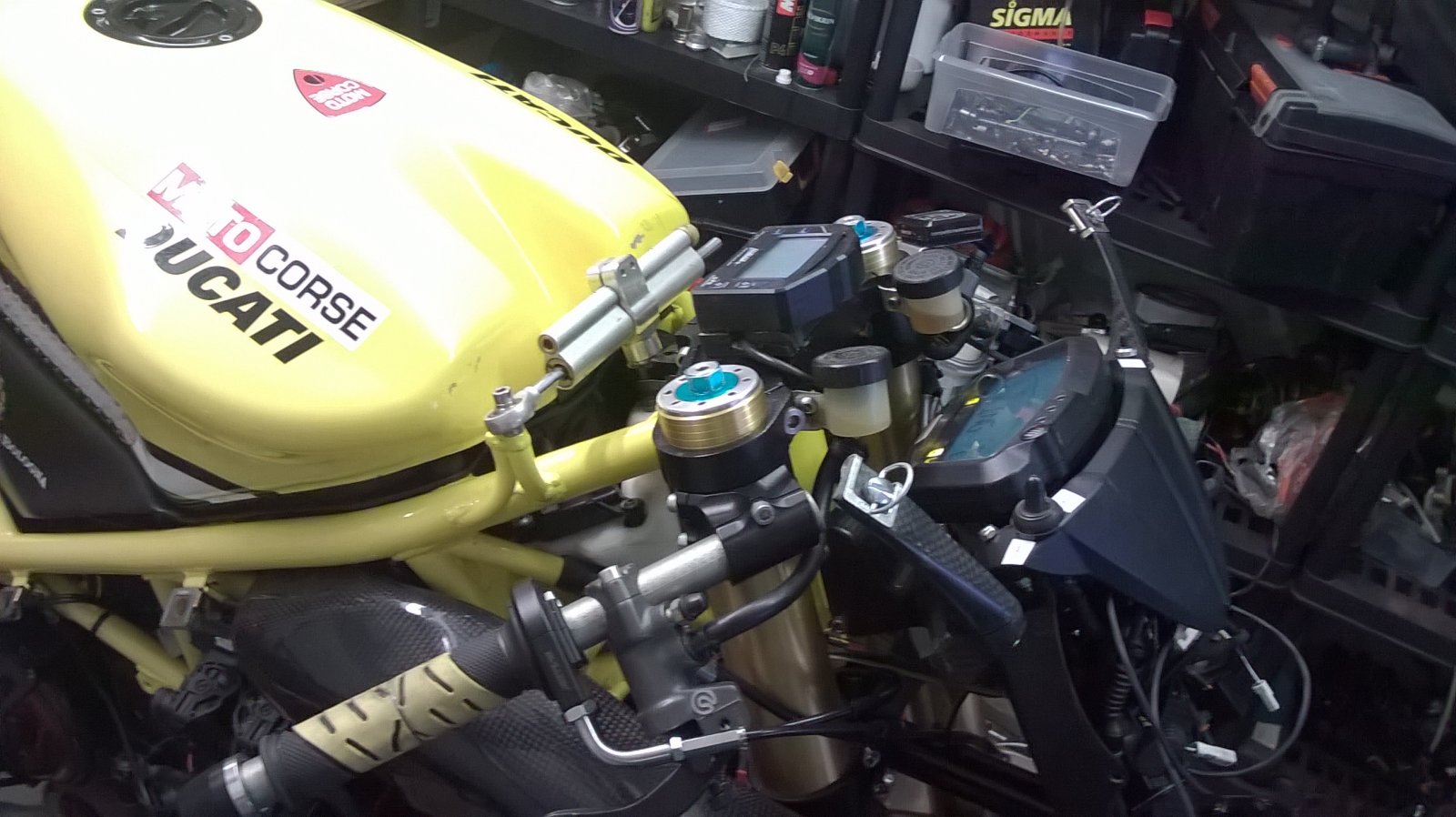

  3. Starlane GPS laptime and shift light fitted on top clamp, ignition and rain light switches fitted in dash surround. TCS TC pod fitted on clutch lever mount. WP_20150131_002[1].jpg 10mm closed cell foam used to lift the GPS unit of the top clamp, the pain in the arerse unit has a rear entry cable so needs that little lift.
    WP_20150131_003[1].jpg Blurred buggery. WP_20150131_004[1].jpg WP_20150131_005[1].jpg The rain light is mounted on a piece of junk aluminium and off centre. What a waste of effort. Time to re-plan and re-execute in a more professional manner. The wiring is done though, on its own little circuit with the on/off switch up front.

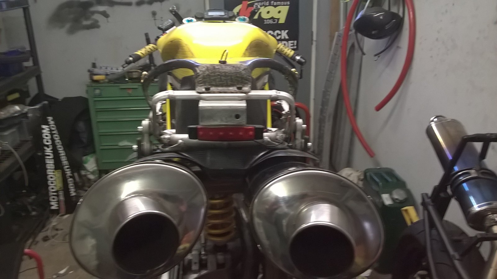

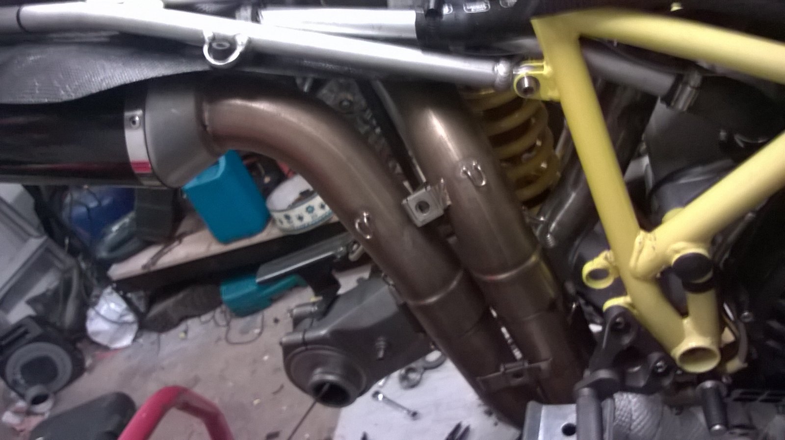

  6. what cans have you used and why are they twisted outwards as it were....
    • Disagree Disagree x 1
  7. akrapovic evo cans, mid section and back half of headers - custom exhaust port sections. I guess they are twisted because they are.
    matt corse owned the system in the past I believe

  11. Did @bradders fit them.........

  12. WP_20150131_006[1].jpg WP_20150131_007[1].jpg No its how they are fabricated. Bradders would try to fit to his van - as windscreen wipers
    #71 Cranker V2, Jan 31, 2015
  13. Can you not get the pipes cut just before they go into the cans, then twist and re-welded?
  14. I could, but I'm happy to have a sad face for now. The hangers are made to for the position they are in too. So thay would need to be changed - more buggerance.

  17. The cans are as designed originally. Not damaged, not modified from mid section back. It would seem there is no problem, just a matter of taste. I am happy enough with them, they are not run of the mill termis after all. ;)
