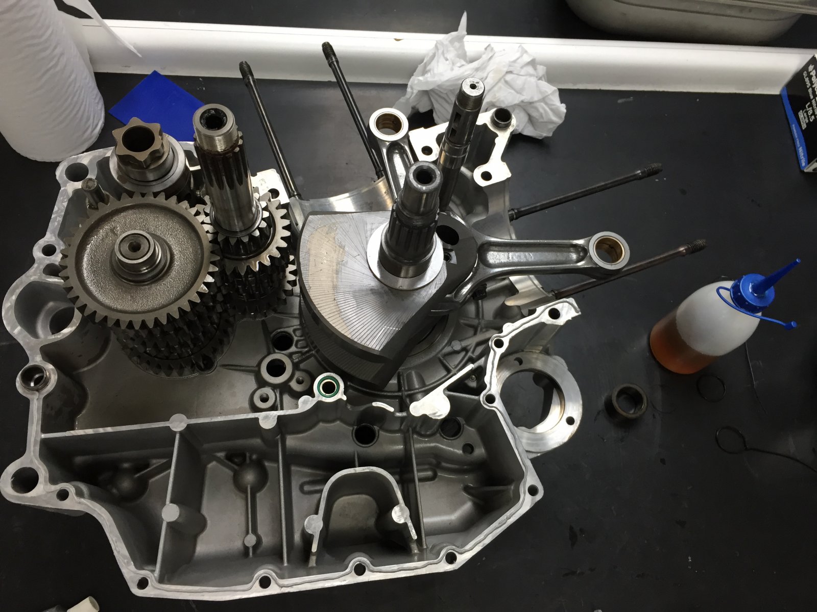

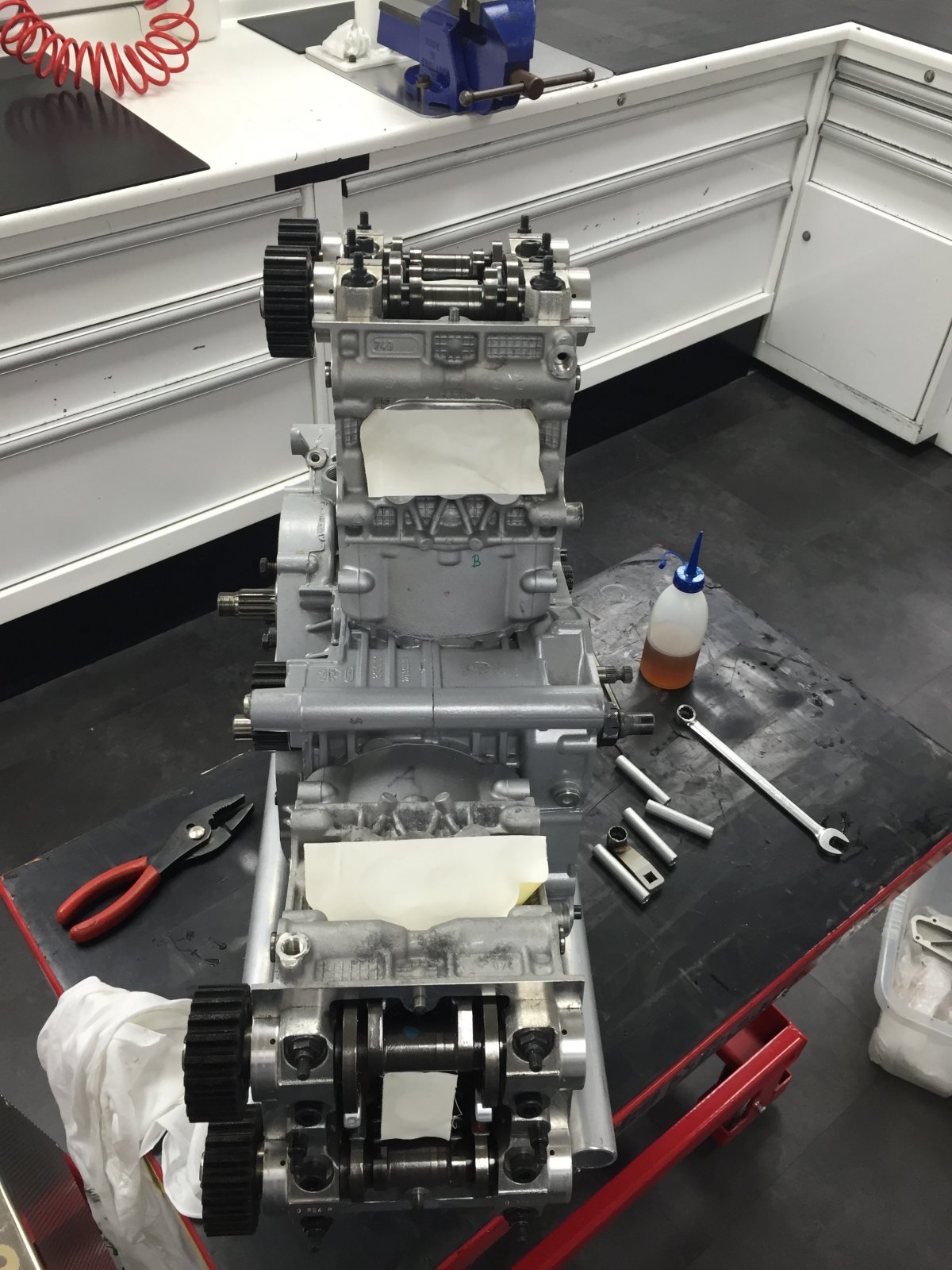

  2. A productive lunch time at work image.jpeg and some photos of the old n new. image.jpeg image.jpeg image.jpeg
  3. if you got the crank out id definatly get it and the rods balanced, proberly the best mod you can do to an engine.

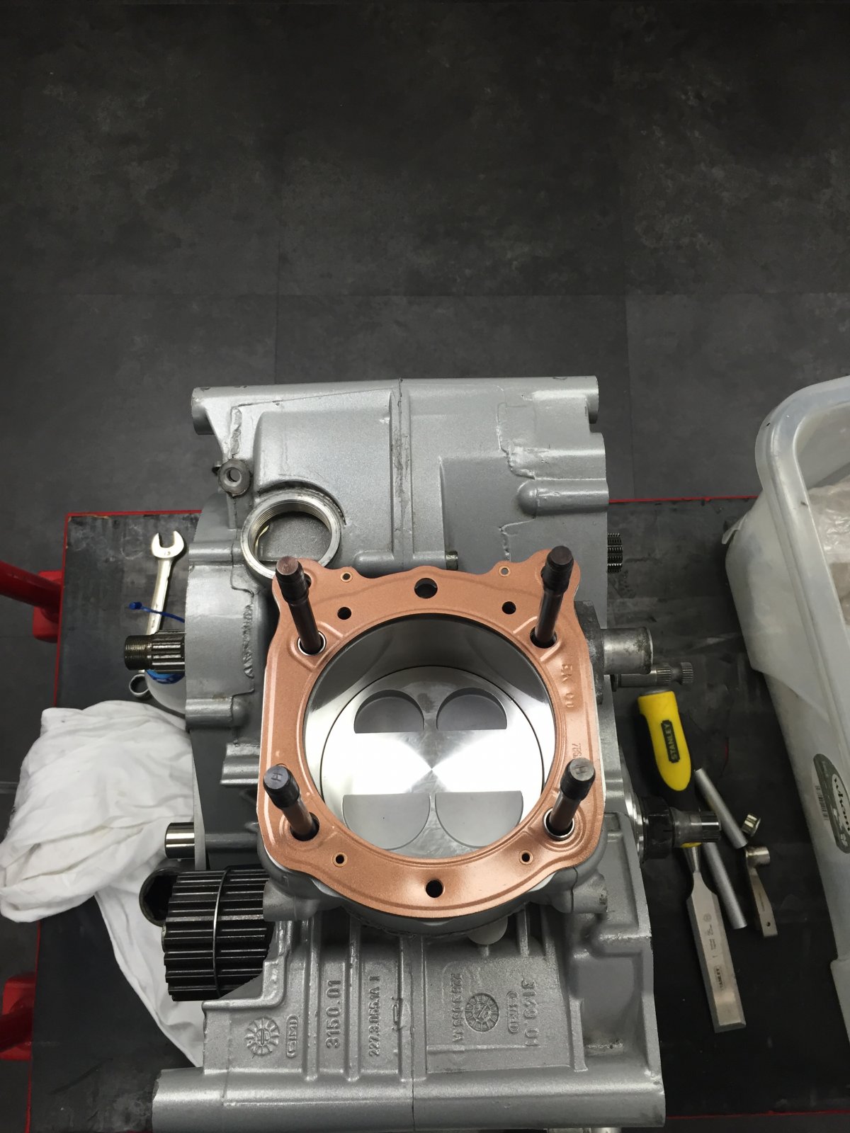

  4. image.jpeg image.jpeg image.jpeg image.jpeg Some more progress photos.
    Just need to finish off behind the side covers and fit the belts and set the valve timing.

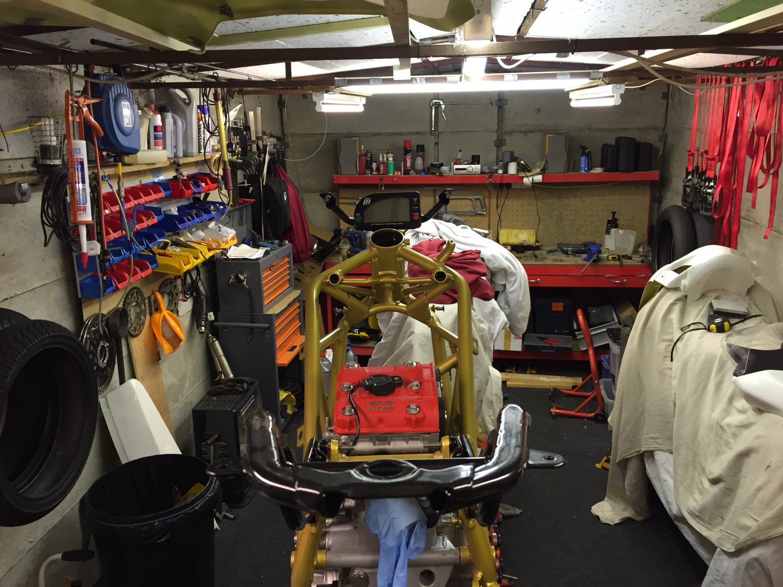

  5. Your workshop is almost as clean as the motor.
    Lovely looking job.
    What's the chisel for though?
  6. I use the chisel as a gasket scraper. It's razor sharp and if used carefully won't mark the casings.

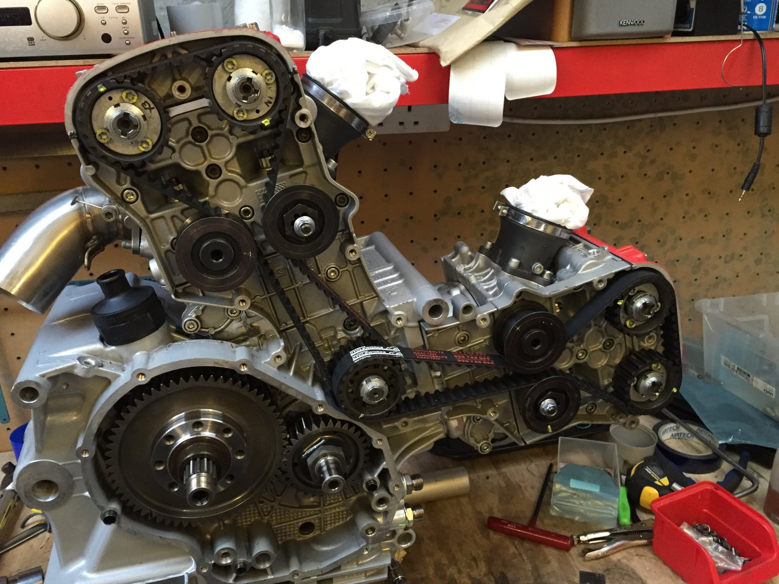

  7. More. But steady progress on the Motor build
    Cam timing is now dialled in and the top end is buttoned up.
    Next up is to finish off behind the side covers. Then strip the bike. image.jpeg image.jpeg

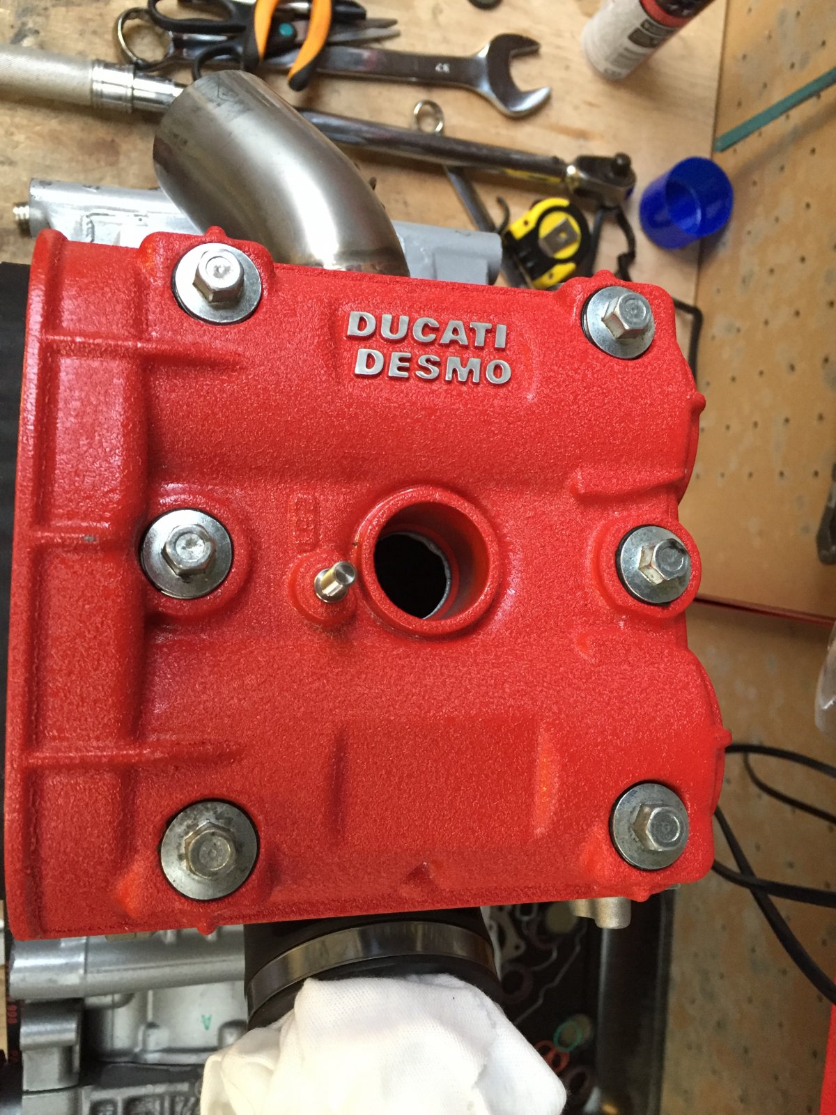

  8. Love the red cam covers
  9. :upyeah: Nice crackle
  10. The crackle took a few attempts. Too much paint and they looked like a sunburnt scrotums. Not enough and they looked like red eggshell. But pretty pleased with the results. However I imagine they'll be a bitch to keep clean.

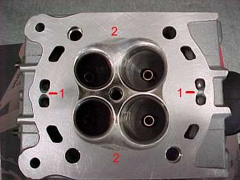

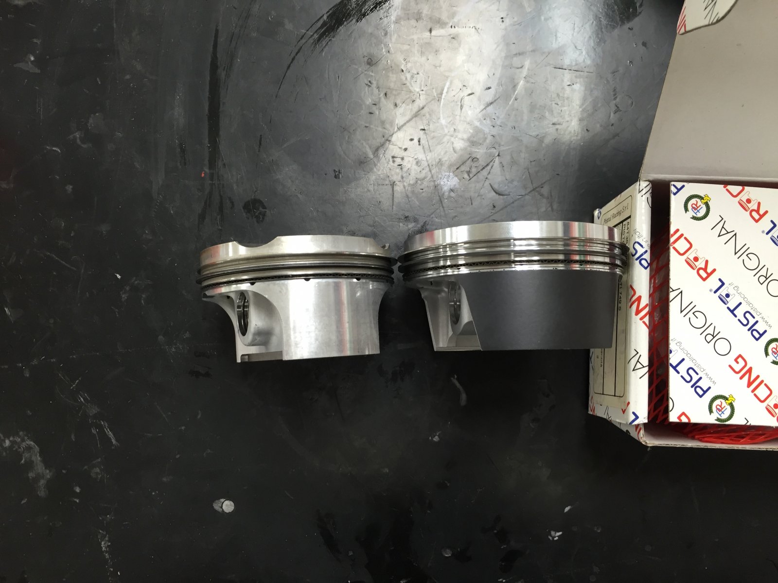

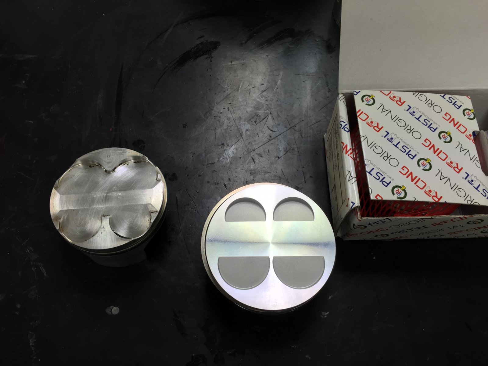

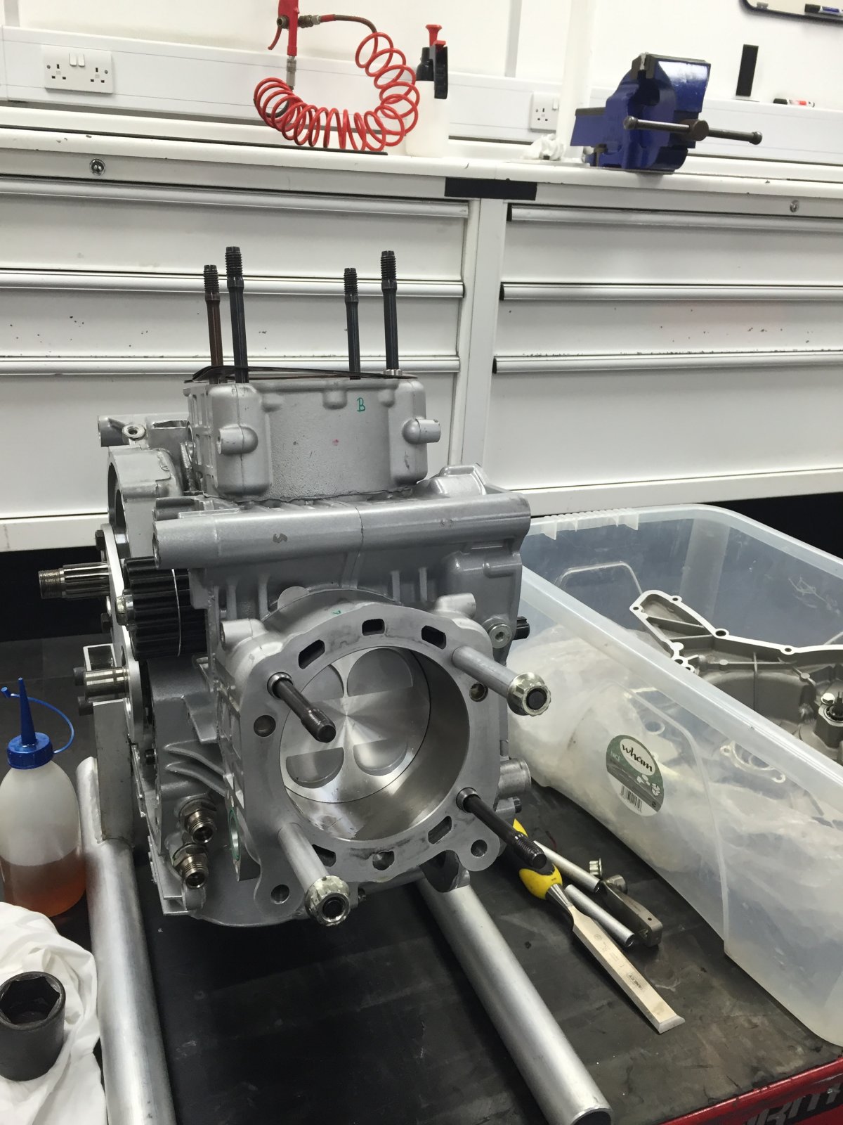

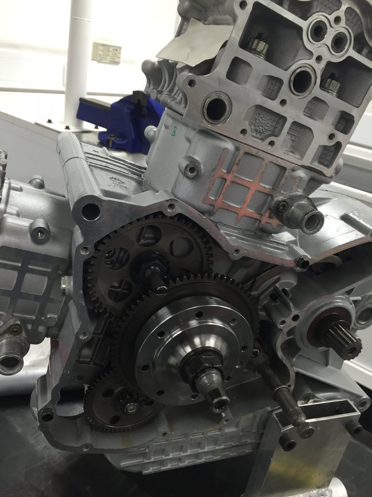

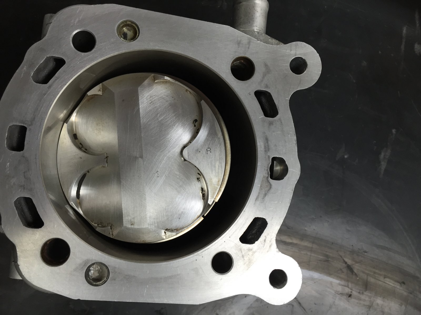

  11. Piston were direct from Pistal €600
    749s heads. Seats recut and throats opened. Ports cleaned up. And the mods to the water passages and head gaskets.

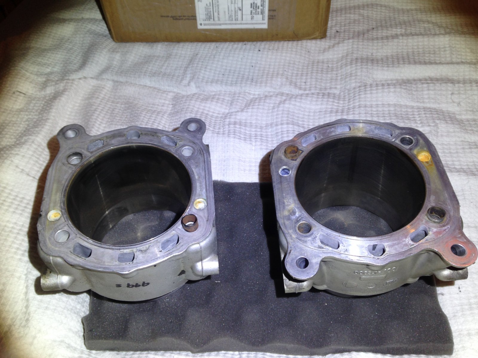

  12. The 999 barrels came off flea bay and were in excellent condition all I did was a very light hone/de glaze. To help bed the new rings in.
    The mod to the head gasket is to increase the width of the water passage where I've had to knife edge the head passage.
    I compared the the 749 & 999 gaskets and that's the main difference.
    Bare in mind I'm not referring to lapping the valves in. I've had the profile of the seat and valve re-ground.
    I don't have a seat cutter. But I do have contacts at Northampton engine services. Who help me out once in a while:)

  13. The mod to the combustion chamber is to open the obstruction and allow for free flow where the 749 cylinder would be. There is no issue of interference with the Pistals.

  15. So you sourced the 999 barrels or did they come with the piston?
    One thing I'm interested in is that the water galleries aren't opened up on the 999 gasket and barrels and also why the 749 head gallery divides, because your head mod essentially removes the split to all low the 999 gallery to flow.
    Did you cut the valves into the seats yerself?

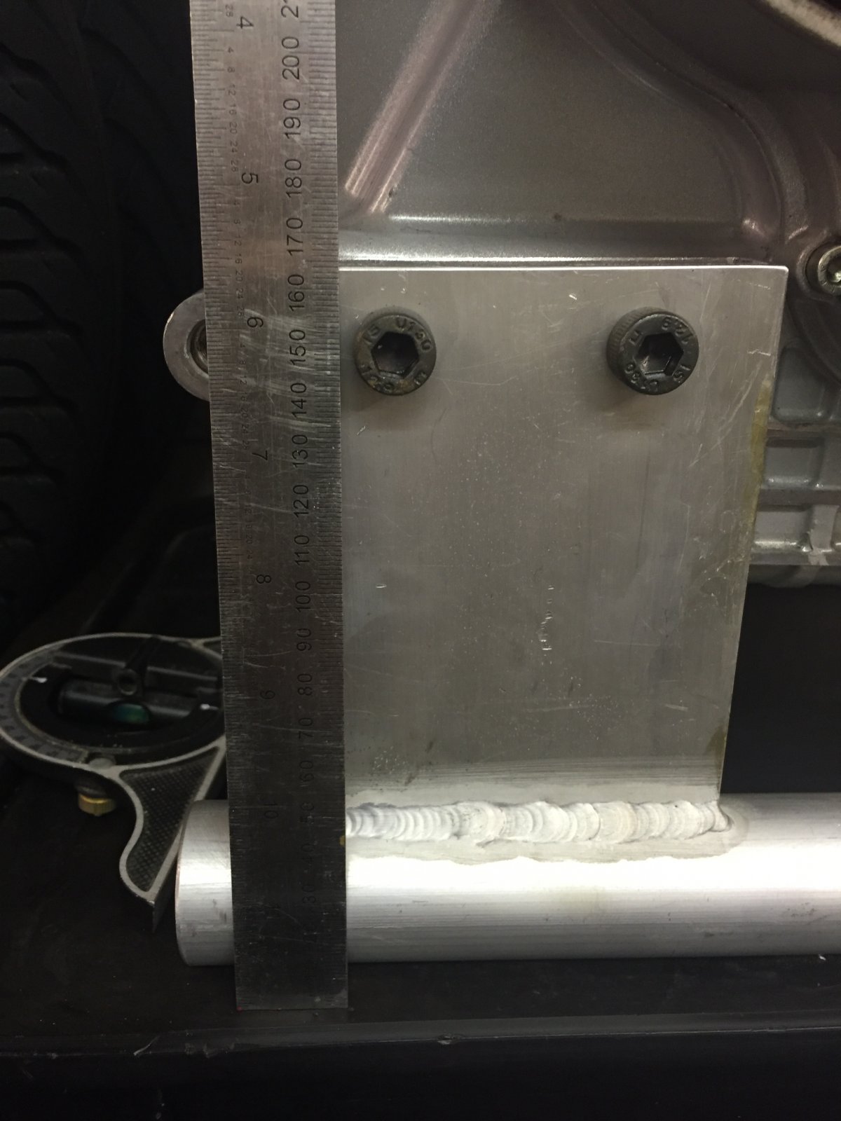

    Also any chance of those take off point dimensions on your mounting stand

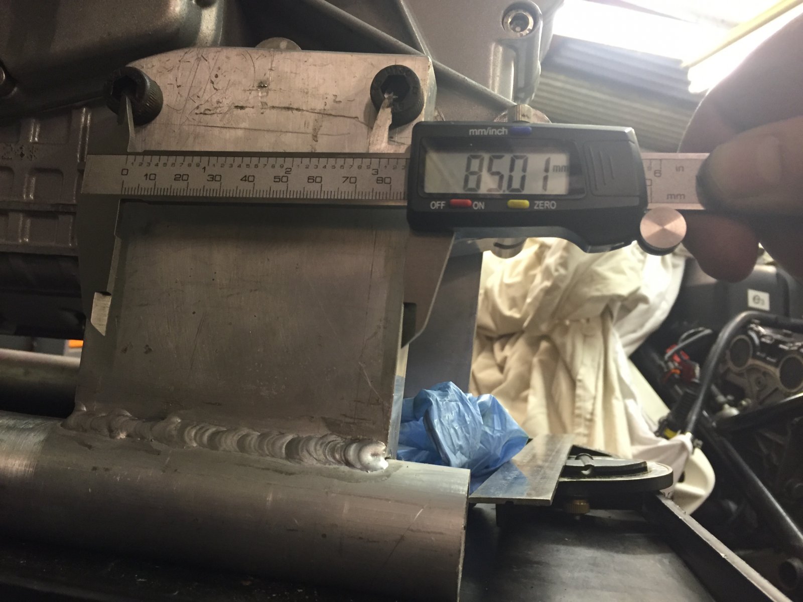

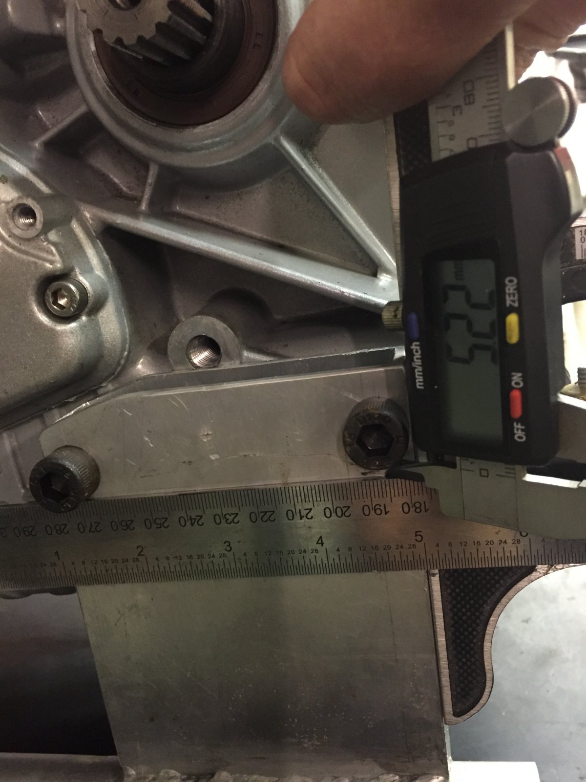

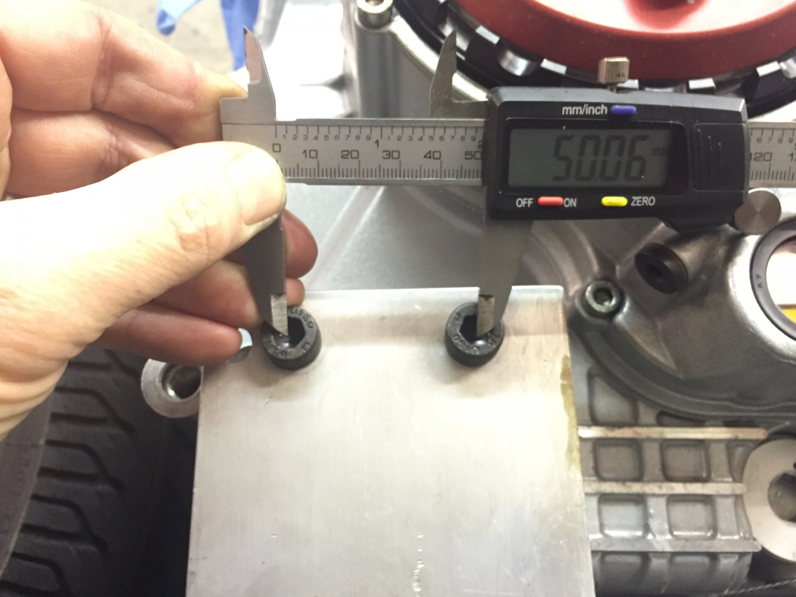

    image.jpeg 50mm hole centre's
    image.jpeg 150mm z height image.jpeg 85mm hole centre's image.jpeg Rear z height 150mm front 145mm.
    I drilled everything .1 over to give some clearence.
    Please excuse the crap welding. I was short of time and didn't clean prior welding.

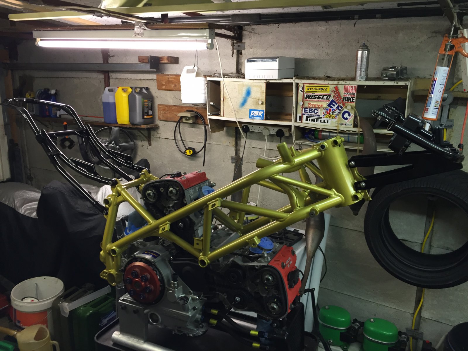

    Let the 924 build begin
  19. Nice frame colour! Brave, but still like it!
