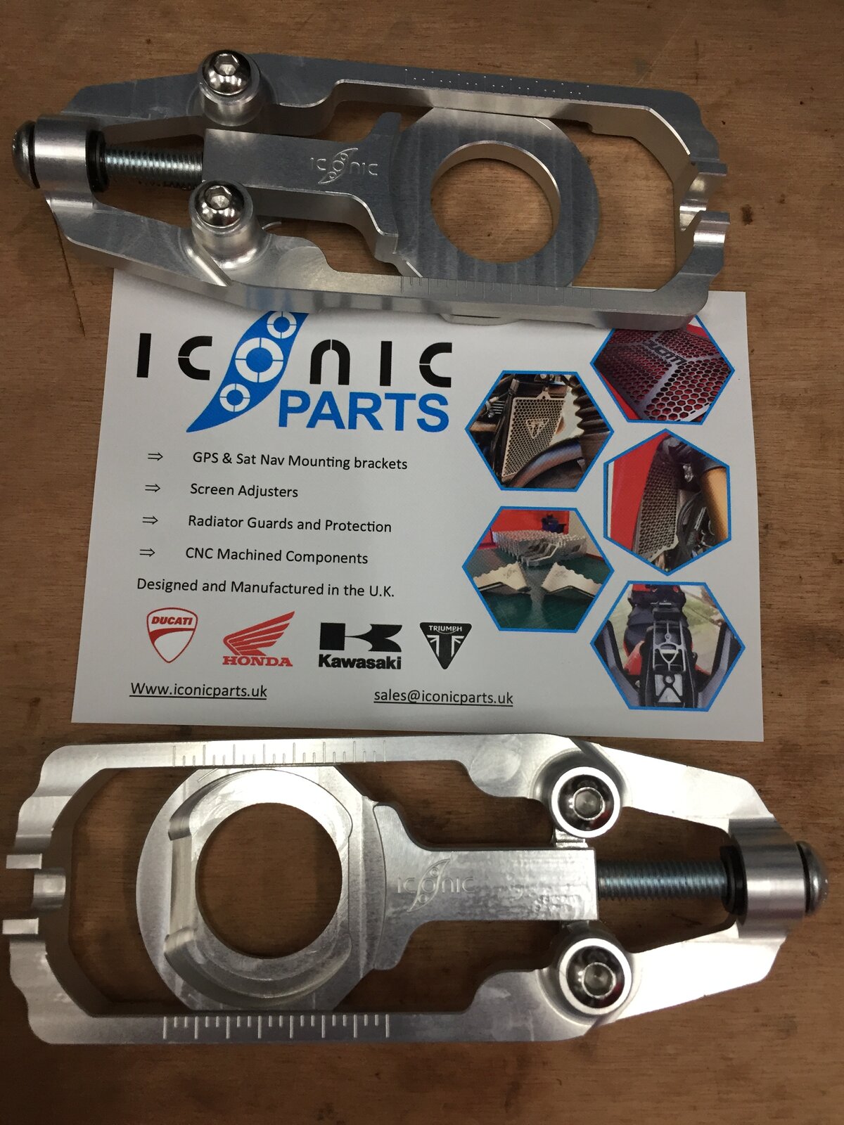

  1. Just for your attention...... 24 sets were shipped today. more to follow.

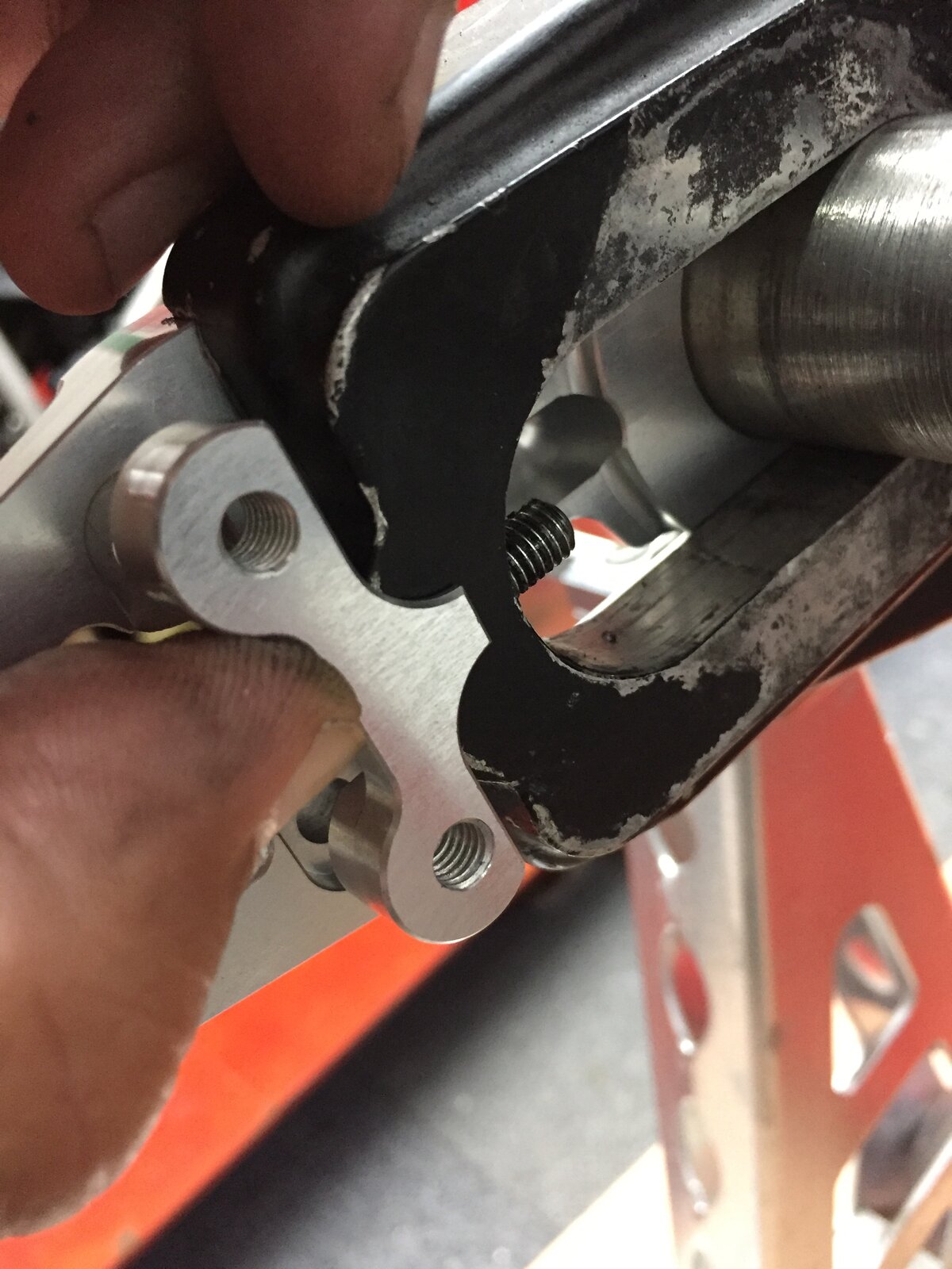

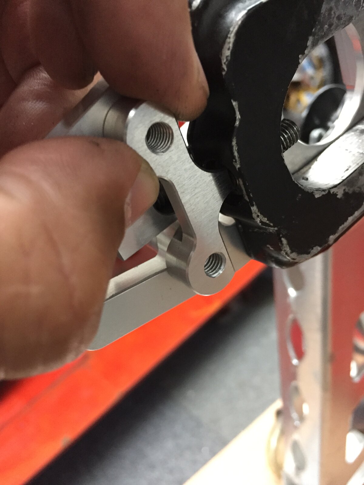

  11. Do the studs at the back of the swingarm need to come out to accommodate the rear clamp?
  12. I’m not sure on the intended as I just followed the Gilles design. I’d assume so.
  13. Or maybe they are supposed to go right to the far side.

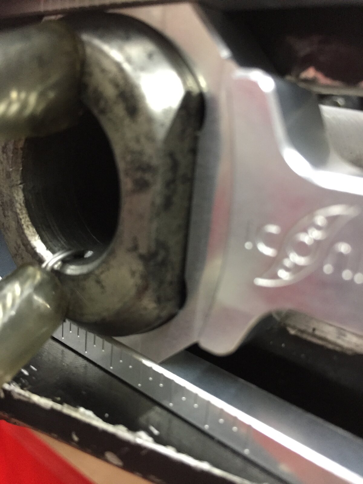

  14. Also, the spindle sits on the outer edge. I’m assuming it should sit inside?
  15. Like this?
  16. Possibly. Maybe someone has the instructions from the Gilles sets.
  17. I can’t see what your showing me
  18. This is as far as my spindle will go in so won’t sit flush pal!

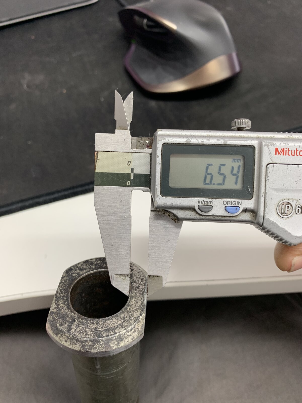

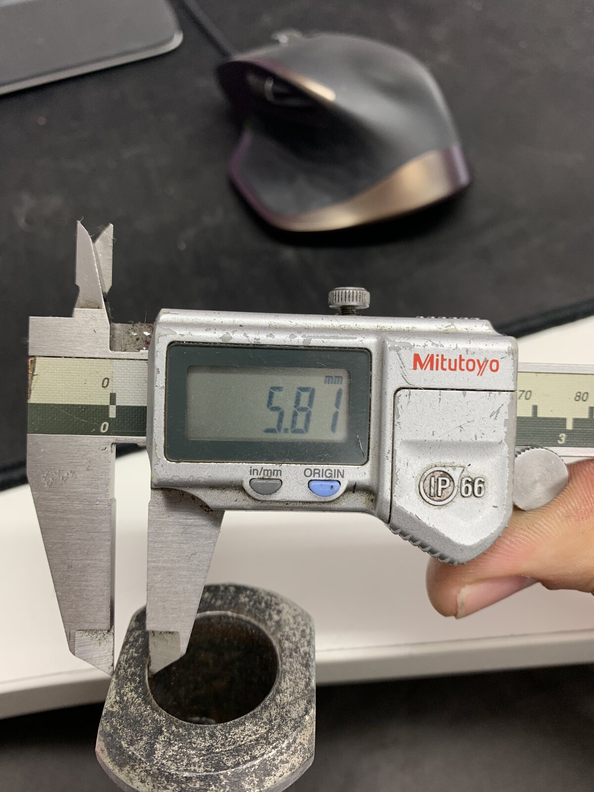

  20. Ok I’ve had a measure up of the pin that I have here and I have noticed on mine the flats are not machined Bob on centre to the spinal shaft.
    I popped out in the lathe and took a skim and you can see the head Is not concentric to the shaft and the flats are off to the centre line.
    Good old Ducati
