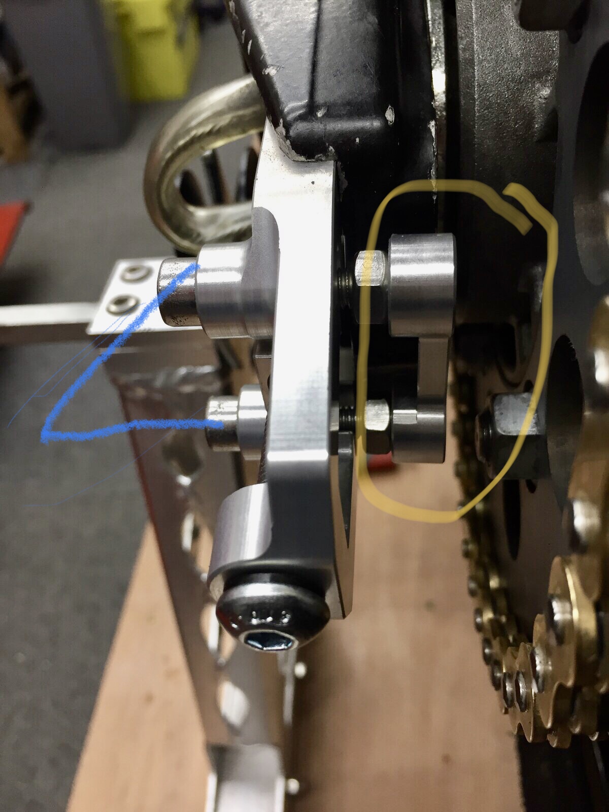

    So where did the two bolts on the left come from and what’s the thing on the right I have circled in yellow?
    I don’t have any of these parts
    I have one main assembly for each side and a bolt to fix each side to the swing arm.
    Are there meant to be more parts @Jamie Clare
    I thought all I would be doing was whipping the wheel and existing adjuster assembly off, fitting the new ones with the bolts towards the front of the swing arm, lining up the new adjusters to about the right position then remounting the wheel before final adjustment? Maybe with a little bit of filing ?
    Is that not correct?
  4. I don’t know about the bolts mate. Everyone has been debating the correct fitting for them. Read back through the thread to understand better.

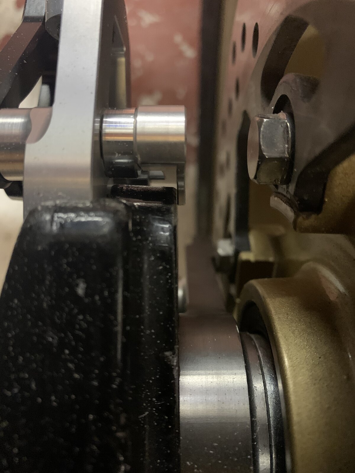

  5. hi Jamie

  7. I am wondering what the part is that I have circled in yellow
  8. These are extra parts I made. If you follow the thread back I offered these extra parts @ £15 extra as at the beginning everyone said it wasn’t needed. But later some water them so we did them as an option.
    Just read back through if you have any questions.
  9. Derek, they are little brackets that basically hold the back end of the adjusters flat against the swing arm.
    I think I will order up the additional parts As the axle fit is real snug on the captive side.
    really nicely made and so much easier to adjust the chain that the OEM set up
