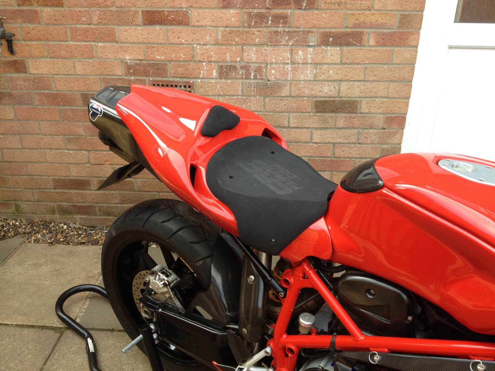

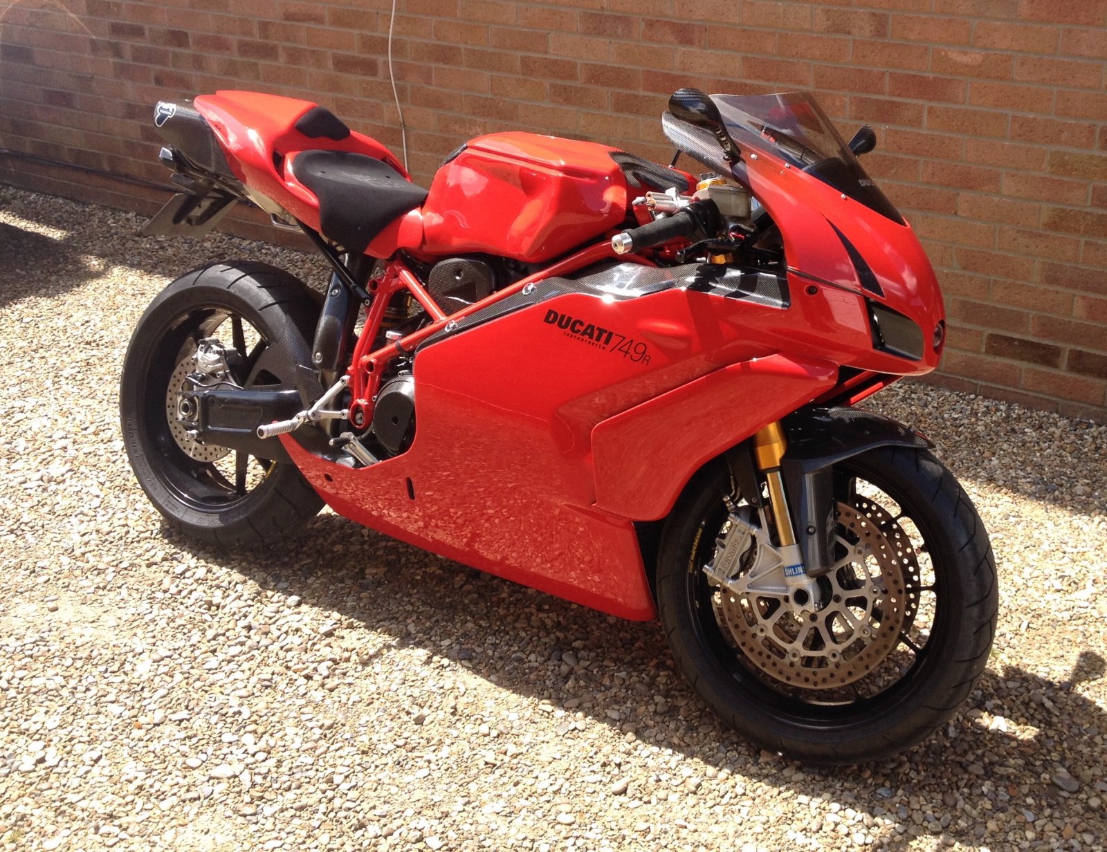

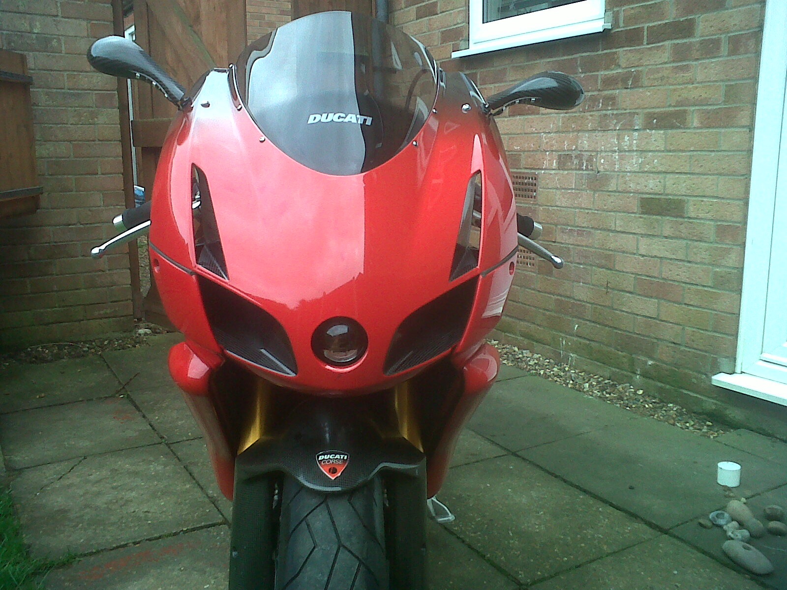

  10. This year's mod list :yum
    Chassis, brakes, controls:
    -unnumbered 999R race frame with removable brace bars in RS-style, no clips for electrical connectors, repainted
    -Öhlins FGRT 819 forks with billet bottoms and Ti bolts, blue decals replaced with black ones, 1098 spindle
    -Öhlins DU510 rear shock with hi/lo speed compression adjustment and a hydraulic preload adjuster, blue decal replaced with a black one
    -NCR billet ride height adjuster with Ti pinch bolts and adjuster section
    -Öhlins steering damper with Ti bolts, blue decals replaced with a single black one
    -Ducati Performance blue anodized steering damper bracket with Ti bolts
    -Speedymoto black billet top triple and clip-on brackets with Ti bolts
    -carbon fiber clip-ons with Ti bolts
    -Ti rear axle nut
    -Gilles Tooling chain adjusters
    -Brembo P4 30/34 billet front brake calipers with Ti bolts
    -999RS04 front brake hoses
    -999F06 Brembo 320x6mm narrowband full-floating rotors with 5mm spacers and Ti bolts
    -Discacciati four-piston billet rear brake caliper with Ti bolts
    -billet underslung rear caliper bracket
    -Discacciati 225mm narrowband rear brake rotor
    -HEL Performance carbon look rear brake hose with stainless steel banjo bolts
    -ABM Synto black clutch and brake levers
    -Oberon black billet master cylinder reservoir covers
    -Supersprox Stealth rear sprocket with Ti nuts
    -Supersprox front sprocket with Poggipolini Ti nut
    -RK GXW 520 gold X ring chain
    -Marchesini forged aluminium wheels, repainted and with fresh decals
    -Pirelli Diablo Rosso II 120/70 & 180/55
    -RCM Racing 999RS replica rearsets with Ti bolts
    -999RS carbon heel guards with Ti bolts
    -999R Xerox OEM black brake pedal with custom bolt
    Engine & electrics:
    -Akrapovic 749RS 57mm WSS full titanium/carbon exhaust with Ti mounting bolts
    -999F06 carbon oil breather tank with Ti bolts, custom made airbox connection
    -Pipercross filters
    -MS Production oversized carbon air runners
    -Ducati Performance ECU
    -Shorai 18Ah LiFePo battery with custom carbon cover plate
    -Digital Guard Dawg keyless go, ignition switch removed and blanked with a carbon plate
    -garage door RF remote integrated into right hand switch unit with a 12V/3V DC/DC converter
    -ExactStart additional starter and ground cables
    -wiring harnesses re-wrapped with Tesa 19mm fabric tape, all connectors treated with CRC contact protect
    -999F05 four-spring ramp type slipper clutch with Surflex aluminium plates
    -Oberon 29mm clutch slave cylinder with Ti bolts, upgraded rod with Ti pin
    -HEL Performance carbon look clutch hose
    -Samco silicone hose kit
    -749RS coolant union with Ti bolt
    -Ducati Performance magnesium valve covers
    -999RS04 sandcast and vented clutch casing with Ti bolts
    -stainless steel case saver with Ti bolts
    -most of the external bolts replaced with Ti
    Fairings & other stuff:
    -Beater Japan 999RS-style aluminium tank (22 litres) with aircraft style keyless cap, repainted
    -749R 2004 carbon side fairings and winglets, repainted in OEM-style with 999S texts
    -Ducati Performance carbon facelift front fairing, painted in OEM-style
    -RS-style tall windshield without parking light, Ti bolts
    -999RS carbon tail fairing, custom paint in OEM-style, custom aluminium rear mount
    -Ti Dzus fasteners
    -Radiantz LED tail light/indicator strip integrated on tail fairing
    -999RS carbon seat
    -749RS carbon seat/tank mount with Ti bolts
    -custom made carbon heat shield for silencer
    -Ducati Performance magnesium headlight bucket
    -Ducati Performance magnesium mirror stays
    -Ducati Performance 1098 carbon front fender with Ti bolts and a new Corse decal
    -Ducati Performance short carbon hugger with Ti bolts
    -Ducati Performance carbon mirror covers
    -Ducati Performance carbon oil cooler fairing with Ti bolts
    -Ducati Performance carbon belt covers with Ti bolts
    -999RS carbon belt cover for vertical head, with Ti bolts
    -999RS carbon clutch cover with Ti bolts
    -carbon seat pad cover
    -carbon swingarm covers
    -carbon rear brake m/c cover with Ti bolts
    -more Ti bolts (around 200 in total)
    -Motion Pro coolant catch tank
    -horn relocated under the headlights
    -black mesh on tail and front fairing vents
    (swingarm decals have been removed later)
